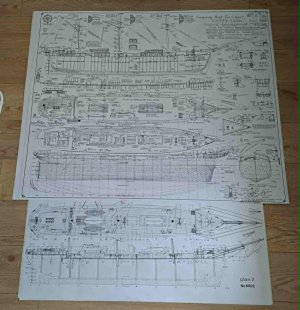

To help with the build and rigging I have bought a set of G.F. Campbell’s plans (General Layout, Rigging and Sail Plan) from the Royal Museums Greenwich. I also found Olha’s book review “Cutty Sark, The Ship and the Model/Longridge. C Nepean'' on her YouTube Channel < CS ref book > and I was able to locate a good used copy of the book in the UK. I do not intend to go the “whole hog” on the model by super-detailing it, my intention is to improve it to a level that I am happy with (whatever that is?).

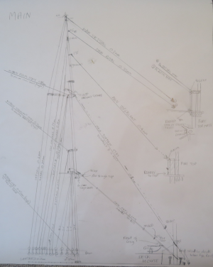

To make sense of things, I have resorted to DOM-CAD to sketch out the standing rigging for each mast - a piece of white wallpaper, a ruler, a pencil and a good old-fashioned rubber start to make things a lot clearer! The running rigging will be much harder as there are many, many errors that I have already spotted where the runs, sizes of ropes and types of blocks are not consistent (I will have to delve deep into my references).
DOM-CAD to the rescue!

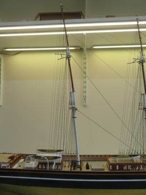

Fore Mast Standing Rigging complete

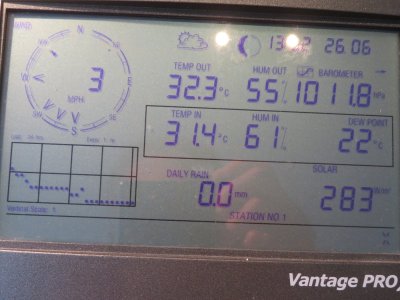

No more rigging for a while, I don't have the luxury of aircon, and this was the temperature in my hobby room this afternoon!
Hi Kevin,Excellent rigging Dom, I'm sure you'd be doing many of us a big favour by posting your Dom-CAD sketches here. I still haven't worked up quite enough enthusiasm to try rigging mine but I will for sure be going back through this log when I do.
I was running into that issue already when I parked it and have, more than once, considered restarting from scratch at a slightly larger scale, especially as the only part I’d used from the Revell kit was the hull. You’re doing a great job on yours so don’t lose heart!Hi Kevin,
when I've drawn out the plans for the other masts I'll take some sharper pictures and post them together if you think they will be useful. It's fiddly enough rigging at 1:75, let alone dropping down to 1:96! I think you will have to miss out some of the rigging, I don't know how you could even try to thread some of the eyes in the space available at a smaller scale. I had to walk away several times trying to tie off the jib and fore stays at the bow...... it was that bad!

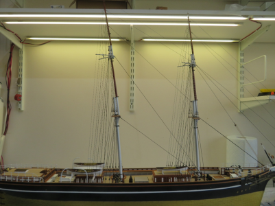

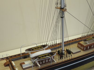

Well done, Dom. It’s looking great!Part 47 Rigging Part 4. Main Mast Standing Rigging.
The heat wave across the UK and Europe has been relentless and was too hot to work in my hobby room over the past couple of weeks. Fortunately, there has been a little bit of respite and temperatures have now started to return to something closer to normal for this time of year, so I have managed to resume work on the standing rigging.
First was to draw up a 1:1 rigging plan using DOM-CAD (I have also taken a better picture of the one I drew up for the Fore Mast and have replaced the one in Part 46 so that it is more useful as a reference for other builders).
Main Standing Rigging
Order of Rigging: The standing rigging on the Main Mast follows the same general plan as the Fore Mast and is pretty much a “rinse and repeat”, starting with the lower shrouds, followed by the back stays and then the fore stays. The biggest problem is the very tight access of the deadeyes in between the boat skids and capstans and positioning the halliard blocks for the Main Course and Lower Top Sail.
Arrangement of the Main Shrouds, Backstays and Halliards
The Lower Shrouds: the shrouds are set up in an identical fashion to the Fore Mast with 0.6 mm rope for the shrouds and 0.35mm for the lanyards .
Main and Cap “Pain-in-the-Back” Stays: There are seven pairs of Back Stays and a pair of Cap-Stays to deal with (suffice to say, they were very difficult to fit!). The Cap and Back Stays follow the same plan as on the Fore Mast with an additional pair of Stays for the Skysail. The rope sizing is identical except for the Skysail Backstay which uses a very thin wire, and for that I used 0.2mm rope (note: the labelling of the back stays on Campbell’s plans are dubious). The very tight access to the lower deadeyes made it impossible to use my jigs, so I had to use a different method. Taking the small boats off again may have given me a little bit more access, but it was marginal, and I would have then faced the problem of reinstalling them with the Stays in place - the lesser of two weevils? I tried using some thin copper wire to hold the deadeyes at the correct spacing, but that entailed so much faffing and bad language, that it was not a good solution. The best method was to apply some reverse logic and seize the ropes to the upper deadeyes first, lace them to the lower ones and then adjust the spacing with the lanyards keeping some light tension on the rope. This method was more fiddly and took longer compared to using the jigs, but job done in the end.

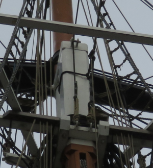

Main Stays: There are five Main Stays to fit. The Main Top Stay and Main Topmast Stays are double wires and are the same diameter as on the Fore Mast (0.6 and 0.5mm). The Main Top Stay is looped around the Main Top, passes through the gratings, and the wires are then seized together.
Arrangement of the Main Top Stay – note that the wires pass through the Top Gratings

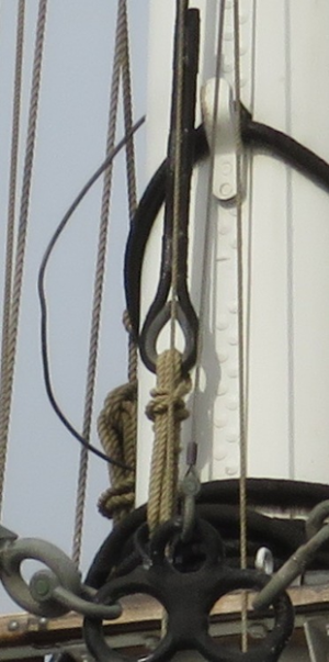

The Main Topmast Stay is looped around the Topmast and long eye seized. The Main and Main Topmast Stays are set up on lugs on the deck just in front of the Fore Fife Rail (so you need to carefully check the position so that the stays clear the underside of the Fife). For both stays, the wires separate and pass either side of the Fore Mast.
Note:- some plans and models have the Main Stay as a split wire coming from the Top, that is wrong, the wires were seized together. The reason why became obvious as I rigged!
Arrangement of the Main Top and Topmast Stays at the Fore Mast.
Well, that’s annoying! Because the Main Stay comes down just above the front of the forward deckhouse, it hits the bow of the Gig (that is why some plans show the wires were not seized together!). All of the plans show that the Gig was positioned along the centre line of the deckhouse, and the bow was level with the front, or just behind (Campbell, Longridge, Billing, others). Longridge’s solution was to move the Gig further back, so I also did the same, and I thought I had it right, but I found that the stay still hit the bow ( I was 2mm out!). I was pondering the issue, and it was only when I looked more closely at my photographs that I spotted why there was a problem - the Gig should be offset so that the stay clears! I was rather peeved when I saw that I had the picture of how it should be done and I had missed it! It was too late to try to move the Gig because everything was firmly fixed into position, and I would almost certainly have caused a lot of damage trying. The only solution was to move the seizing up so that the stay split just above the bow of the Gig. Good enough, but very annoying - so much for following plans! At least anyone building a Cutty Sark model will know what to do if they read this!
Arrangement of the Main Stay and the Gig – note the offset of the Gig to Starboard!
For the Main Topgallant stay I used 0.45mm rope, the stay attaches to the Fore Mast at the Fore Top, runs through a roller pulley and is set up on the back of the Trestle Top. For the Main Royal stay I used 0.35mm rope and for the Skysail stay, 0.2mm. The Main Royal and the Skysail stay come down to the back of the Fore Topmast, pass through some rollers and are set up on eyes at the back of the crosstrees.
Arrangement of the Main Topgallant Stay at the Fore Top
Arrangement of the Main Royal (SB) and Skysail (PT) Stays at the back of the Crosstrees.
Order of tensioning: Because the Main is so tall, it is it is very easy to pull the top over, especially when tensioning the upper fore and back stays. Once I had all the shrouds and stays at the correct length, I went through systematically to bring all the ropes into tension, starting at the lower shrouds and then tensioning each pair of back stays and then the opposing stays moving up to the Skysail.
Order:-
Main Lower Shrouds; Cap Stays; the first pair of Topmast Back Stays; Main Top Stay; the other two pairs of Topmast Back Stays and the two pairs of Topgallant Back Stays; Main Topmast Stay; Royal Back Stay; Main Topgallant Stay; Royal Back Stay; Main Royal Stay; Skysail Back Stay and finally the Main Skysail Stay.
Needless-to-say, the mast was checked at each stage.
Next up: Mizzen Mast standing rigging.
