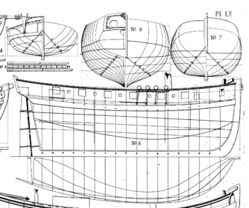

This is a copy of the drawing Ken used to design the build it has three angled lines above the keel, I think the top one or the middle one could be the waterline. What do you think?

I agree the top line is the waterline. The drawing is out of Chapman’s book on navel architecture and the book does not give any more details. I glued the frames in and the pointy end looks good to plank the other end not so much, maybe it will look better tomorrow. I guess we can make the planking look like this.Alert 33.jpg

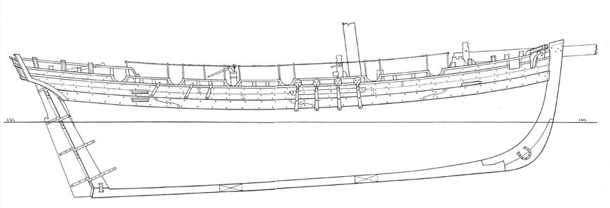

Mike: Is there any way you could have simulated caulking in the stem sternpost and keel structures for a little more visual interest?

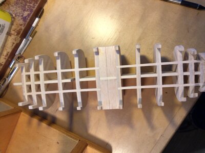

Mike: I'm concerned about how strong the hull is during the fairing process, given plywood bulkheads. Any problems? Should there be blocking between bulkheads, or a groove ploughed through the tops to stabilize them (like the photo below).

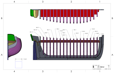

Hi Doc, Ken used a different method to stabilize the bulkheads for fairing. He used ¼” thick plywood spacers as shown the 3 View drawing (red rectangles in plan view), when I installed them it made the structure stable. The space between bulkheads is only ¾” so the planking should not be too lumpy. I am adding some balsa filler blocks at the bow and stern.English Cutter rev4_Page_1.png
