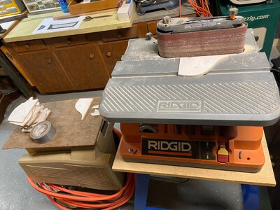

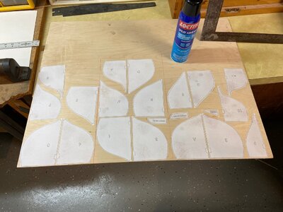

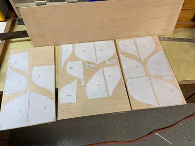

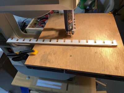

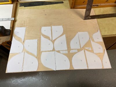

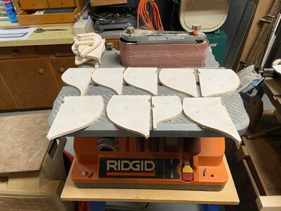

This will be my build log of the half hull model by Ken. I started with the bulkheads; they are made from Baltic Burch plywood. They were rough cut with the bandsaw and sanded with a belt sander and a small drum in my drill press. This is a few photos of the progress so far.

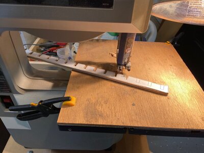

Thanks Don, all the notches are rough cut with the bandsaw, and I use hand files to fit the notch to the part inserted into it. The process does not take long with a good set of files.

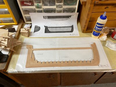

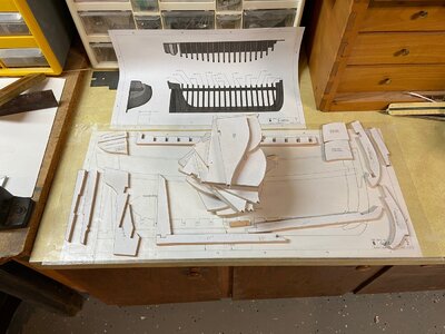

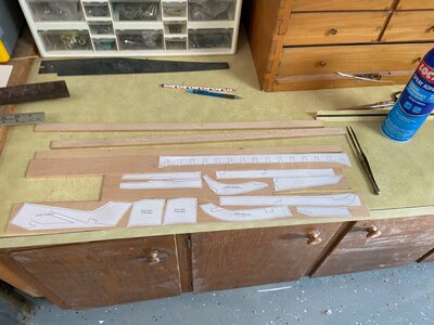

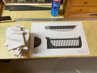

Don asks how I was cutting the notches and I replied by bandsaw, that is correct but the notches in the hog on the keel assembly drawing need some special care. The notches on the right hand need to be cut at an angle due to the length of the hog. I show this in the second and third photos. The first photo shows the keel assembly patterns attached and the last shows all the parts rough cut over the plan. The next step will be a lot of sanding and glue it together.
