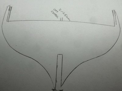

I drew outlines of all bulkheads. About 50% were right on. The remainder varied from just slightly off to about 2-2.5mm off center.
Here is an image of the worst bulkhead... What would be the recommended resolution fo fix this? Thank you for a response...
If the slot that fits into the center spine is off center than the top timbers are the least of your problem. The hull lines will be wrong too. The best solution would be to make a new bulkhead.
