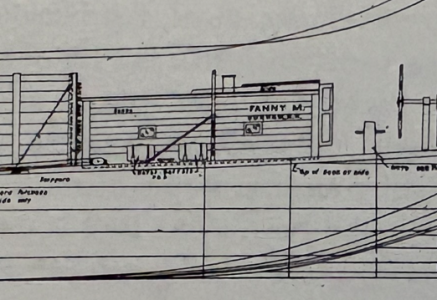

D. Foster Taylor measured the wreck, and in conjunction with an original builder's model created draughts for Fanny M which appear in the Historic American Merchant Marine Survey (HAMMS). While, I haven't seen the actual HAMMS drawings, there appears to be a reproduction of such in the Chapelle book National Watercraft Collection Plans:
It is from these plans that Grimwood redrew with slightly less detail and placed in his book. The plans in the book are drawn to 1:96 scale and Grimwood suggests building the model to the scale of 1:48. That is what will be done here.

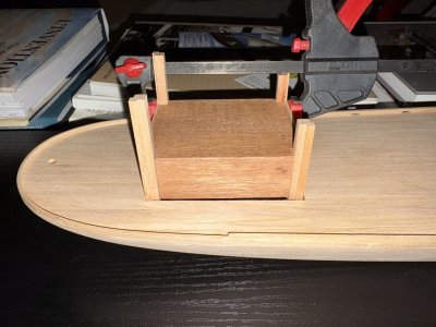

Four corner posts were made from 1/4" square stock. They were rebated to accept 1/16" planking material. Along the athwart sides a spaced board was attached. Notice that the planks on the front and back of the deckhouse are set horizontally; however the planks along the sides slant with the sheer of the deck. Thus, while spacers are straightforward to attach along the front and back, doing the same along the sides is more problematic.
To keep the four corner posts properly spaced and aligned a wood block sized to the interior of the posts was made. This allowed me to set all four posts vertically in the confines of the opening cut into the deck.

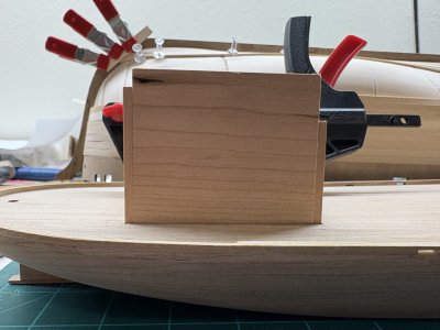

Pieces of 1/16" Cherry were cut to a trapezoidal shape that fit along the sides into the corner posts - with grain running (reasonably close to the deck sheer.
These pieces of wood were then sliced to produce the planks that would be used along the sides of the deckhouse.
Notice the pins - they were used to set the lowest plank along the deck sheer. I planked a bit higher than needed and then marked and cut the sides down to the correct height. The front and back were cut higher so that camber for the roof could be formed. Others may find it easier to plank to just the needed heights.

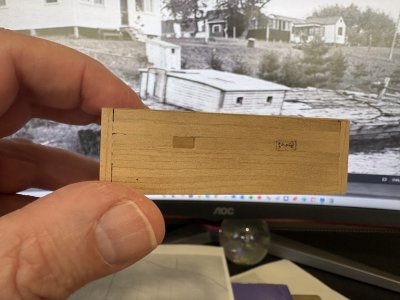

Once the sides were cut down and the roof camber sanded, it was time to deal with the lights / windows. It should be noted that the size and location of the windows are slightly different in the Grimwood plans as opposed to the HAMMS plans; the HAMMS locations / shape of the windows seem to be closer to the photographic evidence from the wreck of Fanny M. I have attempted to place the windows closer in height to the photographs, but I believe that mine may be not quite the same height. My windows are 1/4" wide and 1/8" high; they are placed so the 1/8" height matches with a planking strip, thereby making it easier to cut all the windows to the same height.
I marked the location of the windows on the deckhouse and then drilled several holes in their interior to help with material removal.
I used a mini-chisel to remove a good deal of the center material and then used a scalpel to trim out the rest of the material. In the past, I often used a small file for this type of work but now I find I can produce flatter edges and sharper corners with a bladed cutting tool.

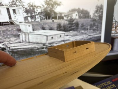

Sitting on the hull, the deckhouse is starting to look nice. Still to be added is the door / entry system, stove pipe, and a scuttle.
