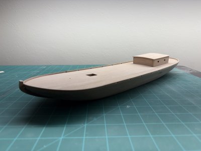

At this point, for all practical purposes, the hull is complete. In many ways, while 'plain' the lines of this hull are not disappointing - at least to me.

The first deck feature that I chose to work on was the deckhouse. Choices can be made on how this can be constructed with options based on it being made solid or framed. Either way, the deckhouse can be planked if so desired. I decided that I wanted the deckhouse to be planked and I wanted open the four lights along the sides of the deckhouse. I initially was undecided as to having the deckhouse door open and / or showing any interior detail. Having this indecision led me to framing the deckhouse, thereby leaving options.
Four corner posts were made from 1/4" square stock. They were rebated to accept 1/16" planking material. Along the athwart sides a spaced board was attached. Notice that the planks on the front and back of the deckhouse are set horizontally; however the planks along the sides slant with the sheer of the deck. Thus, while spacers are straightforward to attach along the front and back, doing the same along the sides is more problematic.
To keep the four corner posts properly spaced and aligned a wood block sized to the interior of the posts was made. This allowed me to set all four posts vertically in the confines of the opening cut into the deck.

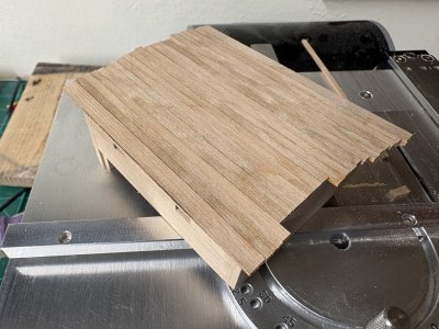

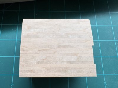

I had time today to mill the 1/16" Cherry, along with some 1/32" material that will be used soon. The 1/16" material for the deckhouse roof was ripped into planking strips 1/8" wide and a bit longer than needed. Before attaching any of the planks, I made note of where the deckhouse door was to be positioned. From the plans, the door together with molding was 3 feet - so 3/4" or 6 planks wide for the model. Starting at the middle of the deckhouse, 6 planks were attached with their edges flush to later accept the door structure. The other side of these planks went beyond what would be needed; i.e., no effort was made to have them have the correct overhang on the front side. This is another example of what Dave Stevens spoke about in his Sir Edward Hawke build - build big and then cut to size. The remaining roof planks were then added, each having excess overhang on both sides. I should also note that the outermost plank on each side is wider and will later be cut to the correct width / overhang.
Here is what the roof looked like at this point. Sanding / smoothing the roof came next. A nice thing about having the excess wood at this point is that when sanding the roof there is very little chance of rounding off material at the (final) edges due to sanding block rocking.

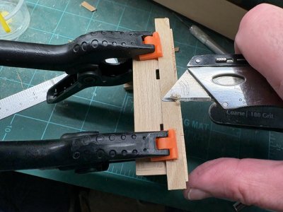

I chose to trim the side overhangs next. Some would say doing front and back first may be a better order of work in the event there is a (small) amount of breakout from working across the grain.
I wanted a 1/16" overhang on all four sides and used a strip of wood this thick for a trimming guide. Along the grain, the guide strip was clamped and the wood was trimmed with a sharp utility knife.

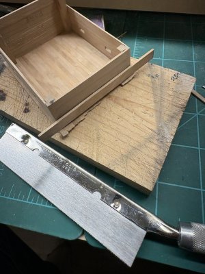

Across the grain a fine toothed hobby saw was used. Here I used tape to hold the guide strip to the deckhouse and then positioned the sawblade tight against it to get a straight cut.
The result:

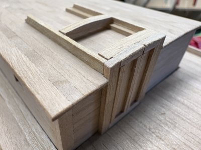

The door / entry to the deckhouse has gotten a little attention and should be finished soon. Here is a construction photo of how the work is being approached. The sliding roof guides are from 1/8" square material with a 1/16" square removed to make L shaped material. I removed the material with two cuts on a Byrnes saw using a fine slitting blade. Because these pieces are just 1 1/2" long, the inner material could be removed easily with a hobby saw; else, the L shape can be built from a piece of 1/8" x 1/16" strip and a 1/16" x 1/16" strip. I glued these in place to match the opening left when creating the deckhouse roof. Also, sitting across the guides are a couple of pieces of wood that have been contoured to parallel the deckhouse roof and serve as a foundation for the sliding roof.
Next the vertical door frames were added, as well as a lower ledge. Not easy to see, 1/32" 'door panels were added between the frames. 1/32" thick material is being used to model the panel framing within the doors themselves - the horizontal strips will come next.
