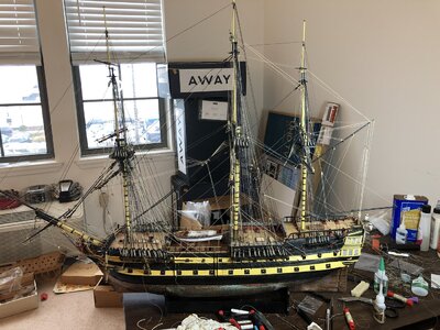

I am a few hours from finishing my Amati Vanguard,,, I am looking for some higher quality flags to put on her, the ones provided in kit are almost like cardboard (very stiff and flat) does anybody now of a place that makes nice cloth flags/pennants at the correct size?

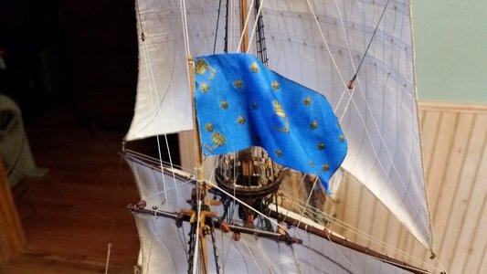

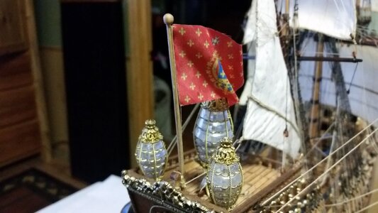

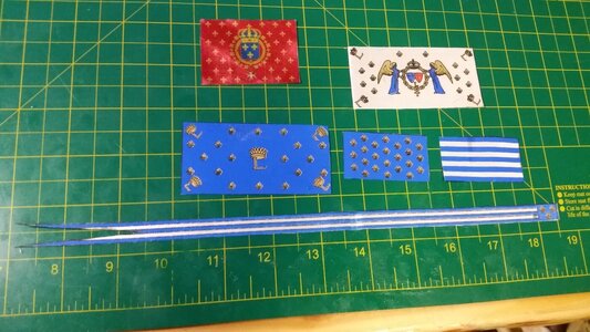

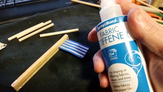

How stiff do they get? I’m trying to do it to a very long and sleek streamer flag.Spray-n-Bond fabric stiffener worked for me.
17th century French flags

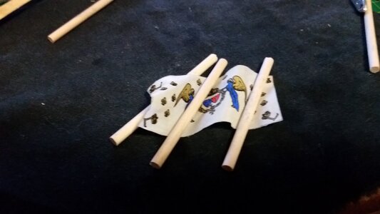

Clamp header of flag to keep it straight and wet entire flag with fabric stiffener
Form ripples using dowels while drying flag with hot air gun. Use pictures of real flags to learn the direction and depth of the folds, which are mostly diagonal. The weight of the fly end of the flag tends to cause it to fold over more deeply.
Final result:
The get about as stiff as paper. Fabric stiffener will not allow a long streamer to support itself for its entire length. For flags, which are short in length, appearing to be supported completely by wind is not a problem. It is a problem for streamers, however. In the example below, the stiffened streamer was glued to the running rigging in two spot to give the impression of being supported by the wind. The spots were carefully chosen so the weight of the streamer does not deflect the line, ruining the impression. The stiffened cloth was able to support the curves on its own, but because of the way it was attached to the mast, it could not appear to be flying by itself without other support.How stiff do they get? I’m trying to do it to a very long and sleek streamer flag.
