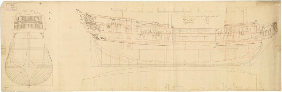

The plan is ZAZ0046
There are models of the ship

The plan
ZAZ4738

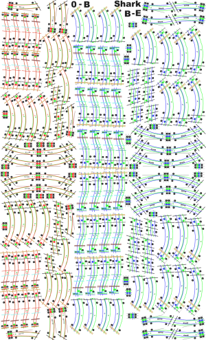

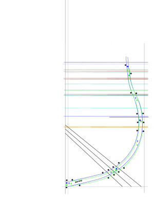

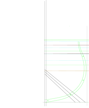

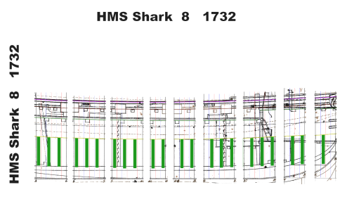

This is my midship framing plan and instructions and lofting steps
Shark Station frames  1.pngShark HT48 0.pngShark HF60 0-B.pngShark Timbers 0-B B-E.png

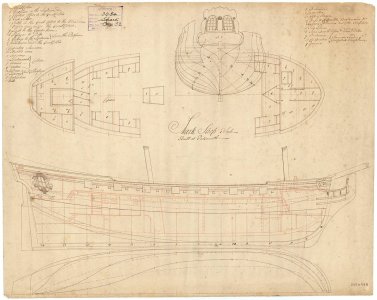

The plan
ZAZ1691

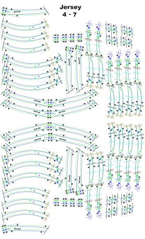

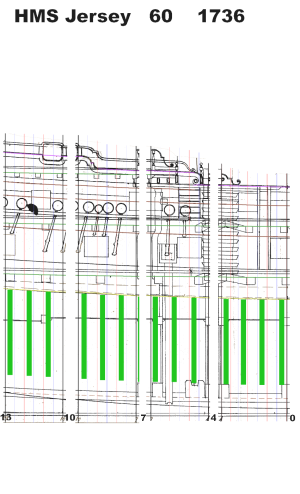

Jersey Station frames  3.pngJersey HF 48 4  .pngJersey HF 4-7 .pngJersey Timbers 4-7 ii .png
