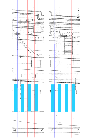

There are models of the ship
As an example of what can be done with the plan I will display what I did with it.
This is my midship framing plan and instructions.
The station frame shape
A midship station layer shape
A station layer shape where the bevel gets interesting
A page of timber patterns
The midship station frame shape

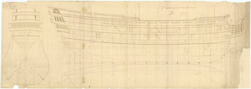

Humber 80 1726
O 23
L 26
152" 2" x 128' 5" x 44.5' x 18' 2" 1353 bm
Renamed Princess Amelia 1727
cutdown to 66 1747
BU 1752
Sister ship
Norfolk 1728
Lancaster 1722
Cornwall 1726
Princess Caroline 1731
Somerset 1731
Russell 1732
The plan ZAZ0735
Other plans
ZAZ0736
ZAZ0543
Models of the ship
None found

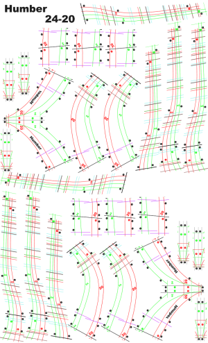

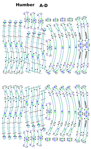

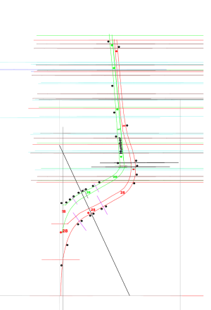

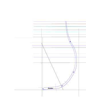

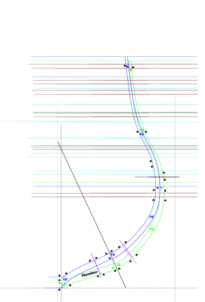

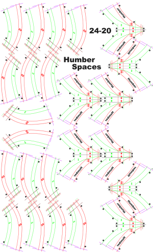

This is my midship framing plan and instructions and lofting steps
Humber frame profiles 12-8-4.pngHumber HF 48 4 .pngHumber hf 60  16-12.pngHumber hf 60  AP-28.pngHumber Timbers  A-D ii .pngHumber Timbers 24-20 iiii  .pngHumber Timbers spaces 24-20   .png
