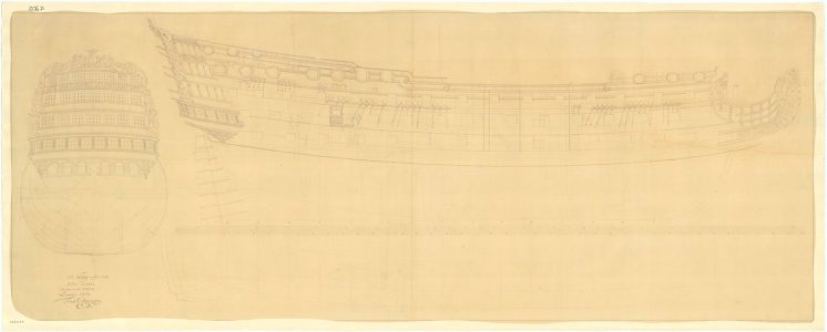

The plan is ZAZ0046

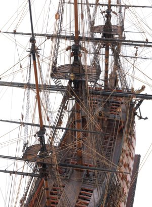

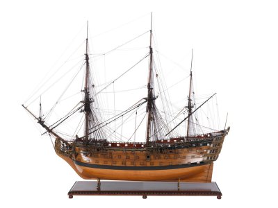

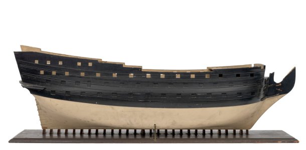

There are models of the ship

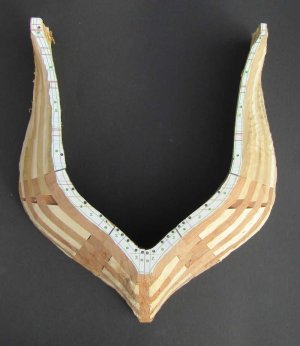

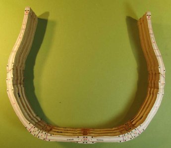

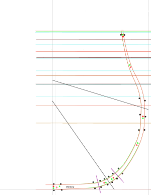

As an example of what can be done with the plan I will display what I did with it.
This is my midship framing plan and instructions.

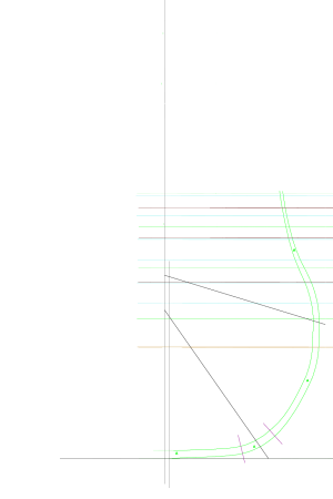

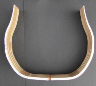

The station frame shape
A midship station layer shape
A station layer shape where the bevel gets interesting

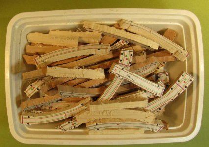

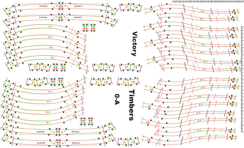

A page of timber patterns

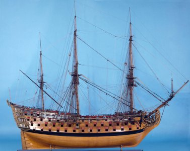

Models of the ship
The midship station frame shape

This is my midship framing plan and instructions and lofting steps
Prince george profiles frames 5-2-1-0.pngPrince George HF 48 A .pngPrince George HF 26-23.pngPrince George Timbers L-O ii .png

Stations 6" / 4'
R&S 24"
Floors 12"
Shark Station frames  1.pngShark HT48 0.pngShark HF60 0-B.pngShark Timbers 0-B B-E.png

Stations 8,6,4
R&S
Floors 16"x16"
Jersey Station frames  3.pngJersey HF 48 4  .pngJersey HF 4-7 .pngJersey Timbers 4-7 ii .png

The plan
ZAZ0145
Other plans
ZAZ7847
Models of the ship
A 1:34.3 model was made for the Royal Naval Academy model was made for the Royal Naval Academy
This large model was japanned and varnished. This involves uing a crude oil extract: bitumen/asphaltum mixed with linseed oil.
If it has not dried in 200 million years, it will not be a hard surface on a mosel without help.
The model was commissioned in 1740. Any supposition that it was involved in the inquiry of Victory's loss is nonsense.
Stations
R&S 31"
Floors 16"
unique feature 4 decks of lights with 3 full galleries

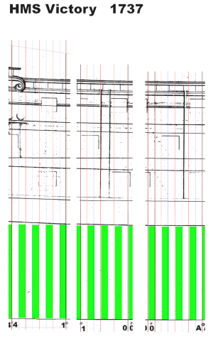

Victory frames 4-A.pngVictory HF 48 A .pngVictory HF 0-A.pngVictory 0-A timbers ii .png48 fresh timbers.jpg0-1 rough station 3.JPG0-A.JPGZ-U rough.JPG
