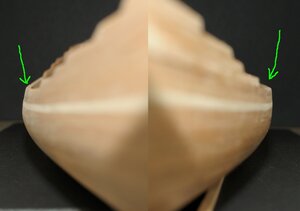

Hello Gilles, Forgive me if I missed it somewhere between the lines, do we have to darken the plank edges to simulate caulking (if any at all)? I can see from the above picture planks are represented as an individual, Is that a glue effect?
The planking strips being oversize is adding some work.
3/32 x 3/32 was originally chosen so that after sanding inside and out the planking is about 1/16" thick throughout.
The most sanding normally occurs on the outside of the canoe, which will again be the case using the lumber (cherry) received. But in order to end up with an appropriate thickness, at least at the sheer, a lot of material needs to be sanded off.
Here is an illustration:
The right side of the photo shows the sheer after fairing.
The left side shows the sheer and the thickness after sanding: the thickness of that strip ends up being about 1/16" (this strip will only be very lightly sanded on the inside.
Sanding the outside is much easier than the inside, so as a result the sheer will show a slight curve towards the inside.
G.
PS: I should mention that the dimension of the 3/32" strips was a choice made following test-builds using 1/16" (too thin) and 1/8" (to thick).
Too thin is a problem as one must be very careful during the sanding process. This size is perfect by offering optimal size to lay the strip down onto the mold keeping the edges square: furthermore, easy to bend and twist.
Too thick is more problematic as the strips located in the curve towards the bottom of the hull now need to be beveled to avoid a wider gap between the outside edges of strips: thus, requiring a lot more sanding to reduce thickness (at least at the sheer): furthermore, stiffer so bending and twisting more difficult.
G.
G.
G.

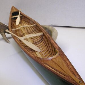

Will this push you over the edge?
G
YES! See how easy that was in a vulnerable moment. Please send me a direct link to place an order from the options as I am not on facebook but will ask my Homefront commander to get me hooked up. PT-2
