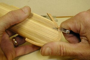

Do you have some pictures of the laminating process ?
With the reference to support #4, and in your manual, the part is fixed in place. Shaping and grinding is then a matter of course.
Since I haven't worked much with wood yet, my question is: how do you keep the bent wood on-site ?
Should I first fix the part in a template (for example a curved row of nails) ?
That's how I saw it with bentwood projects.
Or is it enough to fix the strips one by one with super glue and "hand-hold"

"It is enough to fix the strips one by one with super glue and "hand-hold"
The strips are soaked in hot water for a few minutes, then bent directly on the canoe. I use "super glue" for this as well as for the installation of the rib.
You can just take your strip out of the water, wipe it down so that it is not dripping water, do a test fit on the canoe. once you know it bends well, apply a small amount of glue on the strip and put in place. Hold for a minute or so with your fingers. please make sure the surface on the stem is smooth for good contact with the strip.
Place a strip on one end of the canoe. Then move to the other end while the glue dries and so on.
You will probably need to laminate 5 strips on each side.

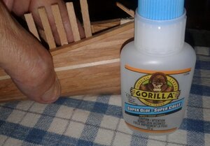

Here is the glue I use for the outer stems and for the ribs

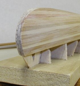

Here is what the surface looks like before laminating the strips.

Hello Gilles. Is there a reason for lamination? Is this by canoe design in general, or simply the method for easy bending process?
Most wood strip canoes have a single strip about 3/4" bent to the curve, This strip is usually hard wood, well harder that the planking as it is used for protection against damage. The installation of such an "extension" of the planking requires tapering the ends of the planking strips to rest against the stem mold so that the extremities of the canoe can accommodate it.
In the model, I did chose to do laminated ends to avoid tapering the planking strips. This way, it is easier to bring down the width at the front and back. Once laminated, the ends are tapered to follow the canoe lines. This is something I started to do when I marketed the canoe as a kit since it made the construction much easier. It also allows the builder to make corrections, should the ends of the canoe not be perfectly vertical as it sometimes happens: the extra width at the extremities of the planking gives more room to work towards that.
The thicker the end of the planking is the stems, the larger the basic protective strip must be to allow working the final taper or bevel: bending a 1/16 x 1/16" or 3/32 x 3/32" around the stem pieces on the model would be to difficult, even bending it around a separate mold as shape of the mold and the actual stems on the model would have to be as precise as can be.
Hope it makes sense.

With other glues I frequently add my fingers to the build. I"ll have to try the Gorilla Super Glue. My regular CA is bSi Bob Smith Industries INsta-Cure which gives me a 12-15 second working time and I use toothpicks to apply a dab where I want it.
