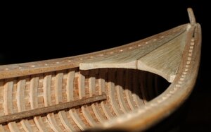

Working on decks. Apart from a few details to take care of, one end of the canoe is basically done so here are some close-up views:
G
Your bow and stern decks caught my eye. One looks flat and the other is scalloped over a center member like draped canvas. Maybe just the difference in the view. Please share more of your creativity on these for this great looking canoe. PT-2
Good morning,
Both are the same shape: it is just the viewing angle.
Here is the detail before the end strip is installed.
I may even end up shaping that strip to follow the shape of the upper face of the deck: not sure yet.

As for details about the construction of the decks, see this:
where you can find out about the process, which is much more detailed than in the guide.
The "group build" is designed to motivate builders to be creative with their own project and make their craft as unique as they want.
Since I am building at least 2 canoes within the scope of this project, the subsequent canoes will be different.

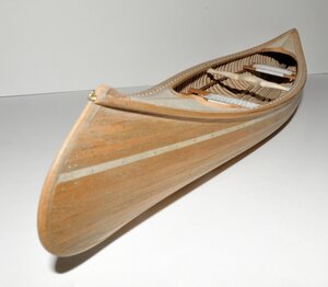

Here is a view showing the overall shape of the canoe.
Still need to take care of of a few things such as the seats, which are not permanently installed here as I may redo them, the yoke, paddles and a few finishing details.
G.

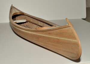

19-inch canoe as of today: almost completed!
Some viewers may wonder about varnish .... Well, contrary to my usual practice, this piece will not see the application of any finish at this point.
A few small details to add, a bit of cleanup in some areas and of course, paddles need to be made to complete the model.

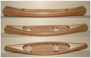

Well, since I will be making this size and the other (using different woods), here is the image with them both: for size comparison.
Sorry, the building bases don't look as nice as the you guys!

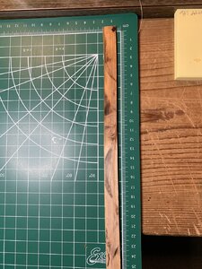

Watco on Cherry.jpgA sample try on a recently self cut and milled piece of Sherofujin Cherry from my yard, cut last month which shows with the initial application on the darker half, the initial penetration color change. It will probably get somewhat darker with more coats between drying times. IT is penetration oil and resin, not a surface finish or coating. They say it may be used on walnut, teak, cherry, birch, oak, mahogany, cedar, pine and similar woods. I think it would be a good "natural" finish to one of the canoe builds and perhaps on other admiralty ones. PT-2

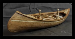

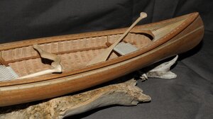

This canoes is now ready for display.
In the end, I did apply full varnish treatment:
- a total of 9 coats were applied on the outside. two primary / base coats, then very light sanding with 600 grit paper between coat 3 to 8. No sanding applied between 8 and 9 but a wipe with a clean cloth. Once coat 9 was dry / cured for 48 hours, the surface was very lightly "polished" with 1500 grit paper: this is basically like wiping the surface using the paper as you cannot really tell but it gets rid of impurities in the top surface.
- 1 coat inside and seat frames.
- 4 coats on decks, sheer (including inner gunwale) and yoke.
Another skillful and beautiful build. The wood character comes out well with your finishing process which demand as much care at the setting of the nails. PT-2
