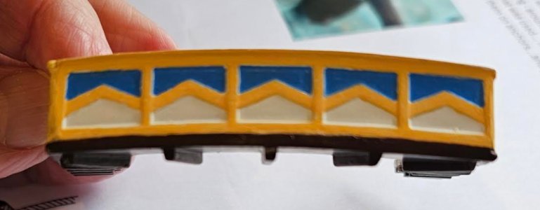

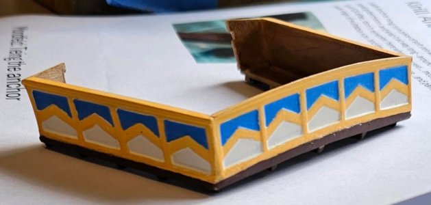

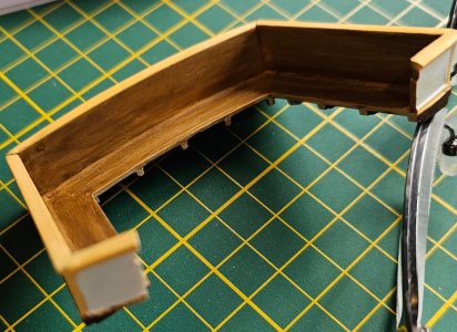

I had a lot of trouble getting the gallery to fit!
Each edge is bevelled and even an octopus wouold have trouble holding the 6 pieces on the ship so that a test fit can be done. I tried using liquitape but with limited success. Anyway, I eventually got it looking OK and then adjusted the last two pieces to fit. Then there were some gaps because the floor is flat and the gallery is actually curved. So it was CA glue as filler, sanding to fit, painting, checking, adding some more glue, sanding to level railings, repaint...ugh. Then I had to add wood effects on the inside as well. It basically took me a week. But I think it is acceptable now.

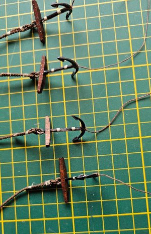

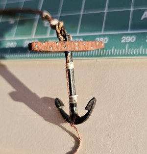

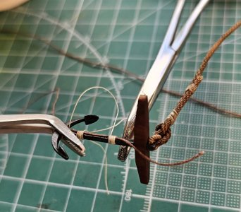

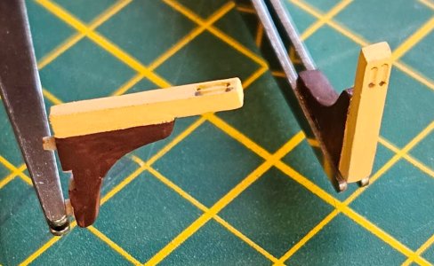

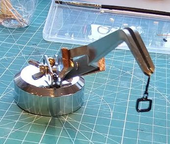

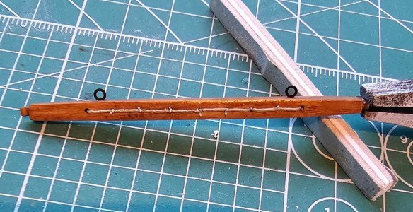

Work on the anchors progresses.
Bolts being added using Pro Acryl Dark Silver thick contour paint (thanks for the tip, Kirill!)

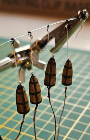

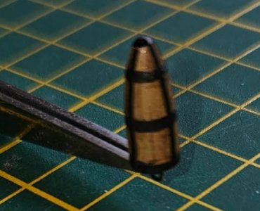

Also working on the anchor buoys... Currently being painted. More soon.

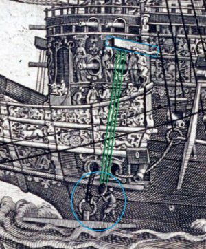

Once it breaks the surface a hook is attached to the anchor ring. The hook is on the cat block and the cat head is used to raise the anchor out of the water, and up to the cat head. So far so good. There is a famous picture of this happening in the Sovereign of the Seas:

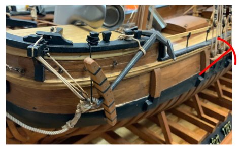

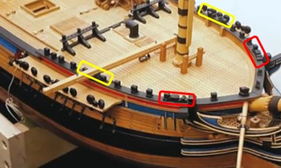

Here is a still showing how this works. Note that in this ship there is a single davit which is moved from side to side, according to which anchor is being worked. There are two spanshackles on the deck, slightly to either side fo the centre line. Each is used to hold the davit in place when it is working on the anchor on the opposite side to the spanshackle. eg this is how to raise the anchor into the yellow position, on the channel.

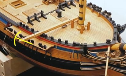

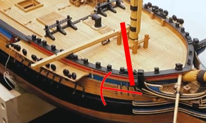

But there is also an anchor forward of the channels - and this is the one used mostly if I have understood correctly. I have drawn that one in red. The davit in the picture above is in a good position for storing an anchor on the channel but not for storing an anchor forward of the channel. eg the red anchor. That seems to require a davit inthe position as shown in red?
Indeed I notice that the davit has a support on the side rails...and indeed there are four! And they are in about the postions required according to my diagrams
So in short it seems to me that we need two davits on each side?
When there was one movable davit, that is fine. But later ships had one davit fixed in postion, but it extended over both sides of the ship. Still, it is locked in ONE position...
I was told by a real sailing ship master: "The davits can be moved and tackles rigged from under the tops through runner pendants." So that seems to support moving the davits when you want to access the four different anchors.
If true, the the angle of the spanshackles needs to change as the davit moves from the position for the yellow anchor to the postion for the red anchor.
Do the spanshackles rotate?
Any explanation will be greatly appreciated!

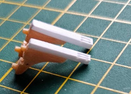

There are only two davit supports. The ones marked in red are cathead-stopper blocks, used to fix the anchor when it is pulled to the cathead. You will make them unusable or break, if you put a davit on them. Take a look at this thread for details: https://shipsofscale.com/sosforums/threads/help-with-rigging-anchor-on-18th-century-yacht.11100/
And in this video there is only one davit, being put to starboard or to port side depending on which side the anchor is being taken to the fish. Because as it was mentioned before, you can operate only one anchor at a time, using the capstain and the crew. If you have two, you will need to do the job on one side, then on another.

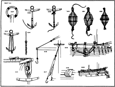

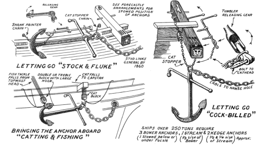

And honestly I think on such old & small ships like GH they used an approach without the davit at all, like on this drawing from Markvardt, pic 1017 (1018 is for a davit), for smaller ships it was used even in XVIII century:

Many thanks boatman! I was not sure what a stopper was but I think I get it now.

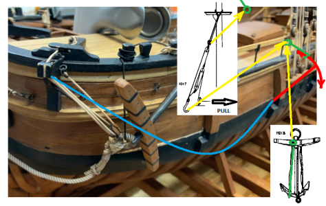

I still don't understand how the cathead and davit can be used to get the second anchor stowed on the channel...how is it moved laterally along the side of the ship? I can see how it gets the main anchor up and down, but the one on the channel (in red below) is some distance away...

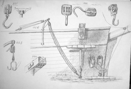

My point is that you don't need a davit at all on such a small ship with its tiny anchors. Maybe this drawing will explain how I see this (I could be completely wrong, of course): you pull the anchor to the cathead vertically then attach a second rope to position it horizontally:
This was much later, in XIX century, from Campbell's Tea Clippers, but the idea of "catting & fishing" is quite the same:

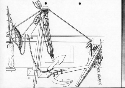

This one is also from the middle of XIX century shows using a cat davit (442) instead of the mast tackle:
But again, on "Golden Hind" in the XVI century, it all seems a bit weird.
Many many thanks Boatman. I think that explains what I was told (by a real Master of a real square rigged ship): "The davits can be moved and tackles rigged from under the tops through runner pendants." That is shown in your first picture. I get it now. Certainyl easy for the GH period with smallanchors.
But how was this done with BIG anchors in later ships?
The second and third pictures are for bigger and later ships ;) for the navy ships of the XIX century and 3-5 masted square riggers.The video you mentioned above is also a good example. On the third picture you can see the usage of a davit, attached to the hull (near number 442). From what I know the davit was used to avoid damage while moving the anchor and to pull it to the right place, designed for holding it and avoiding damage to the board while sailing, e.g. 1019 here above
