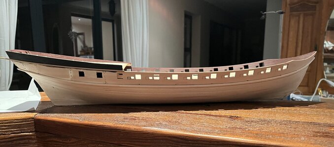

Good morning. Haven’t had much time to play recently. I got tired of sanding so ricochet rabbit Grant decided to make a wale and veneer the stern bulkwarks.
I beveled a line into the wale to give it some shape. The plain 3mm kit wale did not do it for me. I also let the wale naturally follow the hull and bulkwark curve. I like it. :D
I cut some left over walnut planks from the Victory and added a 1.5mm strip which will follow the railing line.
As I understand wales : Many call them rubbing strakes but this was not their purpose in the 18th century. They were fitted on the widest part of the hull for strength, structural support and many other reasons. Not going to bore you guys here. I am only putting one main wale on my Xebec hull and a smaller support one running beneath the gun ports. It would make sense to have one where all the gun ports are to include structural support.

well done Grant. Your wales at the bow area are going a bit steep upwards? Is this on purpose? I like the single wale instead of two. The limewood strips arn't that great. If I had to do it again, I changed them into walnut strips.

Good morning Peter. I just let them follow the shape of my hull. In my plan they where not so accentuated at the bow and thought of changing them, however I rather enjoy it. It also works really nice for my planking below the wales. Lime wood :mad:. I really dislike it. I am going to paint the wales black so should be ok. Thanks. Cheers Grant

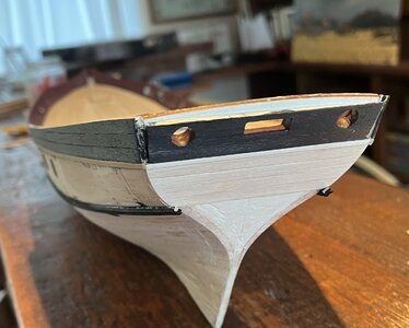

Good afternoon. I still cannot motivate myself to sand and ploy fill moreSleepSleep….so worked on my transom.
WIP:

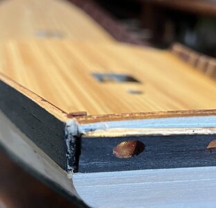

Planked with veneer, painted black. I planked the first 4 planks below the transom in Lime upto the wales. The bulwarks and gun ports I intend to leave natural lime ( I know not the best but will try make this work), so the patterns flow.
I am a little concerned as I lay the Lime horizontally up to the wale and I’m not sure if this fits the time period? I can’t find any info pertaining to Xebecs on this but all the models I have seen show “diagonal vertical” or the hull strakes bending up onto the stern?
I have made a cut out for the extended grid deck hanging off the stern on Xebecs to fit. I will use nails and a frame for strength. Hope it works.

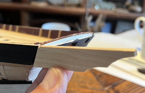

My own design for the extension to the bulkwark. A K.I.S.S. design. I will only fit this much later.
