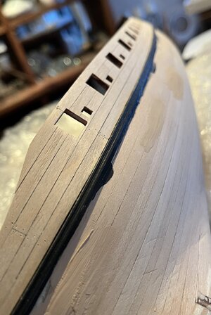

Good morning.

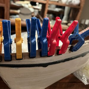

Planking of hull above the wale:
Lime Veneer does not give much plank definition so did some Grant creation.
Hull of ships do have caulking/sealing between each plank. It is not often used on models as due to scale it would not be very visible. Plank lines are evident tho.
To get plank definition with this Lime veneer I ran a very light pencil “caulking” (not as evident as my decks).
Bow and midships I used clamps while at the stern CA glue had to used.
WIP :
Gun ports cut(not completed) and treenail holes (0.4mm) drilled . Planks at stern above the gun port rail (still to be added) are tappered. Bow all planks tappered.

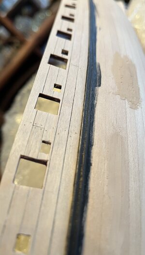

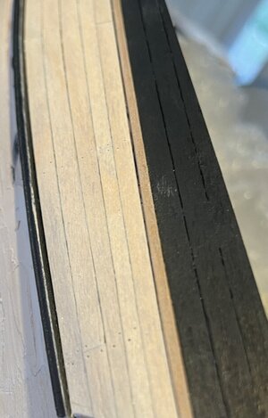

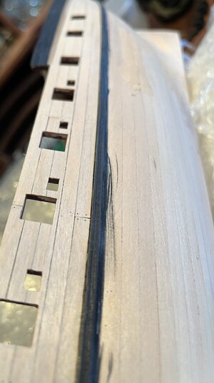

So far….here is what is happening:
24F6EF26-B677-4001-B409-07A117E8B8BB.jpegFFDABD07-3E0B-4529-8293-5521A7D0AA5B.jpegE6018B31-F100-4BEB-81E8-592AD9A720F2.jpeg8C9231FB-D79A-4F63-85AA-1534A8586F7D.jpegF6AC5471-DDCB-43AD-9049-D531F87F8386.jpeg
Cheers Grant

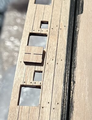

Grant, mate. Hello. There shouldn't be such "shorts" between the gun ports. Make it whole. board in this placeView attachment 363191
Good morning Sasha. I forgot about that.Redface.
I did know this and just went for itROTF and got it wrong. Oh well I’m not sure I’m going to make this a redo task. This Xebec is so way off historically thus far I’m not sure these shorts will do much to change it. Thanks for pointing this out for me . Cheers Grant

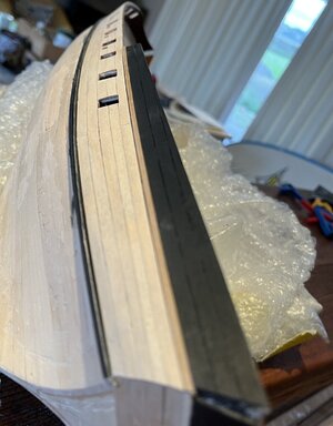

Good morning.
WIP :
View attachment 363188View attachment 363187View attachment 363186View attachment 363184View attachment 363185
Cheers Grant
What a nice touch adding the caulking Grant, I like the tree nails as well. Bravo!!
Finally, I have a moment to check up on my pirate ship. When it comes to the extension of the aft section, I am sure that a couple of well-drilled holes, toothpicks and wood epoxy will do the trick.
Good morning Heinrich. I’m living on a hope a prayer here. I never thought about wood epoxy? Is that a stronger bond than wood glue as I’m looking for anything to add strength to that structure when I get there?

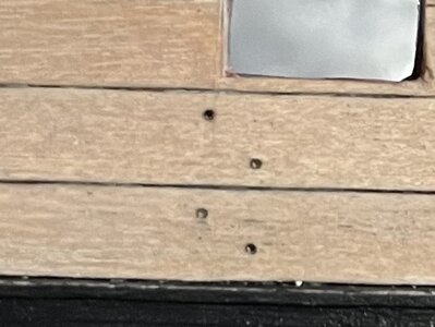

First class work here Grant. The planking looks fantastic. Will you just leave the treenails as drilled holes? Not sure what your plan is but I find these very convincing.
Good morning Paul. Thank you kindly:D. I did a couple of tests. The big issue was lime veneer. Too soft,chips and marks easily . Toothpicks did not work me,wood filler stained the surrounding veneer, filling the hole with polyurethane made them hardly noticeable. I lighty (very lighty) penciled each hole with HB and then filled with polyurethane.
Here is the result:
Cheers Grant
