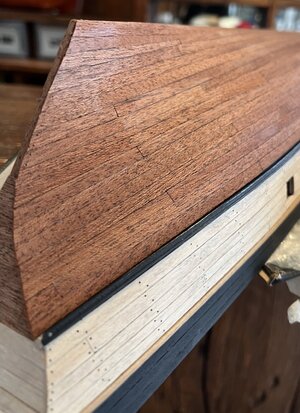

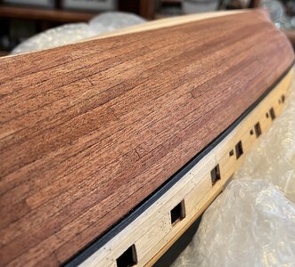

Good morning. Planking on Port side continuing. I decided to do the entire port side as this will be the non display side. Learn from my mistakes. Many blunders were made:
Planking:

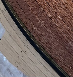

Tree nailing the hull….o_O: Used wood filler on Sapele. It is a little light in pics but once second layer of poly is on it looks pretty good….if my test samples remain the same!
I first applied a thin layer of Matt poly. This is to stop the wood filler seeping into the wood grain. Dry, then lightly sand with 1000 grit. This does scratch the poly but will not be noticeable once the second coat is applied.

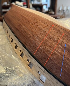

Blunders:
Red arrow :
I made the treenails perpendicular to the waleSick. These should follow the frame lines (well bulkheads in my case). I can’t change these now but to be honest I don’t even notice it.
Blue arrow: if you going to treenail your hull make sure the butt joints are in line …..ROTF

Grant, she looks great!
Apart from the "blunders" (yeah right), I think your trennels in the lower part of the hull are spot on, they are there, but not obtrusively so.
