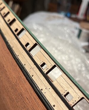

Some more of the same. The railing support, the small wale under the gun ports and treenails (not complete) done on the portside.
Of course I scratch the paint on the main wale but that is expected from Grant. Plenty clean up to be done.

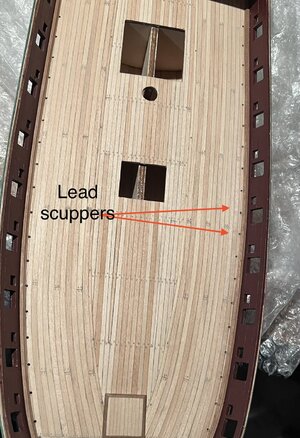

Good afternoon. Ricochet rabbit - nickname curtesy of Paul ( @dockattner ) , at it again.

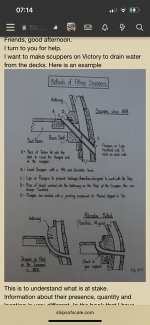

In a previous post I showed the triangle scuppers on the out side of the hull. Diagram :
I “stole” this from Sasha’s incredible Victory log (@Alexander74 ). Side note : this probably the best Victory I have seen being built and as I built one it is of particular interest.
One can see for each scupper a lead scupper has to be on the deck by the waterway. At my scale I could not get all the detail so a Simple hole was drilled into the deck keeping symmetry with the scupper hull holes.

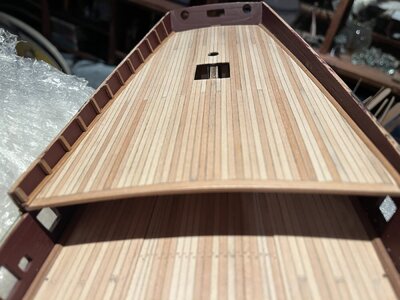

I also jumped around again and added some bulkwark supports to my lower bulwarks ( so many to make on this xebec) on the poop deck .

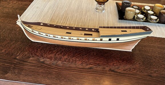

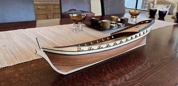

Finally I some overall pics of progress thus far. I do think the “treenails” on the lower hull below the wale was a waste of effort as they can hardly be seen. (Only on portside- I’m not sure I will do these on the starboard side - a lot of effort for naught)
Still not sexy Paul but getting there ;) .
A load of fettling and clean up and some poly to do so I think she will be good.
