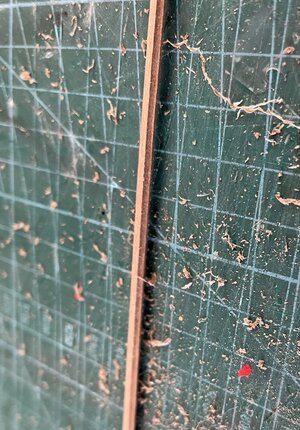

Grant, I don't know what the red arrow is pointing at other than a really beautiful, well-constructed hull my friend!
Good afternoon Daniel. Thank you. The arrow just shows another chip I had to repair. The good thing about veneer is you repair fairly easily.

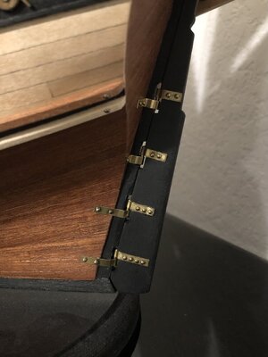

Great progress Grant and it looks perfect. However the kit is wrong with the rudderpost. These gaps shouldn't be in there only on the rudder. I made the same mistake, corrected it later during my build. I had some trouble to fit the hinges correctly, that's when I found out the mistake. If you can correct it at this point during the build would help you later on.

Hello Peter. I had a look and I see what you are referring to. Some solace for you and I is that it is not our mistake but a kit error. I have no African Walnut and am hesitant to remove this. I will see what I can do when I come to place the rudder. Thanks you for the compliment it is much appreciated.

Take some pieces of the planking of the hull, there must be some spare and glue them in the stern beam, the difference in wood is minimal. Sand it and after treatment of the wood it will almost not be visible. What Peter means to say is in this stage of the build it is easy to do. And on the spots that are repaired there will attached the hinges of the rudder. Win-Win.
Good morning Stephan. Thanks for this tip. i agree this has to be “fixed” at this stage. I test fitted the rudder and Peter is spot on, it just won’t go. I need to change my rudder due to the hull changes I made so I will fix this all then. Weird the kit makes this so. Thanks again. Cheers Grant
Better, take the frame where you took the rudderpost out off.
Good morning Peter. Excellent thinking. Thank you. Hopefully I can get it neat and tidy. Cheers Grant

Grant, my kit had the notches in the keel. In fact I had to extend the notches upwards some in order to be able to put the rudder on. The rudder has a notch too, and they are offset. Here is a pic…
Good morning Dean. Thanks for this. The problem Peter (@Ptèr) and Myself had/have is that the kit doesn’t align properly. I can see why Peter made the post without the notches. This may be my solution as I also remade the stern of my Xebec with more angle and longer. (My post was already modified.)This accentuates the problem so I am going to have to adjust a whole lot. Hmmm….happens when one does not think mods through to the end ROTF. Typical Grant. Cheers Grant

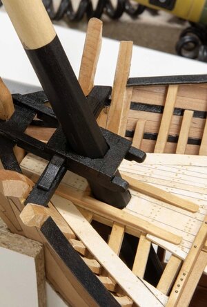

Good morning. I broke my treenail drill bit so work on the hull ceased. Over the past 5 days I have been playing with the waterways and foremast support.

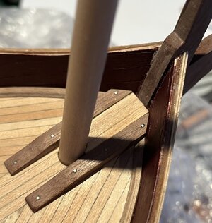

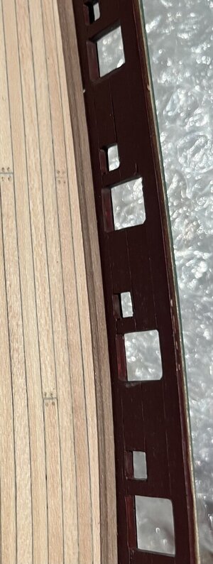

Waterways. I added a concave curve to the 3x2mm strake. Just to add a little more accuracy…I scrapped this into the walnut being careful to leave 2mm for the bulkhead supports.

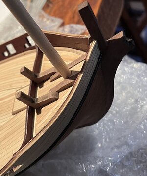

Foremast support.
I made these from scratch. I did not like the Cazador kit design so went more for the Le Requin structure. For The entire foremast support I want to be more open and visible than the Occre kit suggest.
The waterways were cut to fit the mast support structure:
I cut and shaped the supports from left over African walnut from the kit CNC base. Added some nails. The shiny nails will darken quickly as this is not brass.
Lesson learnt: cut out surrounding parts and dry fitted everything first including the angle and mast placement etc- all dry fitted

Love the shape of the waterways!!! You make it look easy! Okay The changes you made at the foremast are none like the kitdesign describes, but love it. Where did you get your inspiration from?
regards,
Peter
Good morning Peter. Thank you. My inspiration came from the beautifully built Le Requin by Jean Boudriot. Maybe when I’m big I will model somewhere like this ;)
I agree fully with @Pter Peter. The waterways look brilliant and so does the assembly at the foremast - excellent work!

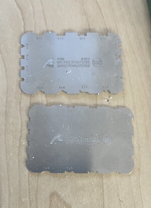

Great work Grant. Those shape scrapers are a must in a modelers tool chest.
Good morning Daniel. There is not much I get here but when I saw these I grabbed them. My first go with them and what a pleasure.

Yes, Le Requin is a great example of inspiration. For my ship as well. However, the Cazador kit is different in many ways so you really have to bash a lot of things to get in the same area as Le Requin. I really like your approach on the Fore and it will be a great addition to your model and other builders will follow for sure.
It's almost tempting to build another Xebec after this one and follow your lead on this on, maybe I'll get to it in the future. Who knows. :)
