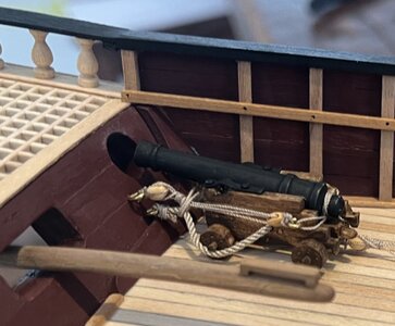

Grant doing his own thing….. From the start when I redesigned the hull shape and stern length of the Cazador besides attempting a more “sexy” look I created space to include the aft facing cannons. It didn’t make sense to have the stern cannon ports and no cannons.
These are in the “stowed” position similar to the picture below :
My stern carriages are slightly bigger than the 8 pounders on the main deck and hold a slightly larger cannon. I bought these cannon barrels from a local hobby store. I used the long falls of the inhaul tackle to secure the rear of the cannon to the carriage. The breech line and outhaul tackle is secured with a 0.4mm line as in the diagram above.
As with all my cannons no block strops or hooks are used….
The “poop” deck thus far:
View attachment 395895View attachment 395896

Nice rigging, Grant. The deck is coming alive.
Grant, great idea to place two cannons at the stern. For a moment I had the same idea but didn't worked it out. After seeing your pictures perhaps I should have done it. However, it's looking great and thank you for showing the result! :) Thumbs-Up

Thank you Peter. Yes that “tennis court” deck as Johan put it is starting to get busy. I have one more piece of furniture to make and she is done. Well I did make it but it went into the trashRedface.
Thank you Peter. I saw a Xebec (can’t remember where) which had these cannons and I just had too:D.I knew I had to extend the deck of the Cazador kit to make them fit. I do wish I had some hooks small enough for the cannons tho and I did attempt to make some but could not get them to scale. Still my “cheat” rigging came out ok. Cheers Grant

True story PaulROTF. It so funny, I had a bet on wether you, Uwek (@Uwek) or Johan (@RDN1954 )would pick up the fact that my cannon would blast a hole in the “helipad” ROTF. My problem was I made the ports too high on the transom. Happens when you have no plan or reference when scratch build certain aspects ROTF…comes back to bite you on the bum at some point. For Grants Xebec in his pub I am very happy how my deck is coming out tho. Two aspects which I won’t do again tho : 1. Never use brass again. Don’t care the cost, brass black is a must and 2 : getting hooks at scale for the cannons. My “cheat” rigging while looks ok just needs to be better. Again looks good for Grants Xebec in his pub tho:D. Cheers Grant

I love the stern teeth, Grant. I also went to great lengths equipping the WB2 with its two stern cannons and I think this is an aspect which is often overlooked by model builders.
Thank you Heinrich. Yep I’m with you. They look cool from a visual point of view.
Great canon rigging, Grant, and identifying the type of carriages. It definitely adds to the entire appearance.
Thanks Jim. I am happy with my overall appearance of these canons. As mentioned to Paul and Peter it would have been nice to include hooks and block strops but I couldn’t make them small enough.

Superbe rigged guns. Much improved from your Victory. When you put drowing of french gun and and your model, it seems to mee hooks could be possible in this scale, but it's better to show not tell, so I think I'll try that on my model. Cheers

When the time comes for hooks (next ship): 2-5mm PE Hooks
