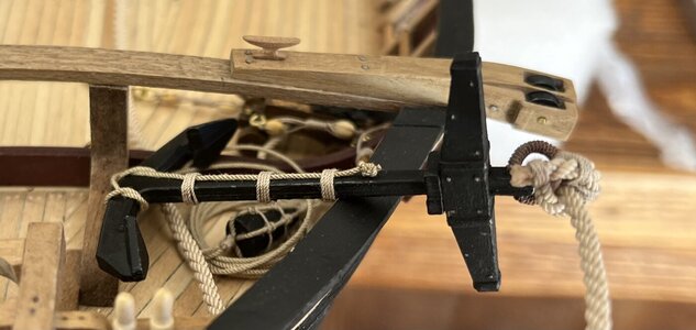

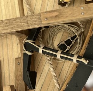

Worked on the Port Side anchors (same as SB earlier). WIPROTF and just placed in bow area.
Probably the first photos I’ve sent in daylight for a while (always play early in morning in the dark….I’m always in the dark with building shipsROTF). Definitely shows more detail and more of the finish I’m trying to achieve…..more oop’s as well;). Cheers Grant

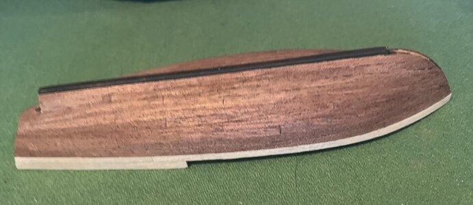

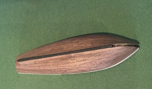

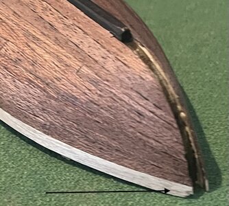

Second layer on ships boat done. Some final sanding, trimming and fitting of the stem to be done.
View attachment 403624View attachment 403625
… and of course Grant chips a veneer plank….just wouldn’t be Grants Xebec if I did not :D
A little fix will have to happen.
Cheers Grant

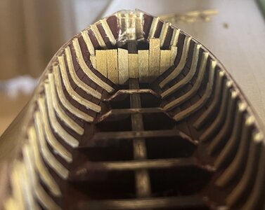

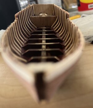

Ships boat continued :

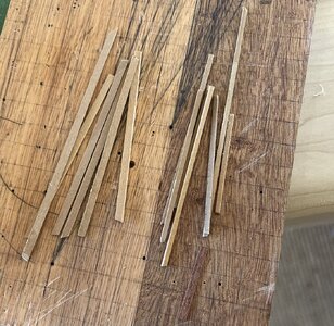

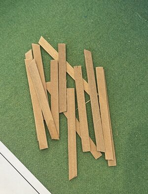

Some serious UGLY for a while. This is going to be a Grants boat as I really don’t like Occre interior. I was hoping to copy Peters masterpiece (@Ptèr ) (Le Requin) design however I am wood limited so no go. Let’s see…..
I found left over Victory walnut planks deep in my scrap tub (truly my last few pieces) which I cut to 2mm for fake ribs and 3mm for planking the “bulkheads” and transom.
Cut out the oversized frames.I painted the interior the red/brown of the ships bulwarks. Bent the ribs using boiling water and as they are only 1mm they bent easily.
Whew- to make this good is going to be a challenge- bear with me:p.
Cheers Grant
