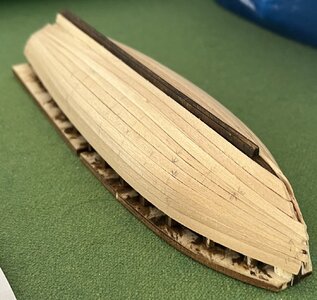

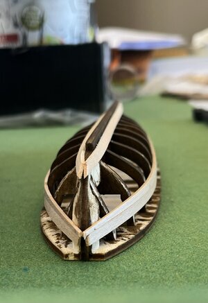

The ships boat: I am doing 2 layers of planking. The outer layer will be in a similar colour and pattern to the ship itself. (Grants design). I will have to cut the left over veneer into 3mm planks - hopefully I don’t break any as I just have enough.
Inner planking: before planking I stained the ribs with oak stain in the same “used” not weathered style as my cannons and oars. I did this prior to planking as the inside of the boat will lime wood of the first planking layer and it will not be possible to stain the ribs without messing the lime- well for me anyway.
Progress so far :D90E5109-591A-4B3E-AC70-00D164ED36E0.jpegF92D997B-0D4F-496B-982D-D0BD72EB85FD.jpegEBA5A036-7672-4C0F-BB5E-CF6B3B9B708B.jpeg

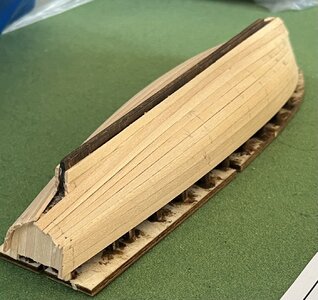

Good morning:

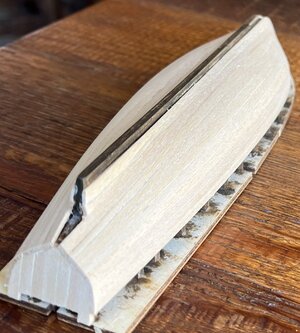

This morning I did a little trimming and sanding. I’m going to cut the veneer left overs to see if I can get enough planks to do the boat. If not I am going to have to finish this more and rethink my colour scheme for the boat.
Still need to work out how to construct the rudder part of this boat. Thinking of a little triangle wood with a hole in it. Should fit in there nicely. The stem fits nicely :D
View attachment 402006View attachment 402007

Thanks Peter. As with so much of my modeling it always looks like a mess when I start. I’m pretty chuffed with how the first planking layer is coming out and holding my breath for what she will look like insideRedface

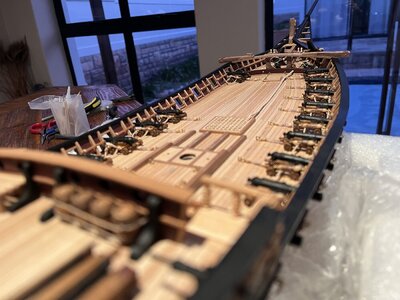

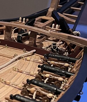

Good morning. Boy…this was supposed to be a quick build for my pub…..after 9 months still building cannons ROTF .
Just more cannons….Sleep
3 more to goExplosion.
Cheers Grant

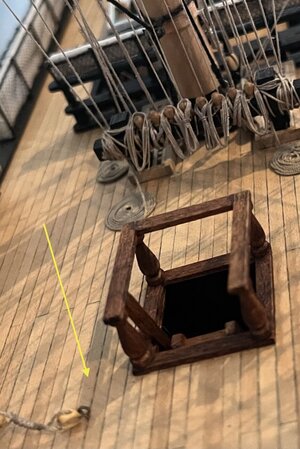

PS : note for Paul (@dockattner ) The rings on the fore hatch are not glued yet so are all over the place.… for you I will align and glue the rings to the hatch.
PS 2 : I am disappointed with the shinny brass however living in Melkbosstrand on the sea these discolour quickly. If you look at the hatch rings vs the cannon already less shine. Then take a look at my Victory-
…..really trying to convince myselfROTFROTF

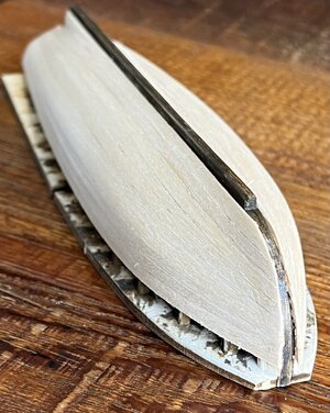

Good morning - ships boat

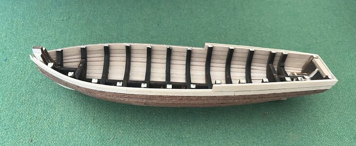

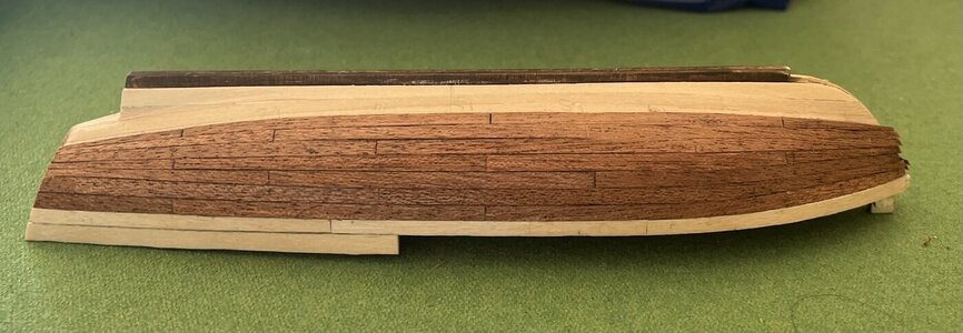

Out of the rig. The inner planking came out really good as did the ribs. Unfortunately there are not enough ribs and way too large. Going to have to cut them out and make my own ribs.

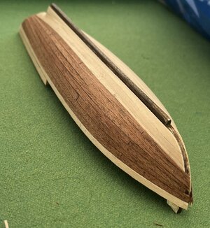

Second layer:
I have enough veneer if I use a butt pattern and use the short leftovers. There are no redos here.

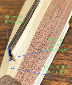

I am changing the shape of the stepped stern a little and the colour scheme to make a mini me of the ship.
Before I go any further I need to prepare the rudder section:
Cheers Grant
Second layer:
View attachment 402420View attachment 402419
Cheers Grant
