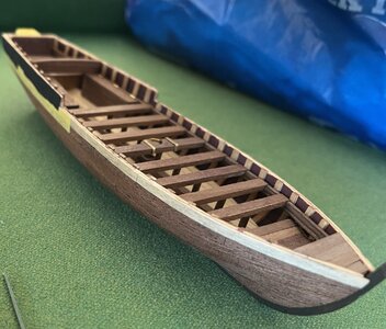

Family all deserted me today, Rugby over and none of my mates wanted to ride or play Padel……so 6hrs playing with my little boat:D
Rider and Thwarts.
Occre had 2 6x3 strakes which I cut into 3x1.5mm for the riders and 4x2mm for the Thwarts.
The rider was measured and 2x4 slots for each thwart where measured and cut:
These where glued onto bulkwarks:
The Thwarts are dry fitted as I still need to do some final cutting, angles, sanding and stern work.
View attachment 404756View attachment 404755View attachment 404754
The Twarts will be removed as I still need to work on the Stern second platform, seats and space for the helmsman before I insert them.
Cheers Grant

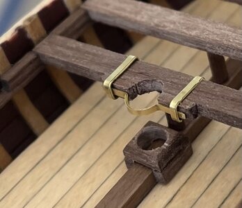

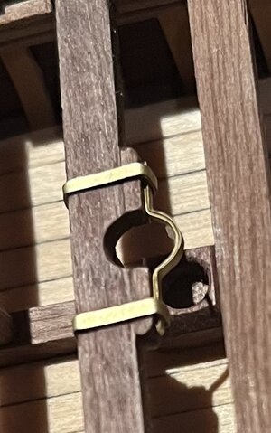

Thwarts and support and mast bracket and base :
The small dowels for the thwart supports was make using 2x2 African Walnut rounded on the lathe. Mast bracket was cut from the left over brass from the swivel cannon stencil.
View attachment 405998View attachment 405996View attachment 405997
Slowly slowly we catch the monkey…
Cheers Grant

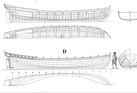

Good morning Johan. It has been a little innovative although I have attempted to get the this as close as possible to the Le Requin boat. Using this diagram and Peters (@Ptèr ) boat. 2DB38640-D853-4077-A2BB-208130FAED02.jpeg
My rudder configuration is totally off tho as I used the Occre Cazador design and E.g I have 8 thwarts not 9. Cheers Grant
Yep, another great update! Some modelers look at ship's boats as a necessary element to complete a build and treat them as after thoughts. Not Grant! Thumbsup Great results, close to your objective using the drawing, long, lean, low profile and with Grant's flavor infused. I don't possess skills that would allow me to build such detail on a small boat, so I will most likely leave them out of my build. Which makes me appreciate those who can!

That boat is very impressive Grant, I really like what you have achieved. While we all treat close-up photos with some trepidation you have proven the opposite. Those close-ups emphasize the quality of your work.
Good morning Roger. Thank you kindly. Yep those close ups….E.g. my mast hole and brace looked so good until those close ups came alnongROTF
