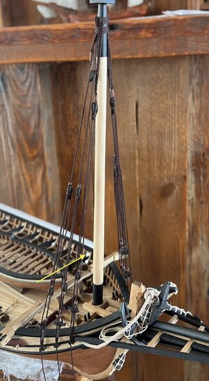

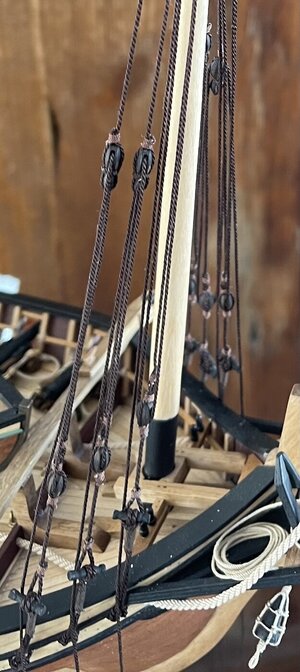

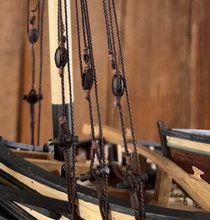

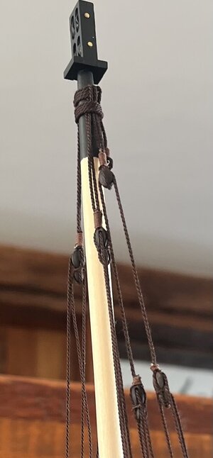

Good afternoon. Man things are crazy at the office at the moment- still not getting in much Xebec time. I am working on the stays for the foremast. 6 stays on the foremast and I deviated from Peters design as I am running out of 4mm blocks for my homemade violin blocks. I used standard 6mm blocks for the lower ones. I wanted the lower blocks to follow the line of hull (yellow arrow) rather than being horizontal. Sort of worked….
Not my best work , but works for my style with Grants Xebec.

This typical type of rigging looks nice, Grant.

Ah, working on the fiddly stuff. Looks fantastic to me I haven't learned much about it but looking forward to giving it a try on my WB. Looks like a lot of research is involved .

Part shortages force you into improvisations. Still looking very authentic.
Good afternoon Johan. Thanks, I think once I tension and tie off each stay she is going to look better. Yep no more parts or ropes to be bought for my Xebec. N Boer maak n plan.;)

Good afternoon Peter. These Xebecs have an unusual rigging system and each one I have seen differs from the other. It has been fun working out how it all works.

this is really good rigging work. Looks very good.
Thank you very much. Seeing your work I still have plenty to learn.
As such, your 'best work' must be rather sensational Grant! Thumbsup
Good afternoon Mark. I’m still looking for my “best work”ROTF. Thanks for the compliment.

Good afternoon Jan. I quite enjoy the rigging. Reading some books on period ship rigging, I am still way off using the correct knots, bindings etc etc. I look at the guys doing some scratch builds and I realize how simplified my work is. It has been fun learning about these Xebecs rigging and choosing which works for my ship.
