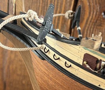

Good morning. Got some Xebec time again:D. I will start the stays and seating of the foremast. The Occre design has the stays originating from inside the bulkwark, however I am using Peters (@Ptèr) wonderful build and some pics of the Le Requin for my rigging.
The toggles for the stays run from 3 rope loops from outside the hull. To be continued:
