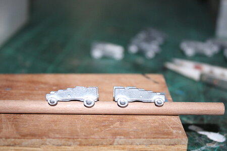

Hi, Grant, just unboxed my kit, & I agree, those god-awful kak gun carriages! I can live with the barrels, but no-way the carriages. Mine have OVAL wheels! I will be complaining to OcCre.
You have green shaded thread, mine is a 'goldy-yellow', but I make my own in any case. A couple of pics of the 'egg wheels'.
Stuart
Good morning Stuart. Ah yes those horrid cannons and other parts….I have used very few of the Occre casted parts. The cannon carriages are the worst by miles….. I also replaced all the blocks and ropes as these are not to scale and the green rope …..well…..In saying that there are some beautiful Cazadors on SOS where guys have built it from the kit. Cheers Grant

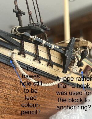

Good afternoon. I finally got some time to continue with the foremast stays and anchors.
My stays are tied off to the strake on the fore bulkwark. Being active stays and not shrouds I decided on this vs being tied to the stay by the toggle. The falls I looped and stored them behind this strake.
I did break the fore support….will have to fix.

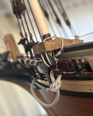

The Anchors. I made a sling at the cathead to hold the stored anchor, some strapping between the first and second stays.
Some overall pics :
The are some loose ropes around - I will finish these as we continue.
Cheers Grant

Apart from the fact that these wheels are oval, people think that this is a high-quality company product. The truth is that it would be a shame to ruin your model with something like that... it's really worth putting in some effort and making just any wooden gun carriages.
@Stuart Little
Good evening. Absolutely agreed. For most of the casted parts I would recommend scratch building the parts from wood, especially the cannon carriages. I would view @Ptèr ’s Cazador/Xebec where almost every part has been crafted from walnut. It is an absolute classic. Cheers Grant

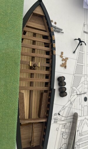

And for fun I prepared the barrels and testing some oarlocks for my longboat:
Cheers Grant
