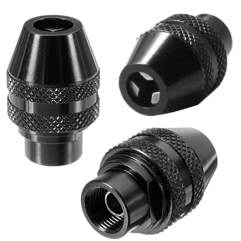

@ Giampy65, can I ask you about the tool in the first picture, is it a battery-powered drill ?, Regards Knut-
yes, it is an electric tool with rechargeable battery, very convenient and practical to use without the clutter of the electric wire. I bought a couple so I can use two different diameter bits without replacing them every time. The price is very affordable.
@ Giampy65, great, do you have a link to where you bought these drills, regards Knut-
Yes, I bought it from Aliexpress. I don't know if I break the rules of the forum by inserting a link, in this case I kindly ask the administrators to eliminate it:
There are various types of electrical tools like that, some also have the rotation speed adjustment:
I also replaced the chuck with one of these:
