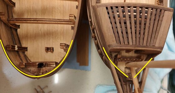

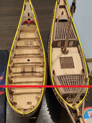

Thanks for the advice, Jan, but I could never do that - I would feel way too guilty. I've managed to lay down one more plank today (I have reverted to the 4mm planks now, as it is simply impossible to bend the 6mm plank into the nooks and crannies required. The second 4mm plank of the day has now been clamped to build up memory. Maybe, I can still get that glued tonight, but that is a big maybe.Cheer up Heinrich, take an all day coffee break, go for walk, contemplate the state of the world from your balcony. Things always look better after a change of scenery.

Are you still closing the hull or working above the wales?Thanks for the advice, Jan, but I could never do that - I would feel way too guilty. I've managed to lay down one more plank today (I have reverted to the 4mm planks now, as it is simply impossible to bend the 6mm plank into the nooks and crannies required. The second 4mm plank of the day has now been clamped to build up memory. Maybe, I can still get that glued tonight, but that is a big maybe.

I am still busy - and will be the whole day tomorrow - with closing up the Starboard Side. Then only it's on to the Port Side!Are you still closing the hull or working above the wales?

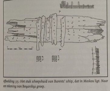

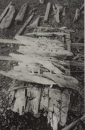

In 1979, Russian amateur archeologist, Dmitry Kravchenko, found the wooden construction as part of a ship’s hull while searching for artifacts in and around Het Behouden Huys. He produced a drawing of his find, but because of the extremely difficult circumstances under which he had to work, it could best be described as “rudimentary”. Kravchenko left behind everything that he had found, untouched and in their exact original location and positions. Seemingly, the “discovery” then went into a thirteen-year long hiatus in which no further mention of it was made. In 1992, a Russian expedition led by Peter V. Boyarsky of the Russian Research Institute for Cultural and Natural Heritage arrived in Nova Zembla.
Interestingly, Boyarsky’s research did not focus specifically on finding artifacts connected to the WB expedition – it was a comprehensive mission (which included archeologists, ecologists, geologists and representatives of various other disciplines) – aimed at achieving a global picture of Nova Zembla which they viewed as a National Park of sorts. Be that as it may, they “re-discovered” Kravchenko’s find and deemed it significant enough to take back with them to Moscow.
The discovered hull portion of Willem Barentsz's ship.
Six months later, a Dutch delegation comprising of Henk van Veen (Chairman of the Willem Barentsz National Committee), Pieter Floore (an archeologist on behalf of the Institute for Pre-and Proto History of the University of Amsterdam) and Ab Hoving (on behalf of the Rijksmuseum) traveled to Moscow in an attempt to determine whether this “wooden construction” was indeed part of the ship of Barentsz.
In Ab’s words: Viewing this 4m x 1m section of the WB’s construction and its significance in world maritime history is hard to describe. Of all expedition ships which ever sailed the oceans, not a single piece has ever been found (obviously the book was published well before the discovery of the Endurance) – not of Columbus’s Santa Maria, nor of Cook’s Endeavour, let alone the ships of Vasco da Gama and Magellan.
A drawing of the discovered hull portion by the Boyarsky Group.
So, what can we learn from the hull portion of the WB that was found? The single most significant aspect is that the planking consisted of a double layer. It is important that we distinguish here between what the Dutch called a “Dubbeling” (Doubling) and a “Dubbele Huidlaag” (Double Layer of Planking).

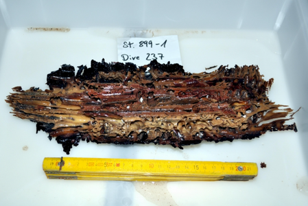

“Dubbeling” (Doubling) was an extra layer of wood (normally consisting of fir- or firewood) of approximately 1 cm in thickness which was nailed on the outside of the hull below the waterline to prevent the hull from being infested or affected by “paalworm/shipworm” (Teredo Navalis). The flat and square-headed nails of which four were nailed into a square-inch of planking would rust to one another to form an impenetrable layer of corrosion around the ship. It was very seldom that the paalworm managed to penetrate this layer of corrosion*. In case the worms did manage to penetrate the corrosive layer, they would encounter a further layer of cows’ hair and tar which was smeared between the two layers of planking. Should the worms manage to penetrate that layer as well, they could well cause the total destruction of the ship. The “dubbeling” was replaced after each long or major trip.
A piece of shipworm-infested timber.
*This was in fact the first iteration of what became common practice in the 18th Century – the coppering of hulls.
It is interesting to note that a particularly dangerous variant of the paalworm lived in the hot areas such as the tropics and therefore it is no wonder that “dubbeling” was found on almost all of the shipwrecks that have been discovered in these areas. However, ships sailing to and around the Scandinavian countries did not need “doubling” as the very cold and harsh water of the Oostzee was completely devoid of shipworm.

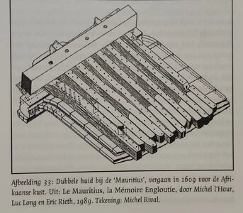

A Double layer of planking, however, was according to Ab, an altogether different story and is a concept which is not yet fully understood. This was something that was found almost exclusively on Dutch ships around the year 1600.
It is important to note that the discovered hull portion of the Willem Barentsz is not the only proof of the double layer at the time. In “bestekken” (specification lists) of the time it is expressly mentioned. The wreck of the Scheurrak SO1 (previously mentioned in my log on quite a number of occasions) had a 4-inch layer of outer planking attached to the 4-inch layer of inner planking and the hull frames by means of wooden trennels. The wreck of the Mauritius which has been lying off the coast of Gabon since 1609, not only featured double planking as well, but also had a layer of lead between the two planking layers. The outer planking layer, however, was not secured to the hull frames, but only to the first planking layer by iron nails; not trennels. In addition to all of this, the Mauritius also featured “dubbeling” (doubling of the hull below the waterline as safeguard against the paalworm.
This is a drawing of the layout of the double-layered planking found on the wreck of the Mauritius - a Dutch ship which stranded off the coast of Gabon in 1609.
On the Willem Barentsz, both layers of planking were only 4cm (1.5-inches) in thickness and were secured to each other by nails – just like on the Mauritius. Which begs the following question: What was the purpose of the double layer of planking?

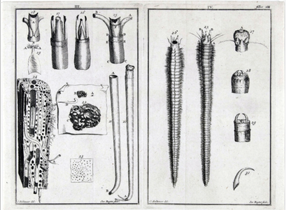

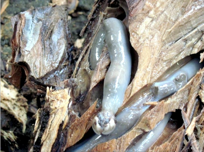

TEREDO NAVALIS / SHIPWORM
There’s something interesting about Shipworms. They are not a worm but a saltwater clam. Shipworms get their name from their long, narrow, cylindrical bodies but the worm resemblance ends there. A closer look at the creature reveals a shell at its front. This shell has 2 halves with a gap in between like a clam shell. In the gap pokes a muscular foot that acts like a suction cup, holding the shell in place while its razor-sharp edges scrape the wood ahead of it. At the top, 2 flesh-toned siphons swish water over massive gills. At the bottom, a slimy, eyeless head resembles a mix of wet lips & diseased intestines. In between, a glistening gunpowder-blue body stretches up to 4 feet long.
Instead of eating, bacteria in the creature’s gills helps it suck energy from sulfur. The whole thing is sheathed in a curving tusk-like tube created from the Shipworm’s excretion of calcium carbonate. Shipworms eat sawdust and its stomach has a pouch for storing sawdust and a special gland for digesting wood particles. These “termites of the sea” also have an organ full of bacteria that digest wood. The bacteria take nitrogen from the water and convert it to protein for the worm, since wood doesn’t supply protein. The bacteria in return, get nutrients from their host. A Shipworm begins life like most marine invertebrates, as a tiny piece of meat in the plankton soup of the sea.
