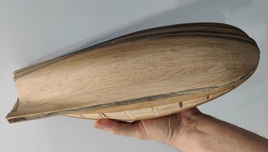

With the ugly things like shipworm now out of the way, it's time for my think-tank again on why I am struggling so much with my planking all of a sudden.

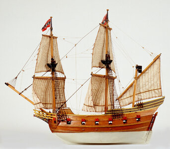

As a reminder, here is Willem Barentsz #1 in all her glory. Sure, the planking was a challenge, but nothing like what I am experiencing now. Which begs the question: What is different? Sure, the oak is more difficult to work with, but it has nothing to do with how the hull lines run or with interpreting the hull lines. The answer is actually simple, The WB #2 is built so different to #1 that I cannot expect to follow the same procedure and then expect it to work.
From the red line to the stern, the two hull shapes are essentially identical, but look at the two bows.

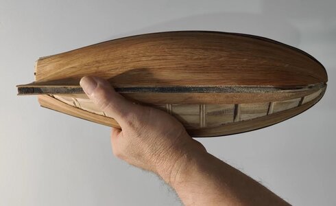

Close-up
Just look how much rounder and wider WB#2 (on the left) is at the bow compared to WB #1. There is a lot more space at the bow and like I said to Ab last night, it might just allow me to install the winch in the same position that he did. But that wide, round and more spacious bow comes at a huge expense when it comes to the planking. :eek:

You certainly have your work cut out for you. It's coming along too! Working with oak has its challenges huh? Are you using white oak or red oak? I'm looking forward to seeing your progress!
Yes, Phil - that I have. To me it looks like white oak. What is so frustrating is that I am probably about one-and-a-half strake away from closing the hull on the Starboard side, and now she throws her curveball at me. I just cannot figure out how to close that gap satisfactorily. With the walnut no problem - I have already checked that - with the oak, it's a different story.
Can you make a pattern with some card stock - to fit to get a template to follow for bending? Just thinking....?
The template is an excellent idea - I had to do that on one of the strakes during the previous build, so it may well be time to do that again. Thumbsup

The shape of your WB #2 build in the bow area makes actually a lot of sense, especially when compared with it’s full size replica cousin, as in Harlingen.
I
I
That makes sense Johan as Gerald de Weerdt (master shipwright of the replica ship) has actually deviated from his own initial plans by following much more closely Ab's hull design.
My Vasa shared the bluff bow problem you are now encountering. Nigel's solution was spiling but you'll need a large enough piece of oak.
Begin here: https://shipsofscale.com/sosforums/threads/vasa-1-65-deagostini.5904/post-140102 for a reminder of my experience.
Thank you for this Paul. I believe this is what I am already doing (see plank below).
This has brought me to where I am now. My issue is that I am not doing this with veneer but with 1.5mm thick Oak which has to accommodate the compound curve within a 15-inch length.
I know what it's like to do that with walnut, but oak WOW. I also know what it is like to spend an hour on one strake then break it just before its ready. Very frustrating however when you finally have sucess it's such a reward.
You are right my friend. I just have to keep my head down and keep trying, Thumbsup

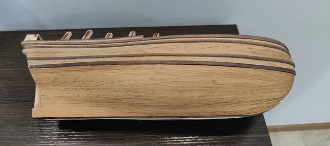

Good Morning Heinrich. I know you seek perfection and this is pretty darn close. The spiling strake is hardly noticeable. For once I am using my laptop and not my phone and even with the zoom function it all looks fantastic. What are you thoughts with regards to oiling the hull? Cheers Grant
Thank you very much Grant! My luck - I take Macro shots and then you go and zoom in! ROTF If the spiling line shows, it's not good enough, so more sanding tonight. :eek: Seriously though - I have given the hull a preliminary sanding and given it one coat of colorless shellac which acts as a sanding sealer. Then I will do the final sanding. The beauty of the shellac is that once sanded, you can still apply any finish you like.
From the point of historical accuracy, the hull needs to be painted below the waterline as per Ab's model. Keeping this in mind, I could have taken many shortcuts with the hull planking below the waterline, but that's just not me. As to the oak above the waterline, I have a few options. I can use the Clou stain that Hans sent me, my Tung Oil, shellac as a finishing layer or a polyurethane varnish. I will still decide on that later on - first I have a Port Side of which I need to finish the planking.
