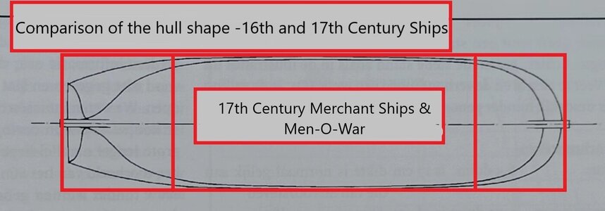

Therefore, I thought it would be appropriate to evaluate the hull shape of the WB and give you treater insight as to why I spent such a long time on getting the actual hull shape right. As usual, I am using @Ab Hoving Ab's "Het Schip van Willem Barents" as the main source of information:
DETERMINING AND EVALUATING THE HULL SHAPE OF THE WILLEM BARENTSZ
When examining the books of Witsen (1670) en Van Yk (1697), which describe shipbuilding from 1625 onwards, we notice that the widest point of ships’ hulls occurred at a point which was approximately one third from the bow. Viewed from above, ships of this period – whether they were merchant ships or men-o-war - had an almost rectangular shape. In other words, when the width of the front bulkhead of the frame is viewed in relation to the width of the bulkhead behind the large mast, (two parts that are often easy to distinguish on images and can therefore be compared), there would be a very small difference. The conclusion was that ships’ hulls of this time would only start their taper (the loss of width forwards and backwards) at the very last minute.
Note the rectangular shape of hulls from 1625 onwards and the fact that the taper of the hull occurred only at the ends. Therefore, you will see that whether you are building a 17th Century British, Dutch, French or Swedish (yes, we can never forget about our contingent of VASA builders:D) ship, they all look essentially the same when viewed from the top.
The reason why the full hull shape was chosen for merchant ships, is obvious. Shipowners were primarily looking for load capacity, while speed, despite the perishability of the goods transported, was not considered as important. Less understandable is that the full hull shape was also preferred for men-o-war – especially when speed and maneuverability could be considered as important aspects. Here we have to take into account though, that the difference between merchant-and warships was so small in the first half of the 17th century that the extra carrying capacity – which also meant extra guns – were deemed more important than speed.

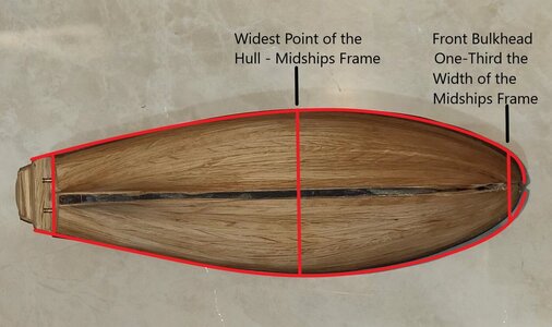

However, if we examine the wreck of the Scheurrak S01 (circa 1590s – the same time frame as the Willem Barentsz), we see a ship of which the front bulkhead is perhaps half the width of the widest frame midships. Compared to other drawings and paintings of the time, we see the exact same thing – ships from this earlier period do not appear rectangular, but almost elliptically-shaped when viewed from above. In other words: the greatest width did not occur a third from the front of the hull, but midships.
In contrast to the full hull shape, the elliptical hull of the Willem Barentsz would have resulted in greater speed and maneuverability – two aspects which would both have been regarded as highly desirable for a ship to be used for polar exploration. Load capacity was very much of secondary importance. Here you can clearly see that the widest part of the hull occurs at the midships point while the width of the bow and stern bulkheads are roughly a third from the widest one at the midships point.
Just look at the elliptical (and in the eyes of this beholder) beautiful hull shape of the Willem Barentsz, which conforms 100% to the ethos of 16th Century Dutch design. That is why it was critical to me to get the hull shape as accurate as I could - it is, after all, one of the most distinguishing features of the ship.

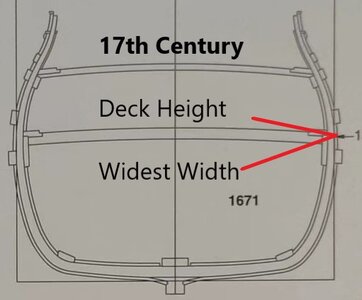

There is a second aspect that is very important: from Witsen and from Yk's writings and drawings, it appears that the greatest width of the individual bulkhead for ships of their time coincided with the height of the deck height. Witsen calls this spot which was used by shipwrights to determine the hull shape, “uitwatering”. “Uitwatering” translated into English means “drainage” – which I interpret as the line along the hull where the scuppers would be located.
The bulkhead of a Dutch ship (circa 1671) which shows that the widest point of the frame coincides exactly with the deck level.

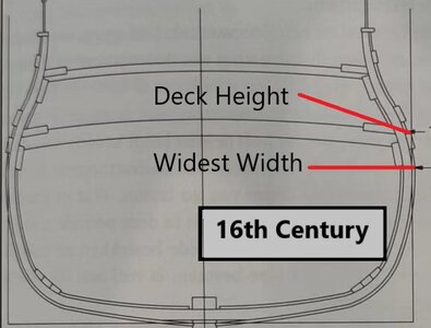

In contrast to the ships of the Witsen and Van Yk’s eras, ships of the sixteenth century – of which the Willem Barentsz was one – displayed a different characteristic: the widest part of the individual bulkhead did not occur at deck level but below deck level. Taking into account the Dutch building method of shell- first, this would result in a drastic difference in hull shape between ships of the two eras. So, what effect would this have? In a nutshell, the lower point at which uitwatering occurred, would result in a lower center of gravity which, in turn, would result in greater stability of the ship.
The frame of a 16th Century Dutch ship (read Willem Barentsz) shows that the widest point of the individual frame occurs well BELOW deck level resulting in a lower Center of Gravity and increased stability.

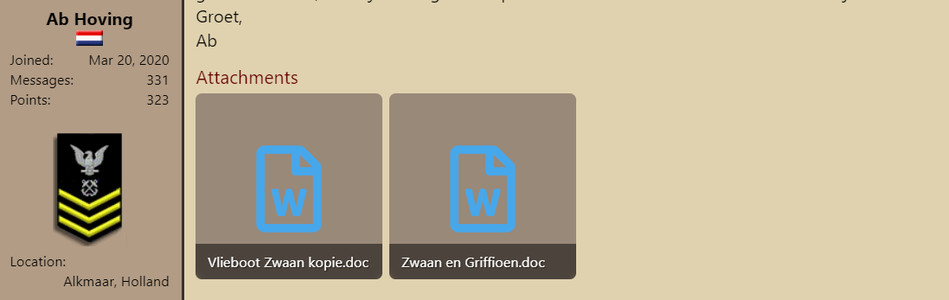

I want to share with you the amazing "gift" for lack of a better word that I received yesterday from @Ab Hoving.
You will recall that as part of my research, I managed to obtain from the Zeeuws Archives the original document in which all the alterations and preparations of the Zeeland ships, the Zwaan and the Griffioen, for the 1595 expedition were listed.
The problem that I faced though, it being the original document, was that the handwriting was illegible and impossible to decipher. Yesterday, on the spur of the moment, I sent Ab a PM in which I asked him if he does not have a copy of this document written in more modern Dutch.
Within a couple of minutes, I had a reply containing not only the transcription of the document I requested, but also of additional information on the Zwaan, which until yesterday, I had not even been aware of. According to Ab the transcriptions were done by Menno Leenstra, who is well-known for his transcriptions of archival documents.
You can well imagine how excited I am about these two documents - especially when the opening paragraph of the document devoted exclusively to the Zwaan reads:
Waarschijnlijk is de vlieboot Zwaan, gebruikt in de beide Nederlandse expedities naar de poolstreken van 1594 en 1595, het beste voorbeeld voor een “nieuw schip voor Willem Barents”. Er is over deze vlieboot meer bekend dan tot nu toe is gepubliceerd.
The “Vlieboot” Zwaan which participated in both Dutch expeditions to the Polar Regions in 1694 and 1595 is, in all likelihood, the best example of a “new ship for Willem Barentsz”. There is more known about this ship than what has been published to date.

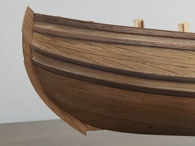

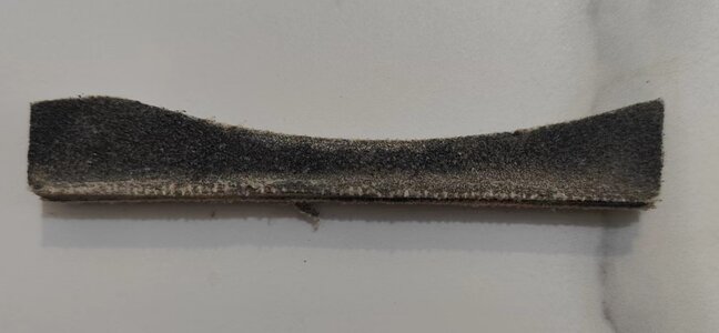

Thank you, Richie. The instructions say to cut away the ends of the bow planking to create a space for the stem. I did not want to risk any cutting in case I cut away too much, so I made this curved, little sanding block which I gradually built up with sandpaper on both sides and started sanding. In the end, the groove that accepts the stem is 9mm wide (the stem is 8mm wide) so there was a lot of sanding, fitting, and more sanding involved.

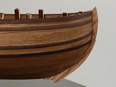

Phase 1 of Installing the keel.
I declare the fit of the stem and the subsequent joint with the bow planking a success! ROTF
Good morning Heinrich. Declaration accepted ;) . Nice work! Cheers Grant. PS- I use “nice” as a slate to my favorite English Teacher who admonished me many years ago never to use “nice” as a descriptive word as it is non descriptive.ROTF. Personally it fits into my “you owned it” category.
I wholeheartedly agree with your English Teacher!!! ROTF I have forbidden my students to use "nice", "delicious" and "maybe" when speaking to me! :)
Thank you, my friend. I was a little worried about the installation of the keel, because of the fact that I changed the shape at the bow, but luckily all went well. The rest of the keel had been fitted in the meantime. Now it's just a question of a final sanding and then the "decorations" can begin.
Very nice, a precision custom sanding tool.

I found this part of my build very stressful Heinrich. Glad you were able to pull it off with precision (I had the added protection of a veneer planking but still wanted it to be just right).
You are right Paul - this part is always a bit of touch and go. On the one hand the oak is a real challenge to work with, but on the other it sands to a beautifully smooth finish. The whole keel fits beautifully and seamlessly - so I'm very happy! :)
Aha, the keel is on, now it is becoming to look like a ship more and more, Heinrich my friend.
