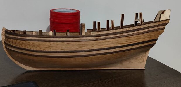

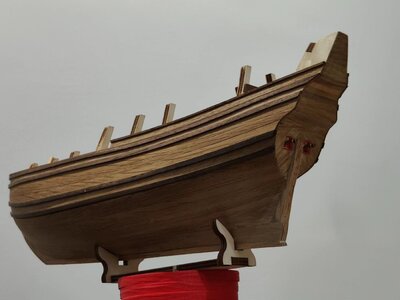

Phase 1 of Installing the keel.

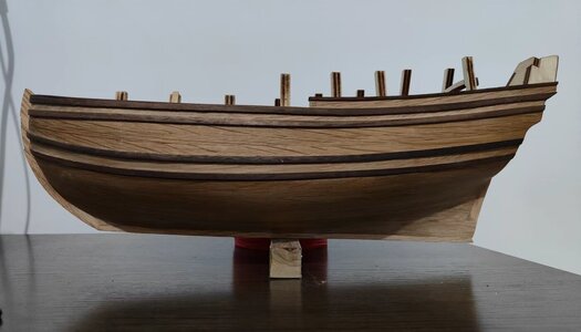

I declare the fit of the stem and the subsequent joint with the bow planking a success!![]()
Thank you, Phil!Looking really good!
Wow, my friend. You make me blush!She looks stunning my friend.
It is amazing how bautifull she looks

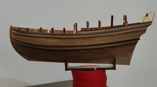

She is looking very nice, Heinrich.Keel Done!
My favorite angle.

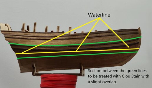

Hi Heinrich,Hello Everyone

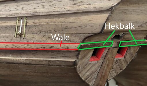

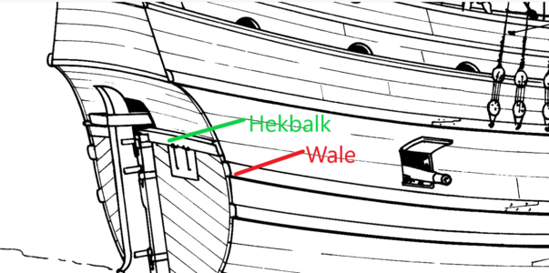

I mentioned to @Peter Voogt Peter, that I had planned on applying CLOU tonight in some parts, but because that also includes part of the stern, I first had to install the two "hekbalken" - directly translated to English it would be "gate beams", but that does not sound right. They are placed at the point where the curved planked part of the stern transitions over to the straight-planked part.

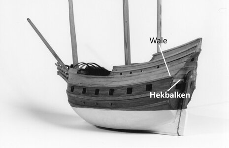

If you look at the above picture of WB #1, the hekbalken are marked in green. Now, note their position relative to the adjoining wale. You will see that I placed the hekbalken so that they fall directly over the wale, creating one line. This INCORRECT - doing it, I knew I wasn't doing the historically correct thing, but I suppose I succumbed to Al-Fi in a moment of weakness.
So, how should it look like? Well, this is confusing as there is a marked difference between @Ab Hoving Ab's interpreation on the one hand and those of @Kolderstok and Gerald de Weerdt on the other
If you look at Ab's plans, you will see that the hekbalken fit just underneath the wale.

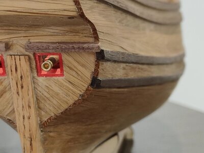

Ab's model with the hekbalken underneath the wale.

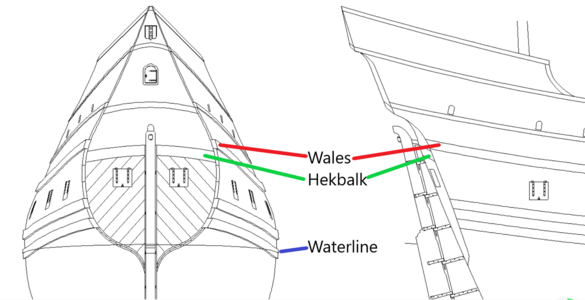

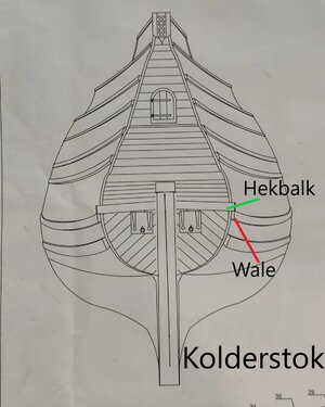

If you look at @Kolderstok's plans, you will see the hekbalken are placed just above the wales - in fact, it would be fair to say they almost "rest" on top of the wales.

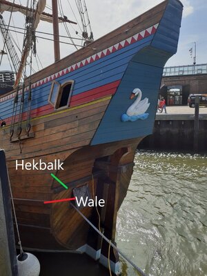

Gerald de Weerdt's drawing, which in turn, is an interpretation of Gerrit De Veer's drawings from his journal, also show the hekbalken above the wales.
Therefore, it comes as no surprise that on the replica, the hekbalken are above the wales.

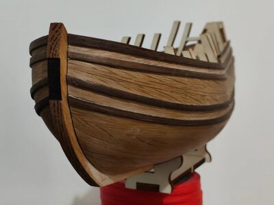

Looking at WB #2, it was clear that placing the helbalken underneath the wales, was no option and thus I followed the examples of @Kolderstok and Gerald de Weerdt.

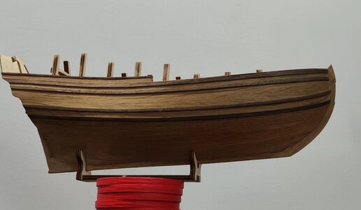

Hekbalken on WB#2:
As soon as the glue has dried - three hours from now - the part of the stern up to and including the hekbalken will be set in CLOU together with the designated portions on the sides and the stem.
Correct Jack. The rudder will feature a 50-50 combination of CLOU stain and white paint - as would the stem.Hi Heinrich,
Hekbalken on WB#2:
Ron, I thought about that as I did on WB#1. On WB#1 I went for the artistic license and did not paint the wood, but on this build my objectives are different - it's all about being historically "correct". As beautiful as the oak may be, leaving it unpainted would just not be the right thing to do.Heinrich,
I know you’re going for historical accuracy however what a shame to cover that beautiful wood with paint![]()
