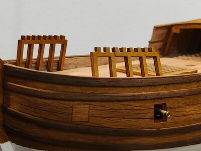

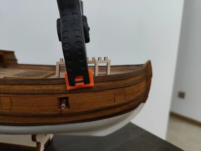

Baby steps now as I am back to preparing exam papers. I still try to squeeze in a plank here and there in between, but you will appreciate that the going is slow now. However, I am not perturbed. With the stern construction mostly done, I am now relaxed and concentrating on getting the front canopy right.
Both frameworks are in position and this time I am much happier with the line that they follow and also their inclination inwards. Notice the three half-cuts that were made in order to bend and adjust the railing to my satisfaction.

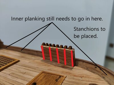

I have completed the inner planking on the port side canopy railing. The black lines indicate where the inner bulwark planking still needs to go, while the red lines indicate the stanchions that need to go on the inside of the front canopy.
The challenge here is going to see if the roof beams fit now that I have built a much wider ship. I am now not too far away from another exciting part of the build (to me at least) - that of the winch, mooring bitt as well as the front belaying rack and knighthead. I want to fit all these items before I start the roof construction of the front canopy.

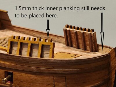

Hello Johan. No problem to take the time to answer you - especially as it is a very valid question. On the real ship, you had the bulwarks, the outer layer of planks that would go on top of that and then the stanchions. When designing the kit, @Kolderstok Hans's idea is that the framework would act as the stanchions - therefore there would be no layer of inner planking required. However, there are a few issues with that. Firstly, the framework is made out of triplex which would aesthetically have been way out of place on this build, where everything is all about the wood tones. At the same time, I understand perfectly why Hans has used Triplex - the framework has to be shaped to follow the lines of the hull - something that would not have been possible with solid wood. Secondly, because I had to pre-cut the framework in three places (in order to shape it), the outer pressure required to bend the upper layer of oak planking around the framework, would simply have snapped the framework into a million pieces.
Therefore, the inner layer of planking was required: 1. to hide the triplex and 2. to make the construction strong enough. The extra stanchions were needed to simulate the framework. This had to be included as the inner structure will be fully visible on this build (I will not be placing front and rear walls - the canopy will remain open at the front and the back).
At the moment the construction does indeed look bulky but when the layer of inner planking is placed (indicated by the arrows), imuch of that thickness will simply disappear. I am confident that I can get the final product to look right.
