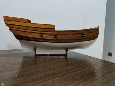

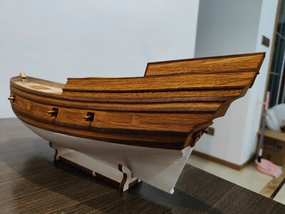

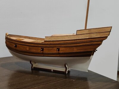

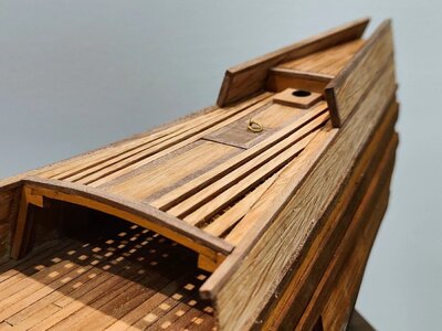

Thank you very much Paul. Seeing that this whole section of the build was from plans in my head and completely scratch built, I am pleased with how it turned out. Your kind words are much appreciated!LOVE this Heinrich! Beautiful craftsmanship!
Thank you very much Stephan! I am glad that you like it!Big thumb up
