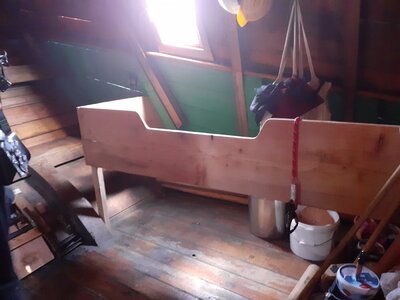

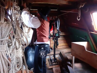

Beautiful work Heinrich. I keep looking at that pinched in stern and wondering how small that must make the captain's cabin. Do you have a rough estimate of the actual dimensions of it?
Thank you very much Don - it is highly appreciated. I quickly calculated from the plans: All measurements are, of course, only approximations. Length: 2.2 m; Height: 1.8m; Width at the widest point: 2.6m tapering to 1.8 m at the very rear.

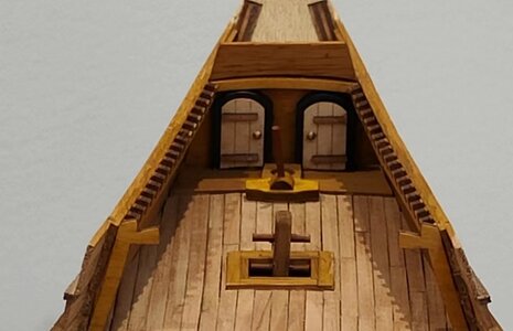

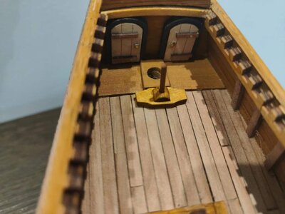

And talking about the captain's cabin. That is finally in place.
Let me say straight away that I classify this front wall as a simulation which is nowhere near to scale. I have simplified it greatly from my first version, by foregoing the planking between the doors and the heavy beam above the doors. The height of the doors is also not to scale as I have had to lob off a considerable portion at the bottom of the doors to get them to fit in the available height. The reality is that none of that will be visible once the center canopy's roof is in place. When everything is completed as part of this assembly, the only visual cue will be by peeking in through the open front of the center canopy - and even that may change if I decide to cover it up.
However, for what it is, I am happy with the outcome, and I am glad that I invested the time in doing it. The captain's cabin remains one of the big differences between my version and the Kolderstok kit and, in my mind, was an important detail to include.

Continuing ...

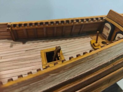

Stanchions placed on the starboard side. I do apologize for the blurry photograph - no idea how that happened.

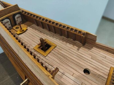

And on the Port Side. For the stanchions I have used walnut for some contrast to the golden color of the oak.
In the end, i did opt to use the "Kolderstok" as steering mechanism and not the simpler whipstaff. Which one the WB had, remains inconclusive so I had no problem going for the kolderstok which looks nicer in any case.

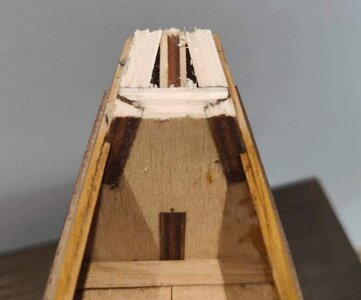

And before I changed my mind or could rethink anything (which would ultimately have been a compromise), I did the dastardly deed!
Continuing ...
Good afternoon Heinrich. Bold move my friend- now for the remake. Sometimes I think model builders are crazy, we make beautiful cabin doors and whipstaff only for them to be partially seen or not at all. Cheers Grant
Yes, my friend - a bold move indeed, but one that had to be made. As to us being crazy, no doubt about that! ROTF

Aha, the demolition has begun!
