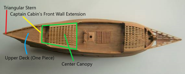

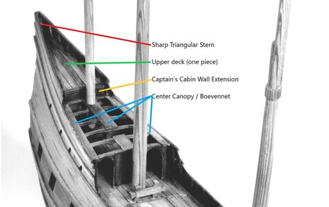

And now I will share with you the nice little predicament that I got myself into. Let's first look at the pictures of @Ab Hoving Ab's and Constant Willems's builds.
Crucial to this part of the build is the height of the center canopy (Blue), the captain cabin's front wall which extends above that (Yellow), the upper deck (GREEN) which angle follows that of the wales and ends in a sharp triangular point (Red) at the back.
The exact same layout on Constant Willem's build viewed from above.

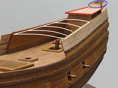

BUT ... this is how the kit's stern configuration looks like:

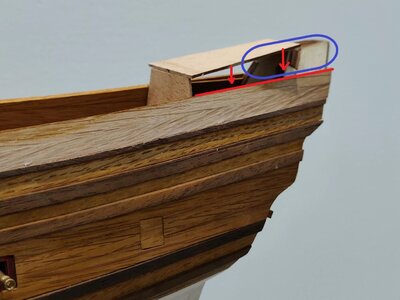

The center canopy I have drawn in white and immediately behind it is the front wall of the captain's cabin with the extension built in. The upper deck though, which is now just loosely placed is the problem. It has to be lowered so that it basically sits on top of or is level with the wales. (See picture below).
But in order to do that AND have the upper deck extend right through to the rear of the ship, means that the portion of the stern which is shown in blue on the above two pictures is in the way and needs to be removed. I really did not fancy cutting that whole part away and then building it up again with no support, but that seems to be the only way.
What do you guys think?

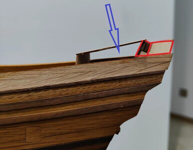

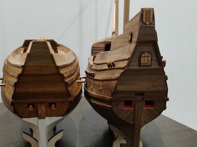

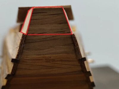

Hi Heinrich, without drawing I will not pronounce myself, I notice that there is too much space between the deck boards (I hope it is the photo).
Heinrich, my friend, that is quite a dractic step that you want to do, and the result will never be wat you are trying to achieve, because of the shape of the stern.
Is'nt it possible to think this over once more, and accept the shape of the stern??
Because if you want to make the same stern as Ab Hoving, and Constant Willems, you have to break down half your ship of Willem Barentsz in order to change the stern's shape.
In other words, if you only bring down that little deck, it is still not what you wanted, but to get wat you want, you are facing a complete rebuild
I would take this for granted if i where you.
I wish you a lot of wisdom in this my friend, you will need it
Wow, what happens to the installed planking if you remove that portion of the stern? Seems like a drastic step!
Jan it is only the portion indicated in red, that I am thinking of cutting away.
It is only the stern planking that will be the lost. The challenge though is going to build up that portion again.
Hello Frank
Are you referring to the space indicated by the blue arrow?
Dear Peter. I will have to accept the fact that I am not going to get the stern to end in a sharp triangle like Ab and Constant achieved. However, the problem is that if I don't get the upper deck to lie flat, I cannot build the ship with the two-level layout (which is the correct shape) either. So, if I keep the stern the way it is, I will end up with a ship that looks exactly like WB#1.
Yes, i understand now that your stern is going to be accepted, in that case you have no choice then to rebuild your stern deck.
Good luck with it my friend, you have a job to do.:eek::eek:

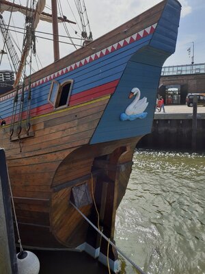

@pingu57 This picture of the replica shows a flat stern without the triangular configuration.
Judging by all the inaccuracies of the replica, this is probably incorrect too - which brings me to a hell of a choice. Do I compromise or stay true to my goal of attempting to build a historically accurate WB?
