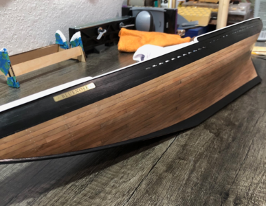

Thank you very much Johan! I LOVE The color of the planking on the exterior of the hull - in essence that finish almost looks to fall in the same color palette range than the CLOU stain I have used on the exterior of the WB#2. However, that might just mean that I won't have enough of a color contrast between the deck and the deck furnishings. The second picture with the semi-gloss finish shows the kind of finish that I think @RogerD and I would be interested in because it is so much lighter in appearance.I'm not entirely sure whether the steamed or unsteamed pear wood is supplied by YQ, but when asked, I would say the unsteamed variety.

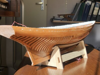

On the starboard hull planking I applied a cherry-colored stain, finished with two layersof semi gloss varnish, the rich coloring primarily originating from the stain. The colors seem to darken a little bit more over time, but it doesn't show the variety of colors @Peter Voogt's model shows.
By the way, the transom still shows the untreated pear.

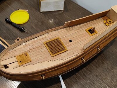

Planking is slow but satisfying. I know it looks like the dog's breakfast now, but this might just work.
good thing about building a Dutch ship is the irregular planking. It really looks awesome. I certainly do not see a dog’s breakfast here Heinrich. Looking fantastic. Cheers Grant

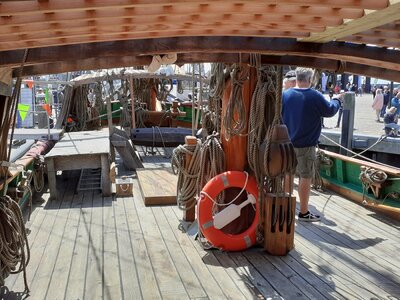

Thank you, my friend! The only yardstick that I have as to the color of the deck is that of the replica. You will see that the "wear" and weathering have had a marked effect on the color of the deck.Good morning Heinrich. I really like the pear wood colour and I personally think going too dark would spoil this. You are in a quandary and I would be too. As you are building this WB authentically do you know what the original shade of the deck where back then? Cheers Grant

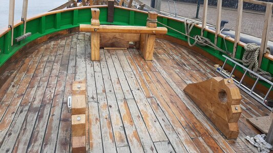

Another detail; in the weathered areas of the deck, the trennels are hardly visible, unless you zome in really close.Thank you, my friend! The only yardstick that I have as to the color of the deck is that of the replica. You will see that the "wear" and weathering have had a marked effect on the color of the deck.
This picture was taken when the deck was still very new. If the whole deck had maintained that "orangy" look, I would have been with using the CLOU stain as is, but after having been in the water for a while and exposed to the elements, we now have this "greyish" tone.
As long as I do not make the deck too dark, the Pear wood should not really pose a problem - in its untreated form, the Pear is quite close to this.
Absolutely, Johan. That is why I do not even bother with those.Another detail; in the weathered areas of the deck, the trennels are hardly visible, unless you zome in really close.
