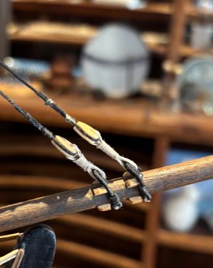

Main stay and foremast shrouds.
The U blocks I had to make from scratch…..not the best I have seenROTF. I have run out of left over kit natural rope so she is now getting some of the good stuff I have in my stock. It makes a big difference.

A nice stay with a nice scratch build block, Grant. And you are a brave man with the lighter ..... :eek:

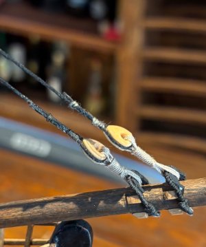

Those U-blocks are really interesting, unique haven't seen any quite like that before. You have an awesome restoration going on!
Thank you Daniel. The British used the U blocks on some of the ships of the line- the Victory had this configuration. The Bounty and smaller ships used 2 “heart blocks” like so : 198690A6-A10D-4E66-A7BA-F3B78C4A1452.jpeg
I did not have enough heart blocks so went for the Victory method on my restoration. Cheers Grant

Main topmast stay with mouse and serving:
Fore preventor stay with mouse, serving and tackle onto bowsprit:

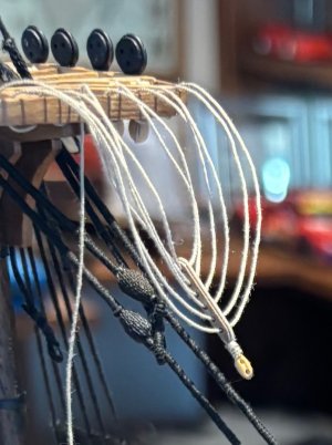

How the crows feet work is being looked at . I will replace this rope with nice rope as this one has been properly abused.

As you can see there is still plenty of “flame throwing” at this left over rope to get that fuzz off.ROTF. it will come good.
