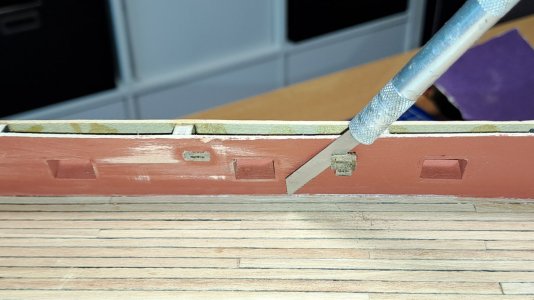

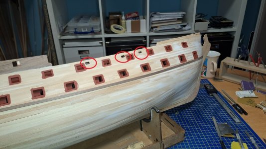

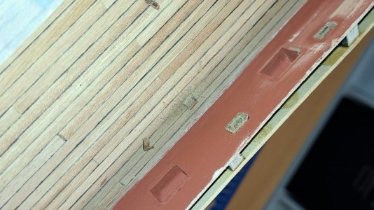

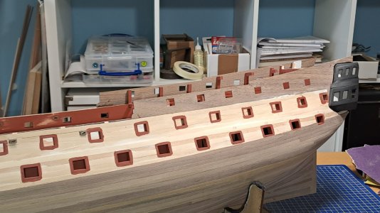

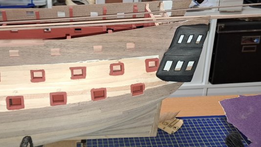

Planking the part above the mainwale.

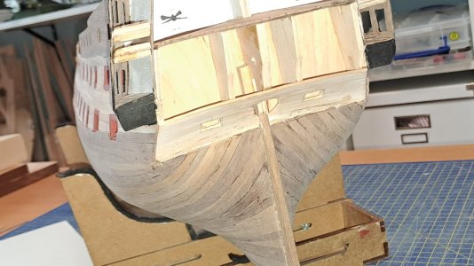

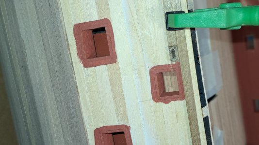

But before starting, I thought it would be a good idea to implement the frame of each Sheave. It should extend slightly above the 1 x 5mm strips so I can sand them flush with the strips later.
The stern still needs some attention: some finishing touches (sanding) and then applying the second layer of trim. Note the openings for the rear guns...I'm going to do something special with these.

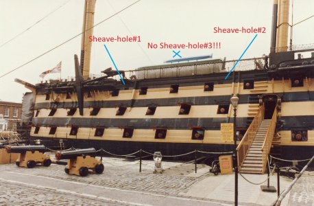

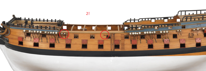

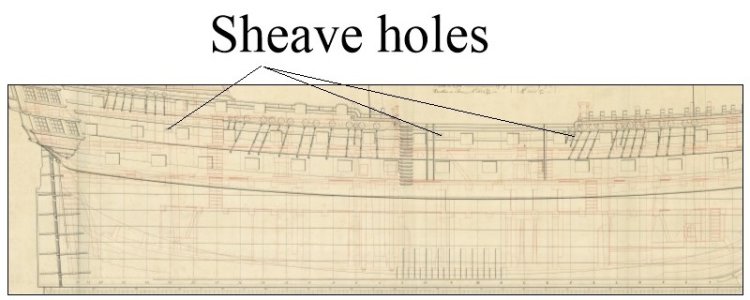

Mark, but the Victory doesn't have a sheave hole amidships either!
There are no English ships with a sheave hole amidships, and there never have been. There were always two sheave holes per side.

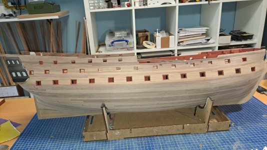

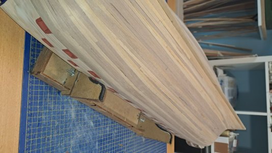

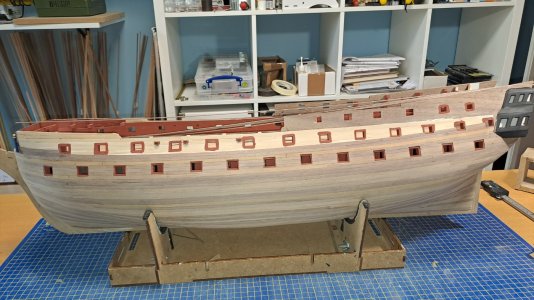

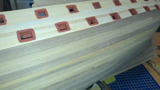

The second planking is almost done! Of course, it was a lot of work, and I did my utmost to glue the strips without any gaps. Then I sanded with 240 and then the main wall... ;)

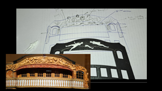

As mentioned, I'll be deviating from the decoration of the stern. I'll be decorating the arch (see Iutar's earlier post) and the area above it, just like the real Agamemnon used to be.
According to my information, three naked Trojan women hold aloft two silhouettes. One of George III and the other of his wife Charlotte.

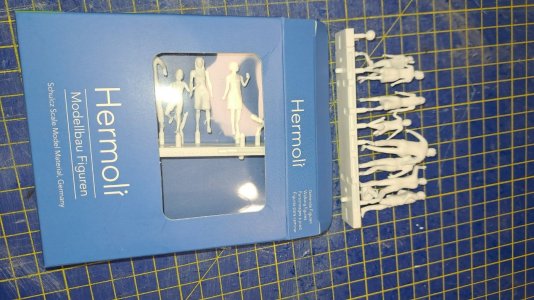

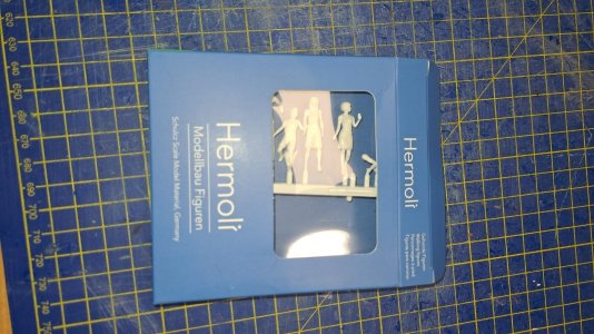

But how do you make those Trojan women? Sculpt them yourself from pieces of linden wood (max. 1 inch long) or think outside the box. Well, I bought a kit of plastic figures like those used by architects. I happened to find one with three women... And the rest: some carving, some CA glue, some tinkering, some sanding, and then painting... Wait and see!

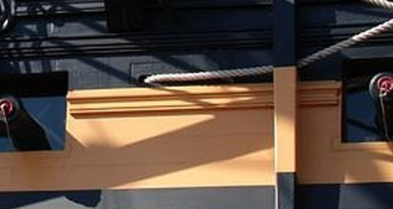

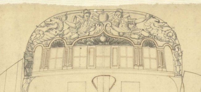

The below is Elephant (74) 1786 (See RMG drawing ZAZ 1070 in low resolution on the RMG Collections website or in high resolution on Wiki Commons website for a clearer picture)

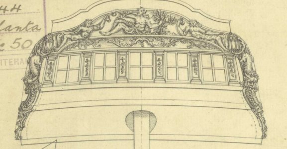

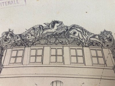

The fact is that traditionally, sculptures on the taffrail conveyed a specific message; they featured specific characters and depicted a specific story, alluding to the ship's name. Each ship had its own unique story depicted on the taffrail, related to its name.
The reason is simple: in those years, ships were built in series and were almost indistinguishable in appearance, and the overwhelming majority of people, especially sailors, were illiterate.
Example: The ship "Pegasus." The sculptures on the taffrail depict the birth of Pegasus from the blood of the unfortunate Gorgon Medusa. The Gorgon is on the right, Perseus, who cut off the Gorgon's head, is on the left. Pegasus strikes an underground spring in the mountains with his hoof. On the left and right are masks of tragedy and comedy, as Pegasus was a patron of the arts.
Another example. The ship "Atalanta." Atalanta is reclining in the center, holding a golden apple in her hand. There is a ribbon on his arm with the inscription "you won".
On the left is Hippomenes scattering golden apples; on the right is Aphrodite plucking these apples from the apple tree for Hippomenes.
The quartos depict the palaces of Zeus and the lions driven from them—everything just as in the legend. In those days, the legends and myths of Ancient Greece and Rome were enormously popular, and anyone could easily recognize a particular myth in the sculptures.

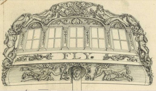

Example: The ship "Fly." Here, the fly signifies flight, not an insect. The ship seems to fly, possessing lightness and speed. The main winds are allegorically depicted on the taffrail in the center, and the gods on the sides. The figurehead depicts Mercury, the god of flight.
Allan, I'm talking about something completely different. I'm talking about the waist! Mark stuffed three sheave holes into the waist, something that had never happened before.

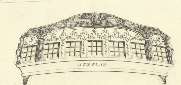

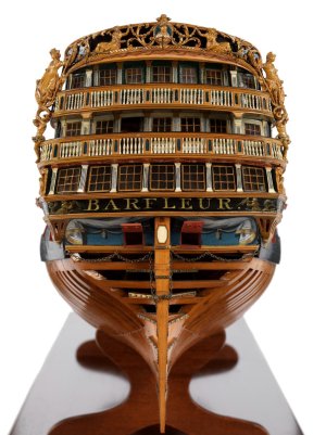

Even if the ship's name was not connected with myths and legends, it still somehow stood out on the taffrail.
For example, the ship "Leopard" had an image of a leopard in the center, "Elephant" had an image of an elephant, and so on.
Pictured: In the center of the ship's taffrail is a scene depicting the mythological creature, Serpent, now known as the Snake.
And what will the sculptures on the taffrail of the bombardier ship Granado depict? A grenade, of course, and warriors in the Chinese style (where the pyrotechnics originated).

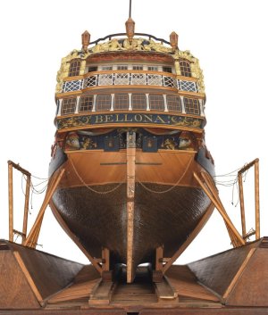

If the ship was the first in a series, then often in the center of the taffrail there is a ball mejon with an image of George III (for example, the ships Bellona, Victory) or his wife Charlotte (for example, the ship Zebra).

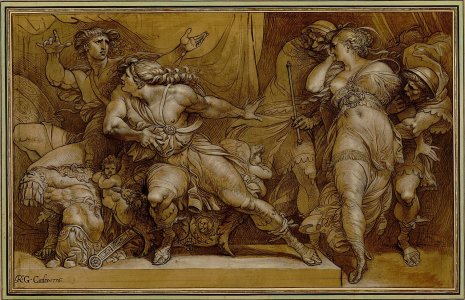

I look at Pocock's paintings and believe that the bust of King Agamemnon is depicted in the center of the taffrail of the ship Agamemnon, flanked by the main characters of the legend about this king. On the left is the king's daughter, Iphigenia. She is turned toward her father, her hands pleading. Under her hands, presumably, is the execution block.
It's hard to see the figure on the right, but it's larger. I assume it's Achilles, of course. Achilles usually points his hand at the king because they are arguing.
These two characters are the most dramatic and memorable in the story of Agamemnon, and to avoid confusion about which hero the ship is named after, they are shown specifically.

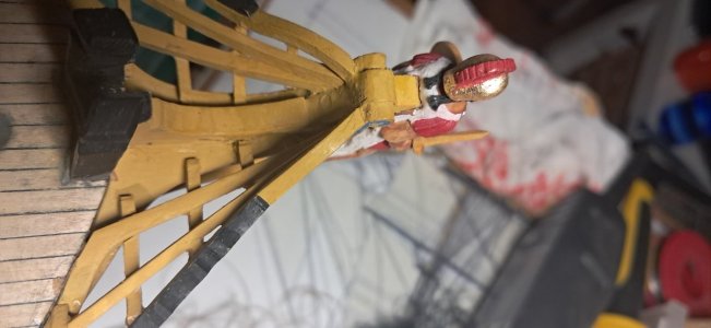

It's clear that the figurehead will also depict Agamemnon.What should he look like? We don't care how the ancient Greeks depicted the king; we care how he was depicted in the 18th century. The classical Agamemnon is of advanced age, with curly hair and a beard. He always wears the armor that was given to him in the legend.

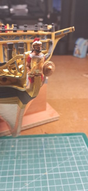

Concerning the figurehead I wrote this in Anthony Deane's "NELSON's FAVOURITE" :
"... his torso covered by a breastplate and his bodydraped in folds of white. He brandished a sword in his handand his dark tresses flowed backward from beneath his golden helmet..."
Unfortunatly, nothing about the stern decoration
The spike foreseen by Cadlercraft must be replaced by a sword

my model :

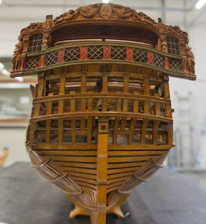

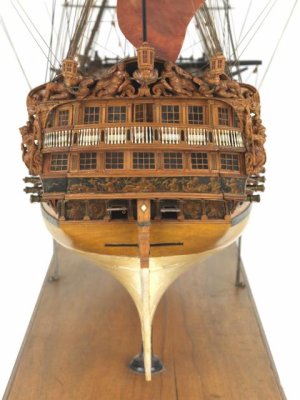

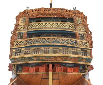

Below is a photo of the original model in the possession of the shipyard that built the ship. Note the red and blue colors.
Although I have no doubts whatsoever about the accuracy of the information, I wrote a letter requesting photos of the stern as well.An original painting of the launch of the Agamemnon is also interesting. See the colors, and especially the stern.
I found also following picture of the launch of the Agamemnon... 2 women holding the picture of George III and Charlotte?
Dear Mark! I know this model. It appears at first glance to be painted according to the rules of the time. It would seem like a relief, but no: the black boats immediately negate the historical accuracy of this model.
