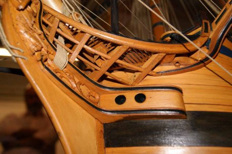

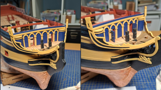

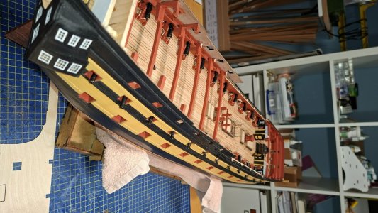

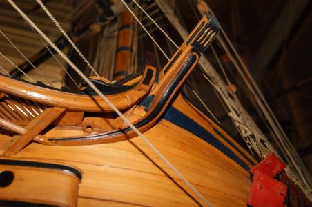

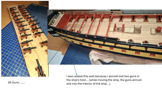

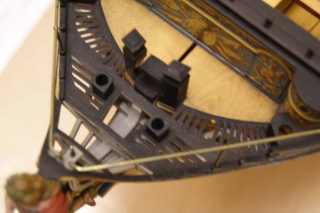

I know I haven't been making much progress lately. But the bow required some precision, and I was constantly consulting photos posted by iutar. Looking at photos of HMS Victory, I decided to add the bow decorations (arches): this was common practice for this type of ship in that period. And then... the guns. 26 in total... sanding, painting, etc. I'm paying extra attention to the guns, which will remain visible on the Gun Deck. I'll finish and wire these in detail. The others are not visible.
Great work!! A very good day as I learned something new thanks to your build log. I had not seen beams and knees painted before so checked the contract for a similar ship/year Nassau (64) 1782 and found that some beams and knees were indeed painted.

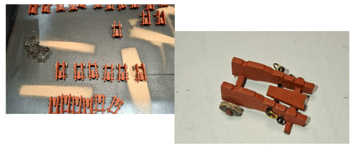

Allan, are you kidding? Of course, all the power components were coated with paint to protect them from the elements! Red iron minium performed the best protection. Iron minium protected wood from rotting, and iron from rusting. Another advantage of iron minium was its high fire resistance.
That's why red iron minium was used to coat the inside walls of gun ports, gun port covers, and gun carriages. It prevented smoldering oakum and gunpowder residue from igniting the wood.
Dear Mark, the wheels were also necessarily red. The wheel rims weren't black because only fortress guns had iron rims. On naval guns, iron rims would damage the deck, so the iron rims were removed.

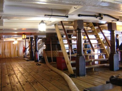

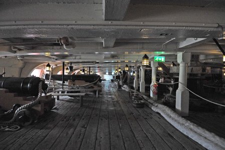

Could you please advice me?

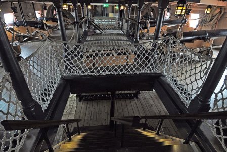

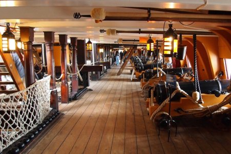

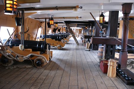

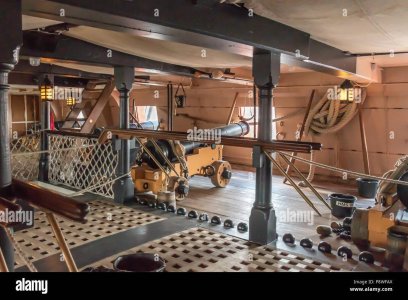

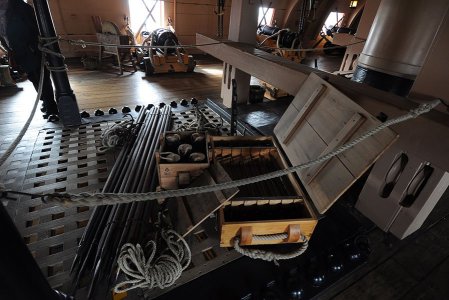

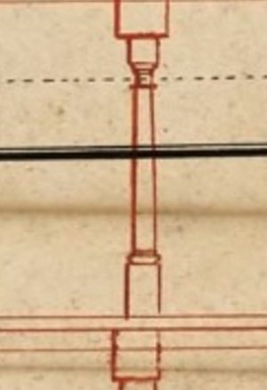

Pages 8, 12, and 15 of the contract for Nassau (64) 1782 give dimensions of the pillars but only the pillars under the quarter deck have any location information in this contract. I don't see anything on the contemporary plans showing the pillars so no help there. I know I have seen information/plans somewhere but cannot think of where.

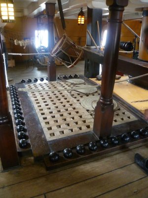

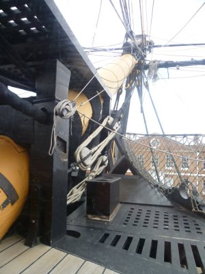

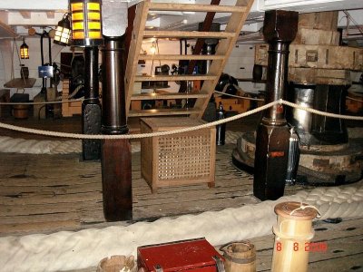

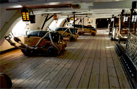

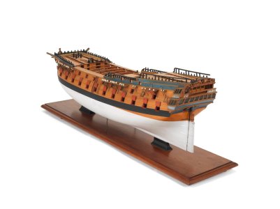

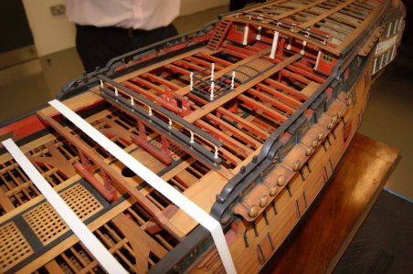

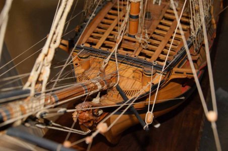

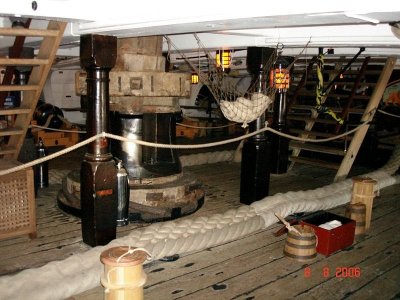

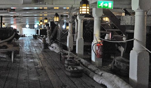

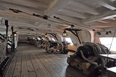

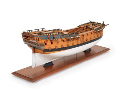

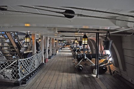

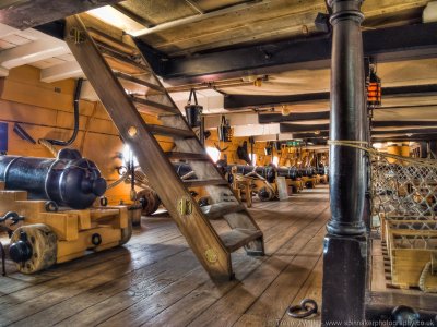

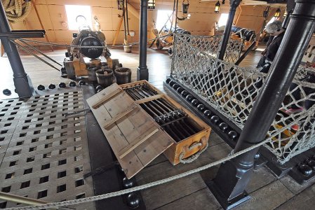

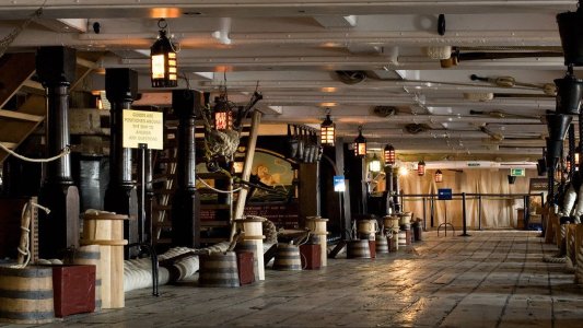

Dear Mark! The pillars on the upper deck support the skid beams. The location of the skid beams is not shown in the archival drawings. This is not a big deal because skid beams were designed to store boats and could be positioned differently on each ship.

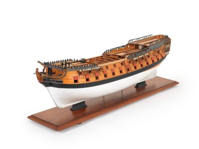

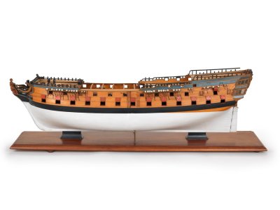

But we have a model of a 64-gun ship from the Greenwich collection. It shows skid beams. If you replicate the same skid beam arrangement on your model, you won't go wrong. Where the skid beams will be located, there will be pillars that support them. The museum model also shows pillars. Follow the Greenwich model.

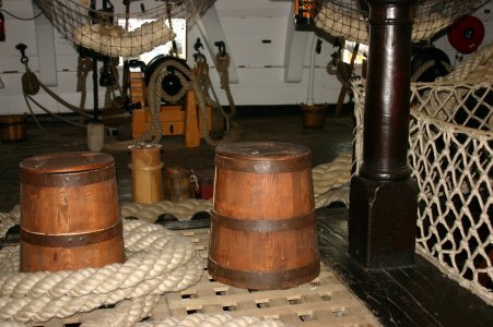

Pillars to support skid beams were usually installed on the coamings of upper deck hatches. If there were no hatches in a particular area, pillars were installed where the upper deck beam ran. Pillars were never installed on ordinary deck planks, to prevent the structure from collapsing. To support the skid beams, the stanchions were thin; to support the deck beams of the quarterdeck and forecastle, the stanchions were thick.
пиллерс.jpg ееоо.jpg z_f9cae6c9.jpg z_8d65ab47.jpg z_0e5ccfa7.jpg y_b93e3dce.jpg y_7c3841ef.jpg victorygundeck.jpg.08564057e05cdcb594bffe3783595f37.jpg StanchionsGunDeck.jpg.137159d4ec257aa418b6b5a56d25fb9e.jpg P1010281.JPG DSC_8956.jpg DSC_8940.jpg DSC_8933.jpg DSC_8932.jpg DSC_8931.jpg DSC_8918.jpg DSC_8917.jpg DSC_8914.jpg 1723861333235.png 1723680833539.jpeg 15526941234_cbab0102de_b.jpg 9461323000_7ea891b3dc_o.jpg

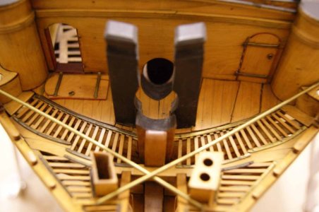

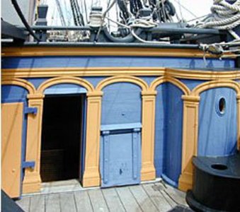

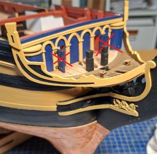

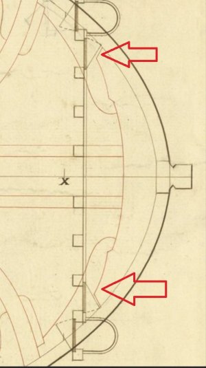

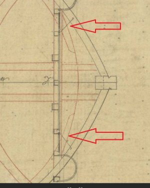

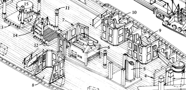

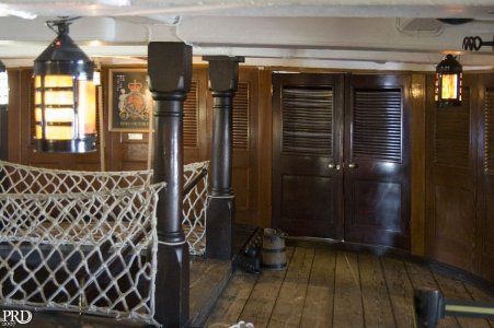

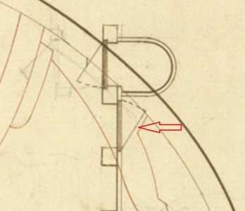

Dear Mark! The doors always opened toward the bowsprit. I've already mentioned this. This was done to prevent waves from blowing the doors open during a storm.
In addition, the doors were located next to the round houses.
двери 1.jpgдвери 2.jpg двери 3.jpg gallery_10197_919_2201.jpg gallery_10197_920_92694.jpg gallery_10197_945_21464 — копия (4).jpg gallery_10197_918_38437.jpg

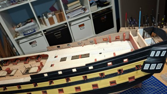

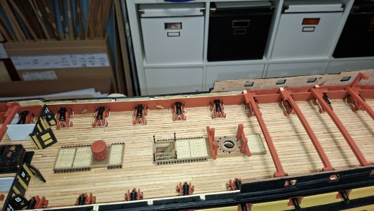

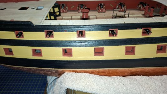

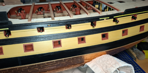

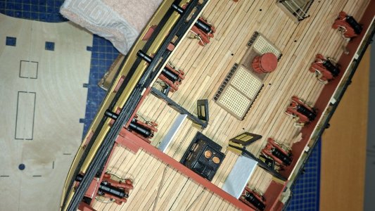

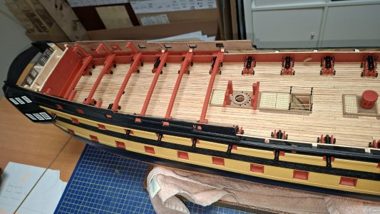

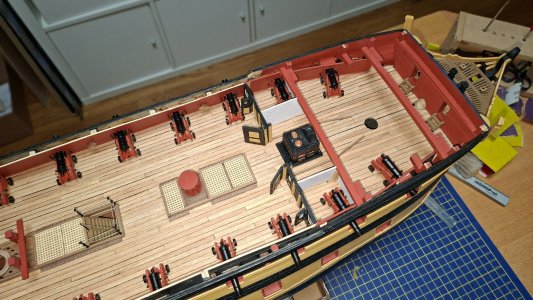

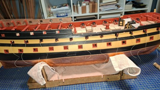

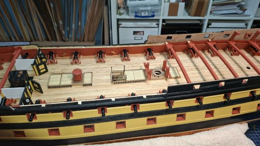

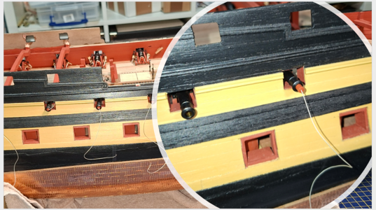

Today I finished rigging the guns on the gun deck. And as you can see, I also glued the main deck.

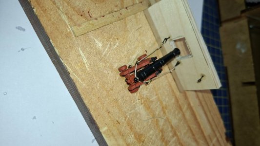

An interesting detail for you: I fitted the guns with a "plug" with a cord that allows you to remove the stopper. According to my information and photos, they were originally installed to prevent seawater from entering the barrel.
I also measured the planking on the main deck, taking into account the curvature of the hull. Tapering will be necessary. I calculated that I'll start with 4 mm and end with 3.125 mm. So I'll sand the strips neatly...
