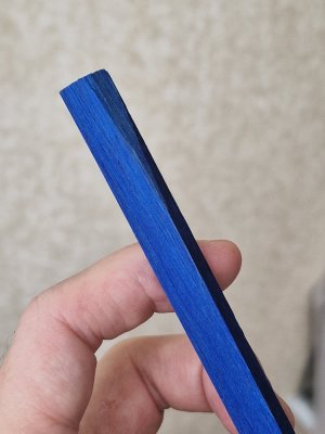

Thank you for your high rating. The answer to your question: yes, it is painted hornbeam wood. Black and blue hornbeam (or any other) is paint that is vacuum-painted through the wood. That is, wherever you cut it, it is the same color everywhere. This is very cool, since it looks like it is not painted, but the color can be any, even unnatural. And you can cut blanks of any shape.
By the way, I am surprised that only you paid attention to this color. I really liked it, and especially my wife.:p I was sure that there would be a lot of talk about this color, but no:oops::D

I have seen wood in the colours yellow, red and blue (dyed maple). You are right, there are colours that do not look natural. This is not the case with your colour. The blue doesn't look artificial. I would like to use such veneers for my Athena. However, this requires absolutely precise processing. In other words, there must be no glue leaks and, of course, the planks must be lined up correctly without large gaps in between. I haven't dared to do that yet ... But maybe I need a little more time.
Your construction method is very accurate and impressive. I am a fan.:DThumbsup

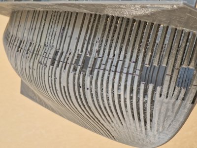

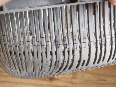

5.4 Racks (creating and pasting port racks and railings into plastic hull).
Small changes. I thought this process would be quick, but no.

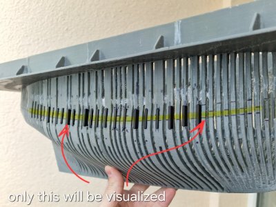

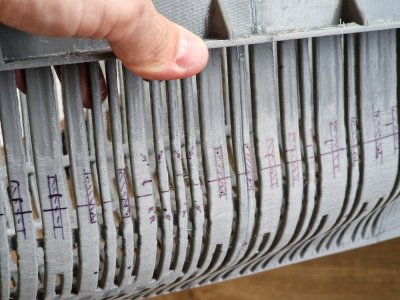

A lot of time was spent on marking ports and railing racks.

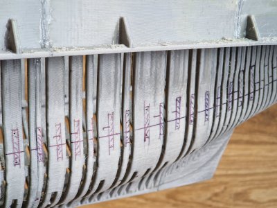

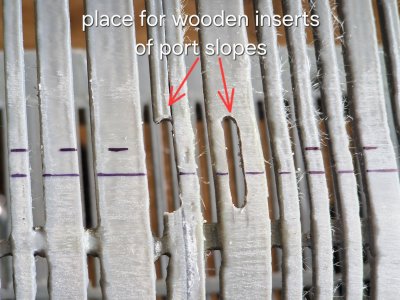

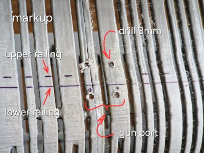

I made one port for the test. I drilled the edges of the port with a 3 mm drill and then made holes along the port slope pillar and connected the holes in one line and polished them a little with a file.

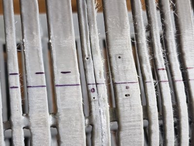

When I saw that everything was working, I made all the markup.

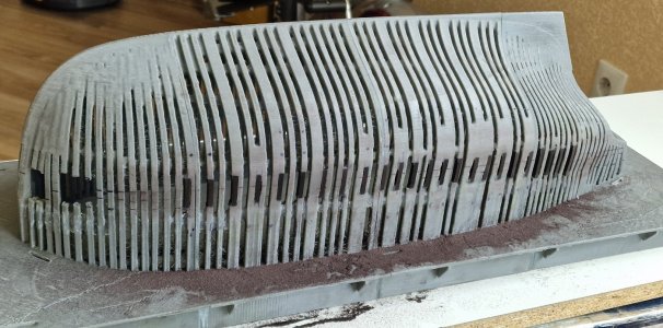

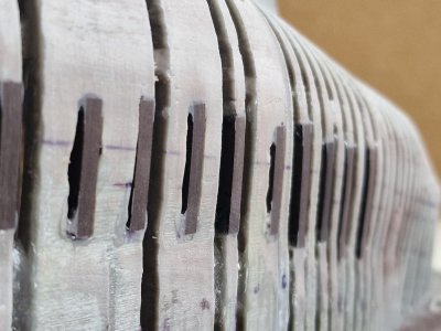

Then cut slots for all railing posts and ports on one side.
It turned out to be not so easy. Plastic is durable and viscous. When drilling, it melted and adhered to the drill.

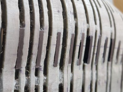

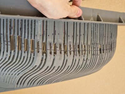

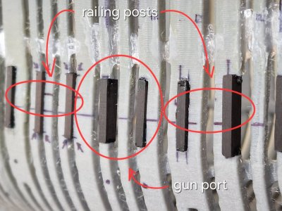

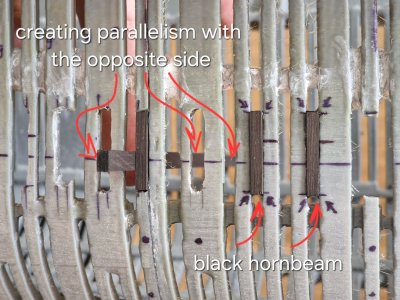

Then I cut 3x5x20 blanks from black hornbeam and pasted them into the grooves. At the same time, I checked the parallelism with the opposite side with a rail. That is, 3 mm will be the racks of railings and ports, this is their width, and in front and behind I will grind flush with the body.

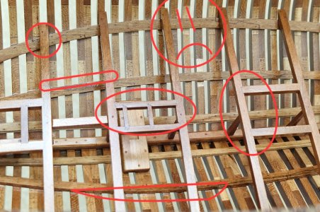

By the way, many racks according to the set plan did not correspond to the drawings in anatomy. On this case, I corrected this so that the distance between the racks was almost equal, and not so that the racks were at different distances from each other (in inter-port spaces).

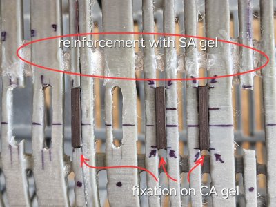

Glued everything to the CA gel, they also reinforced the free-standing plastic frames from above.

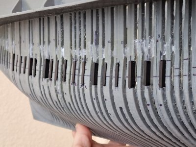

Pasted all the racks of black hornbeam. (then there will be pear inserts on the front).
Although the workpiece that ports that posts the railing 2 cm visible will be only 5-6 mm, this is the distance between the upper and lower railings. And therefore, it will be seen from this entire case only this line.

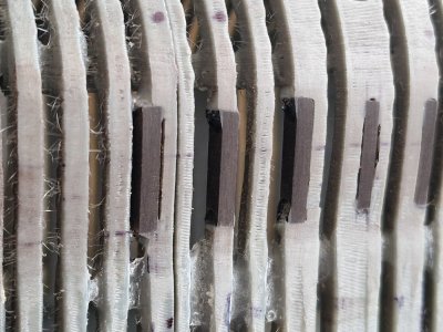

The final chord was the grinding on the outside and inside of these inserts.
At first I was worried that the hornbeam would be difficult to grind and the plastic would grind faster, but no! The plastic turned out to be much stronger and the wood was easily polished along the contour of the case.
Just as simply, he was grinding from the inside. There is no photo, but even there everything is on a par with the body, which was very pleased, so you can safely do the same from the other side.
And plastic did not clog the texture of the tree, rather, on the contrary, black dust from hornbeam was everywhere...
In a word, I am very pleased with the result and you do not pay attention to the texture of the plastic, its leaks, irregularities (and in general, the case is dirty from printing costs), but I repeat... that only a few dozen wooden inserts will be visible from the entire case, and the plastic itself will be all inside under the skin!
So, a start has been made... let's go further!
