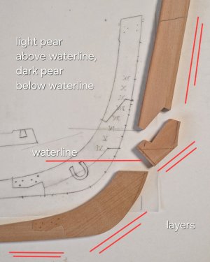

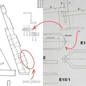

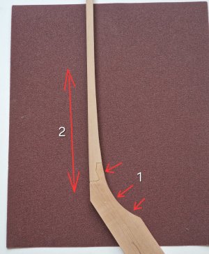

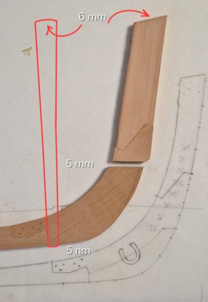

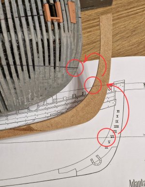

the steering wheel will have a rounding on the leading edge.
Hi Sergey
Assuming you mean the rudder, it's interesting that the leading edge, or bearding, was a separate piece and the bevel changed over time, at least on British ships. I have no idea what it was prior to 1650, but according to Goodwin it was only 30 degrees from 1650 to 1720, after which it was 45 degrees. This angled (not rounded) piece of elm or fir went from the keel to the point where the sternpost terminated at the top. A piece with similar angles was fayed to the after edge of the sternpost. Some builders like the use of a different species of wood even on a model to show it more clearly. Were there exceptions on these angles?? I would not be surprised if there were, as there seem to be exceptions on nearly everything before the use of computer controlled manufacturing . Looking at a chart of dimensions for the pintles and gudgeons given on page 130 of The Construction and Fitting of English Ships of War, it appears the gap between the rudder bearding and matching piece on the stern post is about an inch.

Although the kit is quite good, it also has many omissions, inaccuracies and simplifications. But that's why we are modelers, to fix all this. ;)
Hi Sergey
I also asked myself this question, but the anatomy of the Victory and Alert clearly shows that the leading edge of the Alert was not separate from the rudder, but one piece. In the picture on the left. But unfortunately, except for the top view of the hinges, there is no section of the rudder itself. But on the Victory you can see that the rudder was rounded, not beveled. But the hinges were just beveled, like the sternpost. In my case, I implemented this closer to the rounding, but with a small protrusion in the middle. Here, I will most likely do the same. At this scale, it will not be clearly visible and can be interpreted both as rounding and as beveled. To guess for sure.:cool:

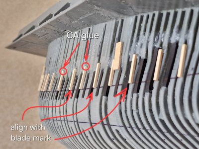

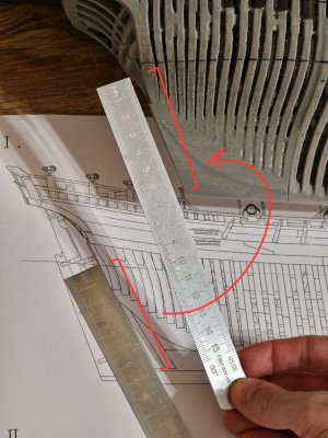

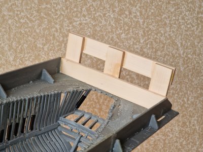

I have been racking my brains for several weeks now on how to implement the railing posts. It is very difficult to explain what exactly I want, but even before yesterday I wanted to pause Alert and return to Victory, since I had reached a dead end. But today I spent about 5 hours doing calculations and finally came up with an idea with posts (toptimbers). On Monday I hope to be able to start implementing these ideas.
I will first try to do everything on the second hull and then decide whether to repeat on the first (although maybe I will do it as per the instructions with some adjustments).
But still, it was painful when a solution does not come, or a difficult solution comes, the implementation of which is difficult, and when today the epiphany came - I felt relieved.

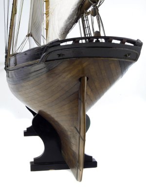

Thanks Sergey. The Alert was small so a rudder without a separate bearding piece makes sense, but I would be surprised if it was not a separate piece on Victory. Even on a smaller ship (74 gun of 1780) the contract describes separate pieces.
To be well made, the Pieces tabled to each other, and all but the Main and Bearding Pieces, to be Fir.
It could be both styles were used on different ships. Looking further at some contemporary cutter drawings the forward edge of the rudder/rother is shaded to appear to be rounded as you show. The drawing above in post #422 on the right looks a lot like the one by Goodwin except Goodwin does not show a rounded rudder. In a contract that I found for a 10 gun cutter bearding is called out on the rudder but it does not describe the shape or if there is a separate bearding strip. (The contract is from 1810, well after Alert so may not be at all applicable.) Again, I would be surprised if there were not variations from yard to yard on how they made and shaped the bearding. No matter, I love your build :)

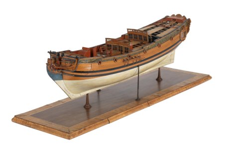

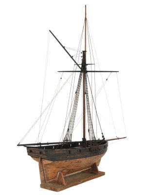

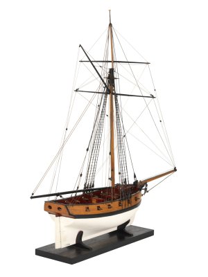

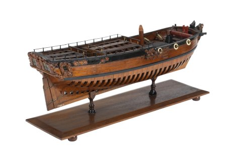

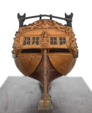

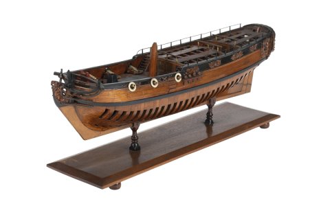

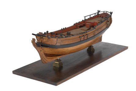

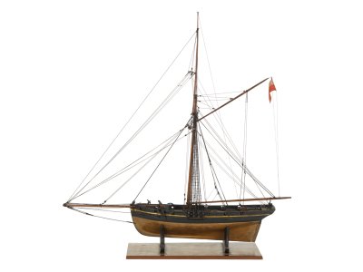

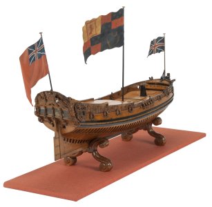

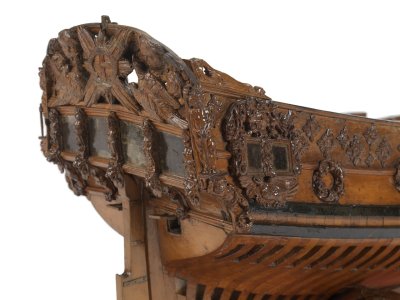

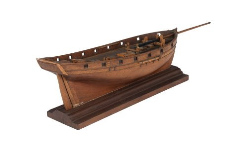

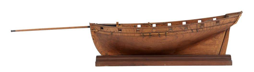

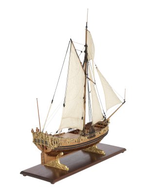

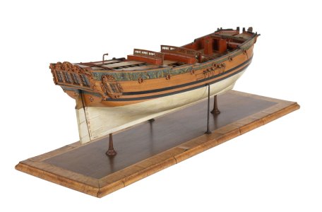

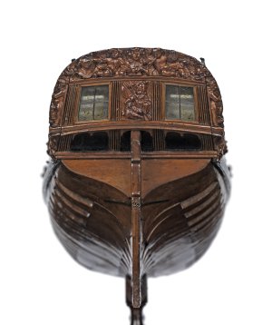

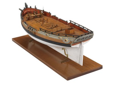

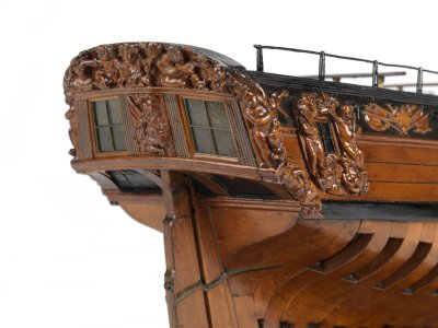

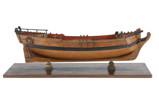

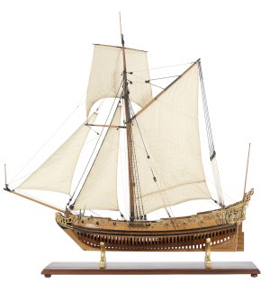

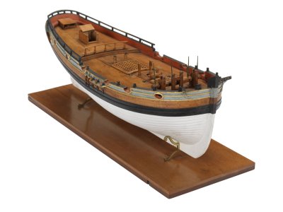

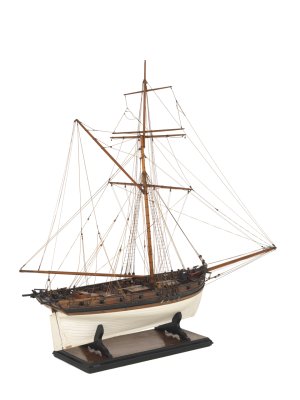

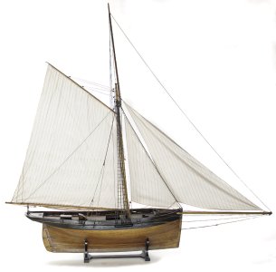

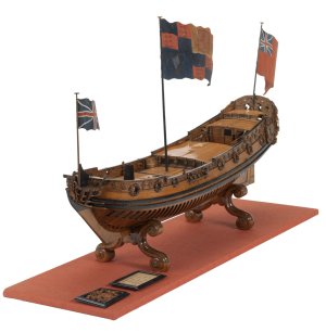

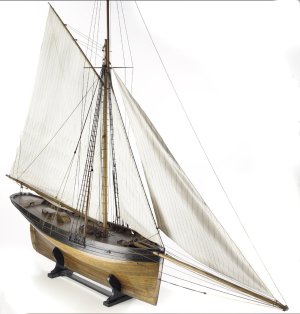

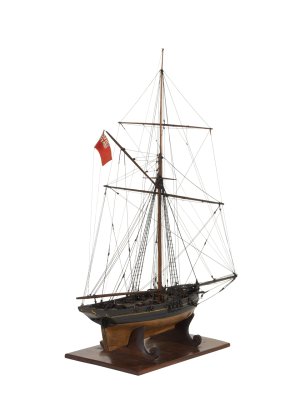

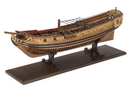

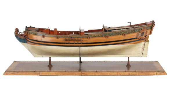

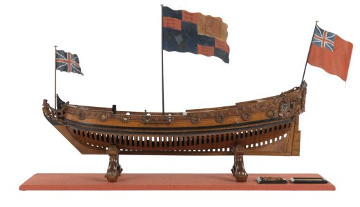

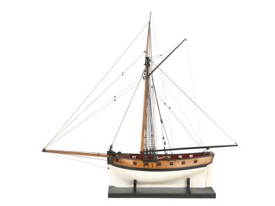

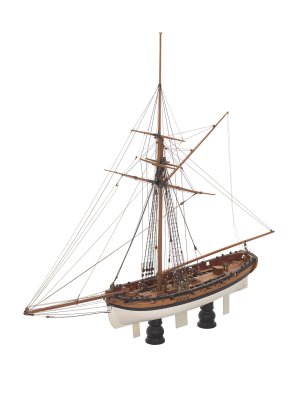

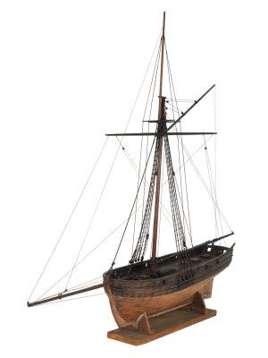

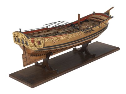

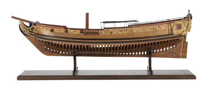

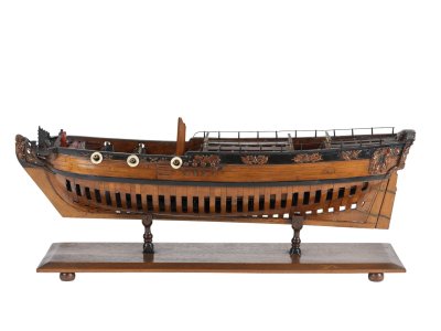

Today I was processing the material for the second building Alert. This is a pear of several shades. And the downside is that I could never find a pear of uniform color. In terms of wood layers, it differs significantly at the transition points. I will talk about this later and show tests.

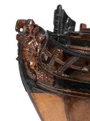

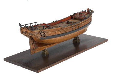

But in parallel, I look through museum specimens to understand how much I shaded this pear with bitumen. Since bitumen can partially hide, or rather camouflage the transitions of pear shades.

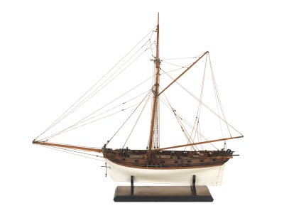

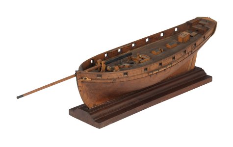

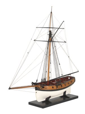

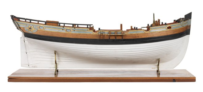

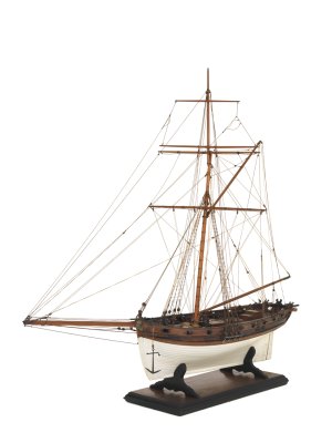

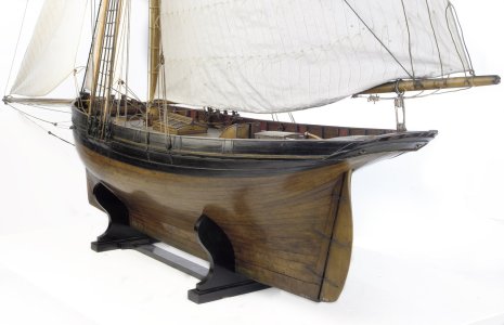

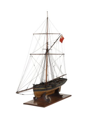

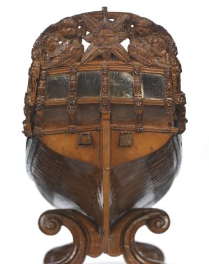

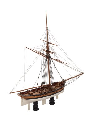

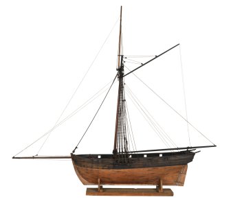

And so I reviewed the entire website of the Greenwich Museum... all 130 pages, 24 exhibits each (by the way, here is a link to GoogleDrive, where I saved all those models that I liked the most, only 470 photos of different ships, different ranks from boats to sailing battleships)...

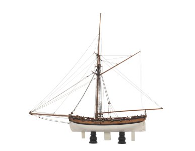

And in two posts I will share models (small ships, cutters) that will be references for me in further visualization of my model. Plus, in the photo you can see the elements of decor, rigging and so on.

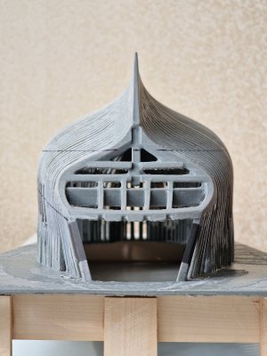

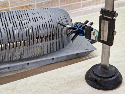

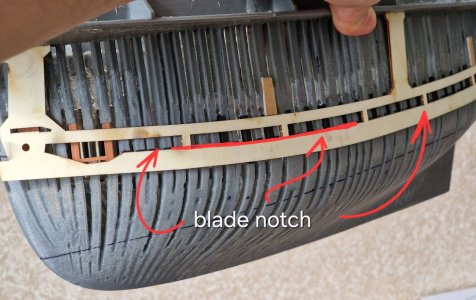

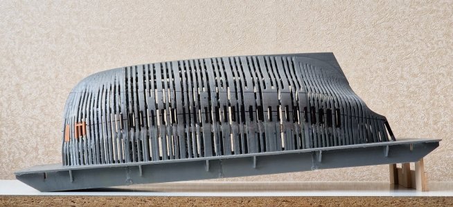

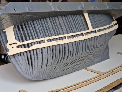

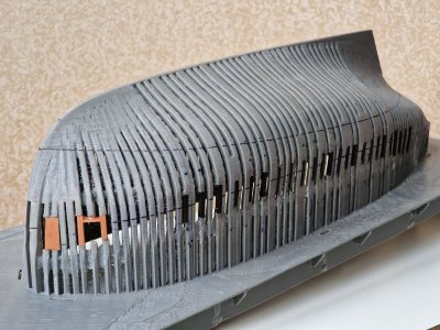

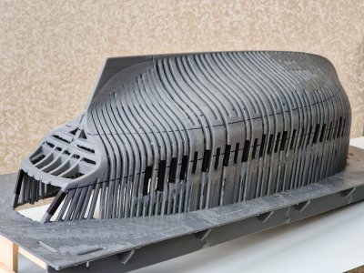

Today I thought that I would show the first experiments and work on preparing pears for cladding, but no...

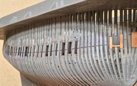

Today, the whole day made miscalculations and devices for applying KWL (waterline) on the ship.
To be honest, it's very tiring. It's one thing to do everything according to the instructions from the kit, and the second is to calculate and reinvent the wheel... well ok.
So, to apply a waterline, you need to know the two starting points, front and back. In front, starting from the drawings, I transferred it using a temporary keel...
At the back, I just measured with a ruler in a straight line between two points.
Then I had to create a frame to fix the angle of inclination of the case. To do this, I used this tool...

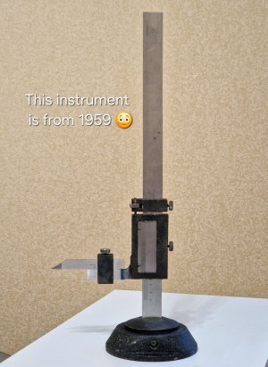

... who is more years old than my father... This is "Stangenreismas" made in the country in which I was born and which no longer exists (praise to the gods). I bought it for $25.
So, using this tool, I lifted the back of the case so that the points of the waterline at the back and front were at the same height. To do this, I glued wooden slats on the front...
... first one rack, as a base, and the second glued to it when the front of the ship was exactly at the desired height. I just passively put this rail on the table and it fixed the desired height.
I propped up the back with dumbbell pancakes and similarly glued the base rail, and then 3 supports to it and passively the bottom rail, fixing the height.
There is not much beauty in this, but it accurately and reliably holds the desired angle.
When everything was ready, I attached a marker to the device and drew a waterline.
This is not the final application of KWL, but rather an introductory one, since when lining with slats, the waterline will be cut out with a scalpel, but more on this later.
Well, so... overall, I'm pleased. I noticed that the conductor, to transfer the cut line of the hull - not symmetrical. I thought the waterline was not applied correctly. But I checked and could not understand why my eye was not satisfied.. But it turns out that the lines from the conductors on the right and left are not the same everywhere...
THEREFORE, the recommendation to all those who will assemble this model is to use one conductor on both sides! You just need to redraw the notes on the back. And if you make everything with one conductor, then the lines on the two sides will be the same. (I'm talking about this conductor, photo below, I have already shown it before).

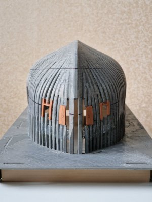

My whole process has completely stopped... The first hull is drying after being coated with oil, and I can't start the second hull because all the wood I have (light and dark) is striped and I just give up... I don't want to do anything anymore...

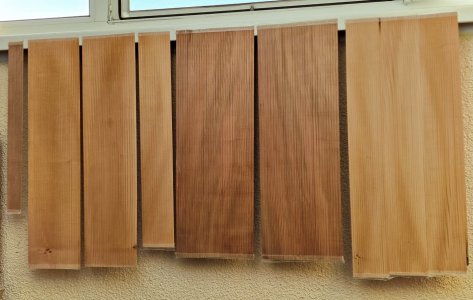

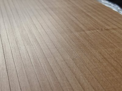

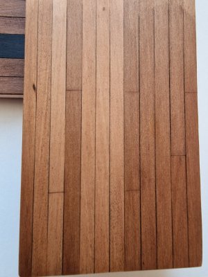

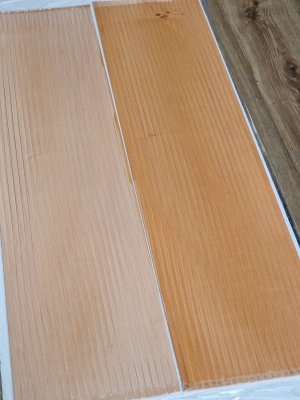

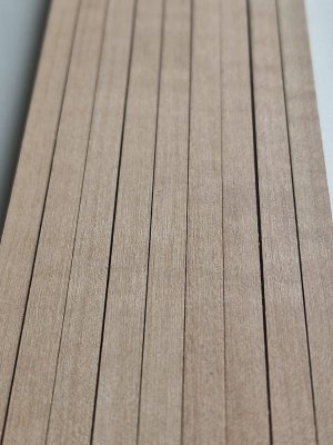

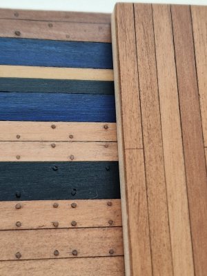

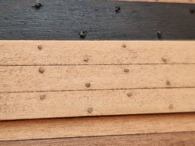

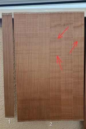

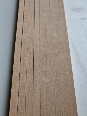

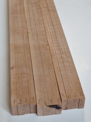

As promised, I will share my experiments with wood, coating oils and bitumen.
And first, let's talk about my headache - this is a search for a pear and disappointing results.

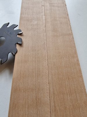

As I have previously shown, I had a light and dark pear...

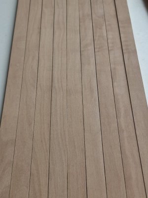

... I cut it into slats with a margin because I guessed that the color might differ and I would need to choose from the resulting ones what would be combined in color.

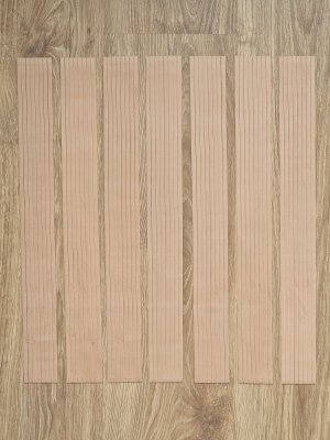

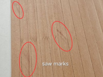

Earlier I showed the probes, but they were made of separate slats, but then an unpleasant surprise awaited me.
And he was discovered after I polished all the sliced slats. Again, I guessed that the wood might not be uniform, so I laid it on a flat surface and sanded one side to 240 with sandpaper.

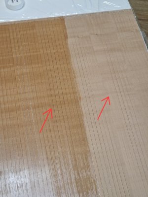

This eliminated the saw marks, which camouflaged an even greater problem than the marks themselves.

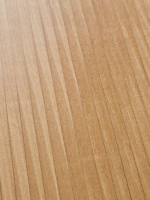

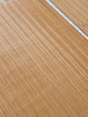

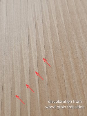

When the surface was flat, I saw my concerns - these are very noticeable color changes through the diagonal stripes.
The last hopes that everything will be leveled with oil fell after I applied tung oil...
Color changes have become even more noticeable...
Among all the disappointment, the only relief was that it all showed up NOT on the model but on the table!
As a rule, wood is not polished into an ideal and oil is not coated, but this is done on a model.... but. I build a boat and its rails overlap, which suggests that they should already be ready before plating. It saved me. And even more so, I noticed on the probes that if you do not polish the entire surface, but somewhere there will be a mark from the saw (gloss), then there will be spots from the oil coating, as can be seen here.
By the way, not only were there problems with the light pear, but the dark pear was also not uniform.

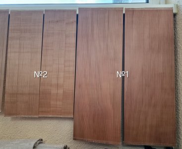

Well, here, the result of several days of work... and my disappointment...

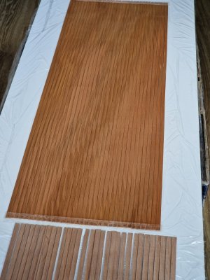

And in order:

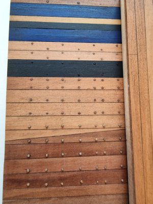

- 1 on the left - this pear is homogeneous, dark (it will be on the deck with single breaks separating the main light color). There are no complaints about her.
- 2,3,4 on the left - light pear on board to the waterline. Not homogeneous, but it is with a margin, therefore (running ahead) I will try to select from the whole one that will be as uniform as possible in color and there will be no diagonal stripes of sharp color transition.
- Dark in the center - I haven't decided with her yet. There is an alternative, but I don't really like the color of that, as for the skin and it is all in knots, because there will be even more waste. I will try to sort this one out and combine it so that there are no strong transitions and lines, but I'm not sure about that yet.
- The light right is the biggest disappointment, since it will definitely not fit on the deck with such stripes and heterogeneity... Therefore, the question is very open with her! As possible with dark, but with dark I will try to come up with something.
This sample shows the diagonal stripes that I talked about. I specially made them on a probe to try how it will look after coating with bitumen. But something tells me that nothing will change and the way out is to manually select each rail to eliminate all defective areas.

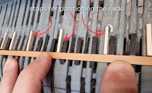

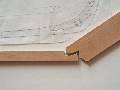

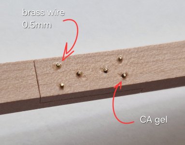

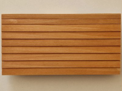

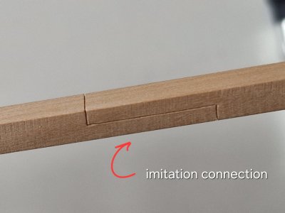

Probnik still did to test his method of overlapping the rails, but more on that later.

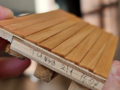

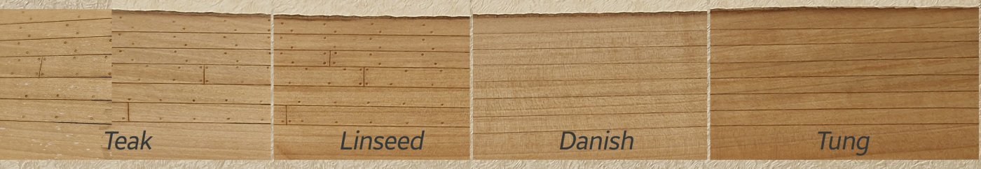

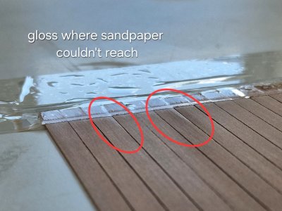

A few more words, why again chose Tung oil, although it dries for a long time and there is a smell all this time... the answer is its color. Compare...
(Click on this photo to see the original.)
On the teak (left), spots of glossy film are visible, and this often appears when coated. And like Danish - it weakly manifests the tree. Linseed oil gives a yellowish tint, but Tung oil gives a slightly reddish-yellowish tint of beige. I like this shade the most.

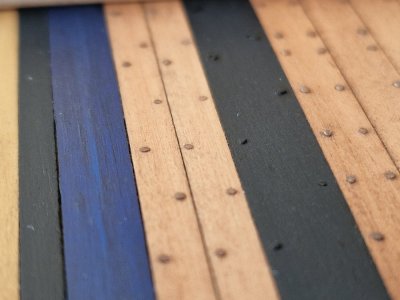

Well, finally - bitumen. Attention! This is not the final version of working with bitumen. This time I wanted to age the wood as much as possible to check if bitumen could shade all the unevenness of shades. You will see Ruzultat. So, with bitumen, I will still try repeatedly until I see the result that suits me. I tried different methods. With two brushes I didn't really like it (maybe there was a strong concentration), I still need to try. But with the method - application and immediately remove with a napkin - I liked it more, but again I need to try everything, and I will still talk about this and show it in detail. In the meantime, here are the first cursory tests to check camouflage for uneven pear color. A few macrophotos... (and remember, this is a probe, done in haste)))
It is almost impossible to convey color with a camera. I tried to... next time you need to take not a phone but a demon SLR camera, you may be able to show the true color.
The verdict...
Part of the pear - in scrap!
What I keep - need to combine and select very carefully.
The search for pear actively continue.
Oil - Tung, bitumen - I will test further, but I think it will look great.

First, I cut from this workpiece (15x35mm) into 4 smaller sizes (6x15mm)...
And this is what NOT the front side looks like.
And so the front...
... and it seemed, bingo, I found a uniform pear (dark at least)...
But when I cut these blanks into slats (1x6mm), I already slightly suspected the return of the problem...
Although in dry form it is practically not visible.
But here's when to cover the surfaces with oil after grinding:
Transverse bands on the wood structure are visible. They change their visualization depending on the viewing angle. But mostly always visible and strong!
I don't know how it will look if you place the racks in a stir, and if the racks are on the curved surface of the case, but something tells me that the problem will not go away, but I hope that somehow I will be able to figure it out. There is still hope for bitumen, but they tone the same at the same time, so these stripes can still be visible.
The point is that when I was preparing all these rails (2 but photos), I thought it was the same pear as 1 (pictured above). Perhaps it is and just the color has changed in a week after drying, but this is not for sure. But unfortunately, I do not remember that a week ago pear 1 had such stripes, but we will check in a week.
Of course, motivation is not added with these "dancing with a tambourine." 4 days I tried on these rakes, but so far I'm not sure about the performance.
Okay, for now let's see what will happen after drying out and after testing with bitumen, but for now I continue with the hull.

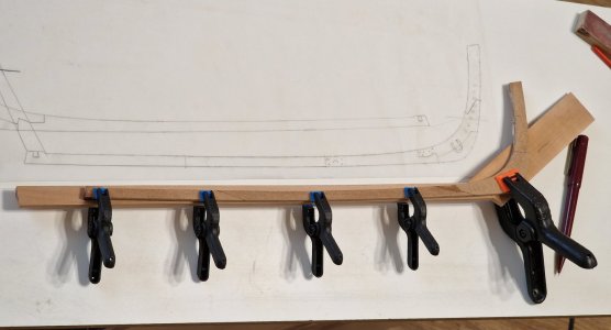

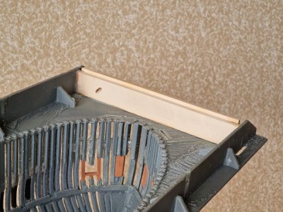

As I mentioned, I used one template to draw the cutline, because the second (from the opposite side) was slightly different.
I scribbled a groove with the blade, as both the marker and pencil left a large mark, and the blade gave less error.
Then I'm under magnification (with binoculars, by the way, I constantly work in them, both in dentistry and in a hobby)... fitted a wooden rack to this blade scratch, a kind of plating stop.
Glued these stops only from above on the CA gel, so that later this place was clean after dismantling these stops.
Well, in this way I will glue the slats to the body, repeating the correct bend.
But I can't glue yet, since the dark lining slats are not ready (dry, if they work at all).
Keel for the second hull, version No. 1.
Depending on the choice of a dark pear below the waterline, a pear will be selected there for the keel. I will share photos of the first version of the keel, although with more confidence I will redo it. But from my mistakes you can learn something.
So the first omission is the combination of these two details.
Tip number 1 - start with the most difficult knot and do not cut anything to the sides, leaving a stock of material. When adjusting connections, you will have the opportunity to move the part and then trim everything around the perimeter if the connection is perfectly done.
Tip number 2 - (here I missed it) if there is time and desire - do as it should be according to the drawings. I did as in the photo above, although this connection looks like this:
I got lazy and did like in a set... yes it's easier, but then I thought and realized that no.... It's easier to do it right, and later I think I will show how I did it.

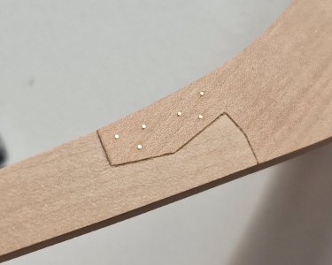

I then used the temporary keel as a template and drew the inside line.
Then cut off all unnecessary (1) along this line and ground the keel on both sides (2).
Next, I made a simulated connection with a scalpel.
I have not decided yet, but most likely I will do this process differently. I will most likely cut the imitation with a blade and then fill the seam with TiteBond II glue and then grind it flat. Because after coating with bitumen, the gaps from the blade will be very colored, and I have not yet decided whether I need it, or it is better to make the seam with a strip of glue...
Next, I drilled holes and threaded 0.5 mm brass wire into them. And on top I glued CA gel...

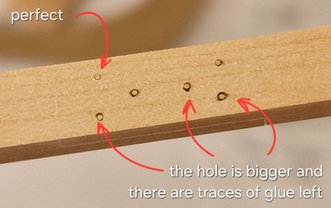

But after grinding, I realized my biggest mistake...
So, what was my mistake (I regret that I did not try on the probe). Since I do not have a vertical drilling machine, but just an engraver, I could not achieve perfect perpendicularity of drilling. And the holes on one side were accurate, and on the opposite side they shifted a little. Therefore, I tried to return them to their place, and thus the hole increased, and after the glue got there and after grinding, a black halo appeared around the wire... It's like for me - marriage.
Therefore, there is a solution (if there is no vertical drilling apparatus). You need to drill holes not through, but on both sides a little less than half the depth, and thread the wire on each side. Thus, you can accurately and accurately drill even holes in the marking and after grinding it will be like this.
This, as you understand, is Council No. 5.
Next, I made two parts of the upper part of the keel.
The direction of the wood fibers is clearly visible here. And the waterline separates the two colors of the pear: dark and light.
And since the keel to the attachment of the barbells became a little thicker, I will try to embody this in the keel of the second case.
But that's not all... later I will show how I will further improve the keel and it will look even more interesting.

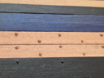

In the meantime, I'm thinking about which option to choose for the hull trim below the waterline...
No. 1, with spotting or No. 2 with transverse stripes.
And I am more and more inclined to the first option, since over time, in 11 days, the pear oxidized a little under the oil, dried out and the colors no longer differ so much... wait a little longer. But from option No. 2, the stripes will not leave, since this is not a color but a structure, and these stripes change their position from the angle of view... and here even bitumen will not even align the color, which may help with the first option...
There is of course another option (No. 3), I have not cut these rails yet (only for the probe). But the colour is less my thing there and there's a lot of bitches, not sure I can do anything about it. So, I'm at the unraveling, and depending on the pear that I choose for the skin below the waterline - the same keel will be... And time passes, and I have already spent 4 days on the second option... and while the result is NOT satisfied...
One hope for bitumen. I will make a probe on two options and then I will decide, but for now...
