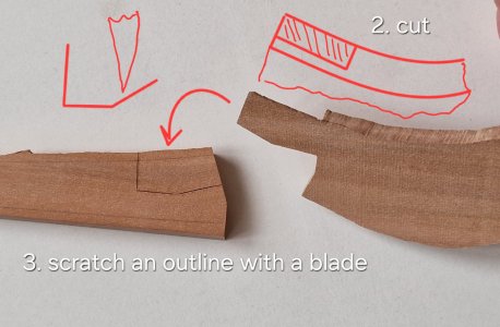

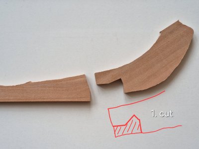

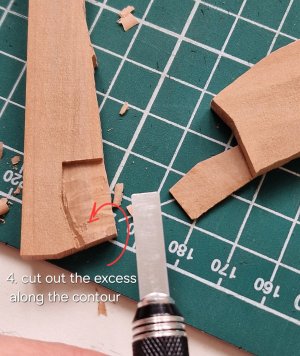

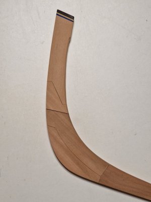

At first, everything is practically as in the first versions, but we cut it off only from a small part.

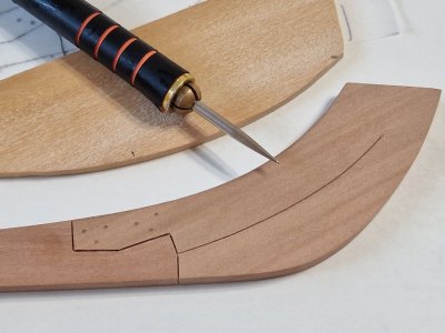

Then, in the same detail, I cut off the excess and scribbled a contour on the second detail with a finished profile...
Well, then cut out everything superfluous from this detail. Here the principle is simple, we prepare one part, we make a second one according to it, and the only visual connection will be the contour that we scribbled, so I made sampling (4) in excess, without bothering, because all the voids will be occupied by glue.
The main thing is to set everything straight. And do not cut everything along the contour until all the details are adjusted.
And here is the result after drilling holes from both sides! To perfectly achieve the correct arrangement of holes on both sides (if there is no vertical drilling device). That is, I drilled holes in a pattern on each side and inserted wire there on each side and glued CA gel over it. (shown above). And after grinding, I really liked the result.

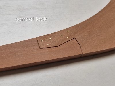

I also liked the right lock. And as I expected, it was not difficult to manufacture.
I get straight high from this lock.

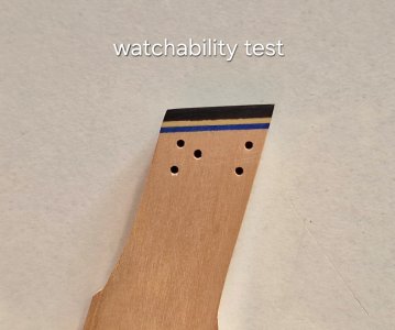

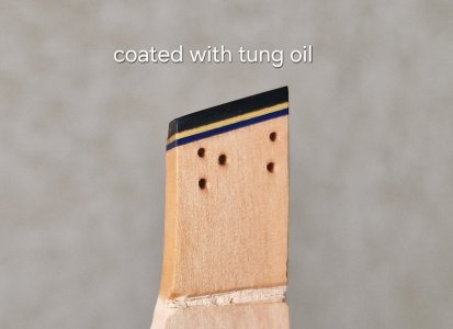

Well, this is a sample of the top of the keel (stem). I wanted to design it in the color scheme of the entire case. And I also really liked the result and I will do the same to the original.
(the sample was hastily made and covered with tung oil to see mostly the color and arrangement of the lines.)
I think one more day and I will finish the final version of the keel (second), which looks much better than the first (and the option from the set too!).

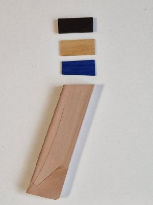

I continue with the keel...

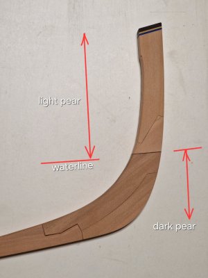

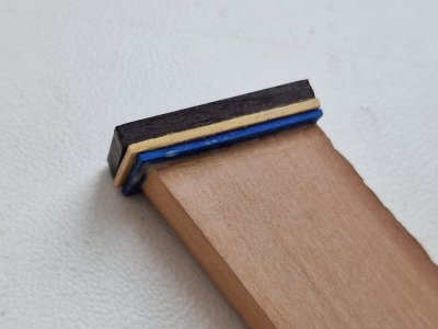

By colors: black hornbeam - boxwood - blue hornbeam - light pear.

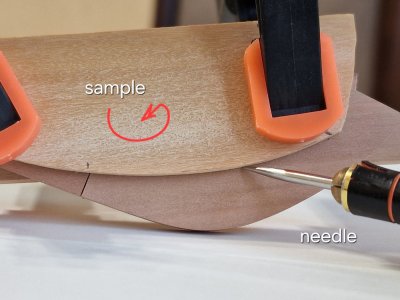

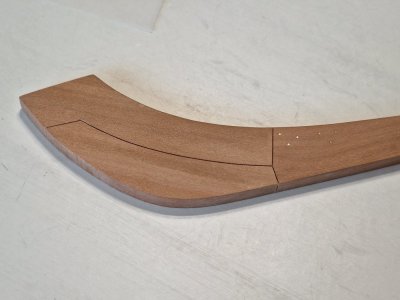

In order not to make a complex connection, I made one part and then scribbled a seam between them through a template.
And here's the result:

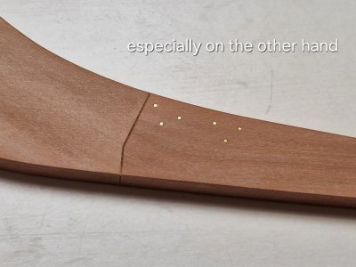

Since there will be a fragile connection along the waterline, I decided to strengthen it with metal nails and glued it to the CA gel.
I remind you that the skin will be made of dark and light pear along the waterline, like the keel.

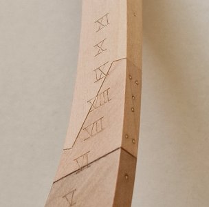

Today is a small anniversary... exactly 100 days of work on this project. Let me remind you, I started it in January of this year.

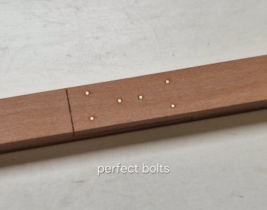

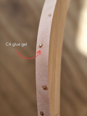

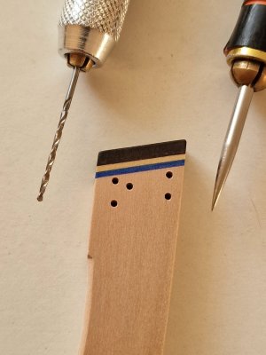

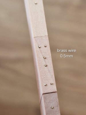

And today I finished the keel for the second hull. And in order: drilled 0.55 mm holes...
... inserted 0.5 mm brass wire from them...
... sealed CA with gel...
... and ground on an angle grinder.
Then he made Latin numbers. I have already described this process earlier with the first keel on the first case. First marked, drew and cut with a scalpel, but straight, as if pressing and not scratching.

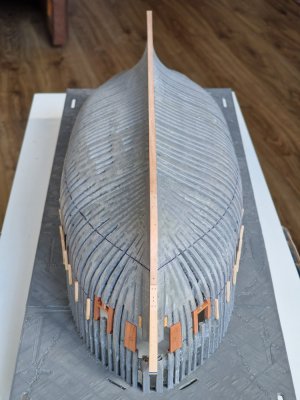

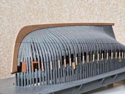

Hurray, finally the work on the keel is over and I fixed it to the hull. You can say laid the keel (although this is not quite how it was done in life))
The keel was glued to the CA gel. I grabbed it at the back and front for a couple of dots. Then he set the parallelism and correctness of the fit 100500 times and then grabbed it at several more points. After solidification, I smeared glue all over the surface on both sides where there was a recess under the board. In appearance - tightly glued. Plus, the reinforcement will be for the light of sticking boards.

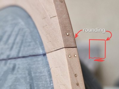

After fixation, he made a small round, maintaining the quadratic shape. Well, I remind you that I made a keel with expansion to the top from 5mm to 6mm.

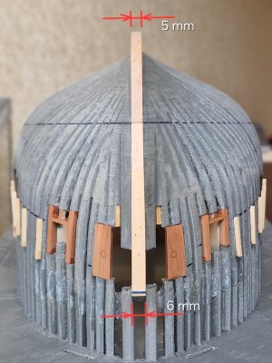

The positioners are almost all in place and now, after fixing the keel, you can sheathe the body with boards.
Already in anticipation of the side plating... I can imagine how it will not be easy to put it mildly.
