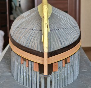

There are not many updates, but not a little work has been done.
I made two castles on the rubbing piece (imitation).
He also prepared a place for the closing part.
It was very difficult to do this with great risk of spoiling an already attached part... but as long as it is not the final resurfacing, it will be when that part (crescent) is ready.
Well, the most important thing is that I glued the second rubbing piece, and naturally trying to do everything symmetrically.
Further work will be carried out under the stern. There will be black hornbeam and pear boards...
... in the meantime, I'm glad everything is perfectly symmetrical. (although from the perspective of the photo it seems that it is not quite :p )

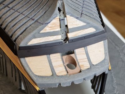

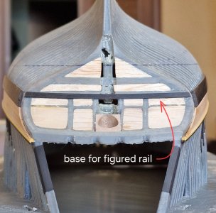

Thank you FRIENDS for your interest in my review and today I have something for you to show.

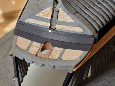

12. Planking under the stern.
Today I got straight high from what was happening. Working with a black hornbeam is one love! And although it is very capricious and very difficult to work with, but the color after grinding is just something unreal!
First of all, I glued the basis for the figured rail. This basis is thinner than the boards that will be nearby and after fixing them in this recess, I will glue the figured slats.

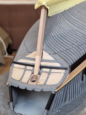

The board-basis has its own bend (it is not even).
Therefore, I glued it whole, and then cut it into a meter for trying on the stern post.

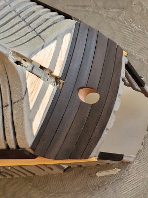

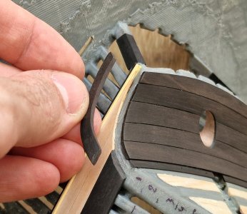

Then I bent the pre-soaked board in hot water with the same iron to give it the right curvature.
First belt.
Second belt.

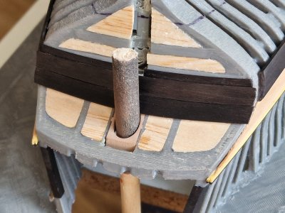

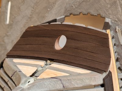

To create the right hole, I used such a homemade device.
Third belt.

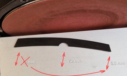

Oh yes, the boards tapered at the ends. From 7.2 mm (in the middle) to 6.5 mm at the edges.
Fourth belt.

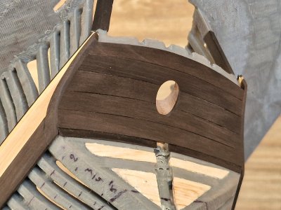

Fifth belt.
Although the drawings from the anatomy show that there are 4 belts, but having calculated this space, I realized that this was most likely a mistake, because then the board should have been 9 mm, which is very doubtful, because below the board is 6 mm.

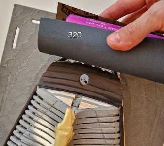

I then sanded the surface with sandpaper (320) wrapped around the cylinder.

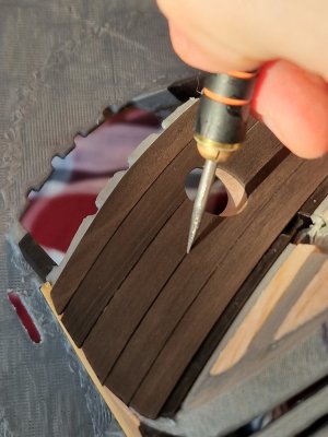

And then he calibrated the gaps between the boards with a needle. I do this in order to better express the joints. Otherwise, with a perfect fit, it will look like one.

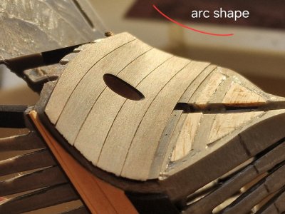

The result is this arched shape...
... which is often not performed, and this spoils the look a little with its angularity.

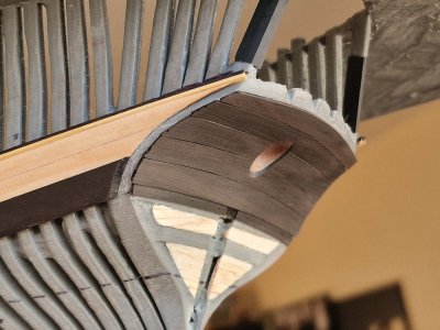

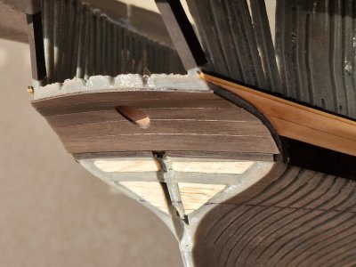

Well, a couple more angles:
What a pity that the model will not be seen from this angle, but only in what is below in the photo.

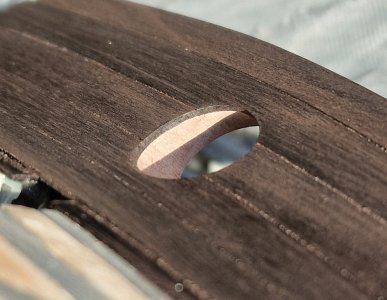

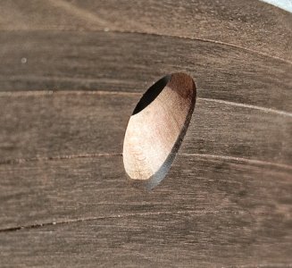

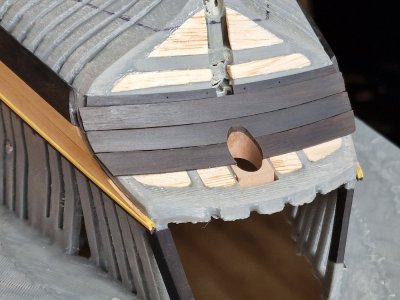

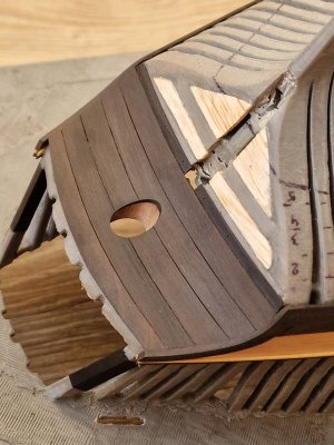

Well, a couple of macro photos of the steering wheel hole.
I specially made an element of a different color inside to highlight the boards well against its background.
I really liked how it turned out...
The edges of the boards have not yet been decorated. They will still need to be rounded correctly and glued there with an arc part that will connect the sides and the rear. Plus, you need to make a slot for the stern... But before that, I think I will make the skin below, from a pear, which will go diagonally.

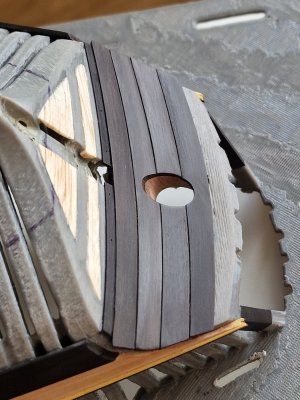

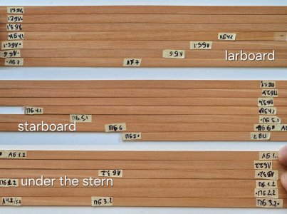

Today is a very small update. Not much work has been done, but its complexity, despite its appearance, is very large. To be honest, I didn't think it would work out that way.

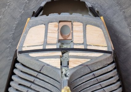

But at the beginning I wanted to show how I assembled a puzzle from boards. For cladding to the waterline, I will use a light pear and at least this area is not large, but the prepared pear was barely enough for it. I previously wrote that due to the wrong cut of the log - the boards turned out to be all striped due to the difference in fiber colors. For several hours I selected the length and order of the boards so as to bypass these stripes and maximize the uniformity of the surface.
To understand how much will go into the trash, but the main thing for me is that all of this is at least enough for the lining to the waterline.
In the photo, I tweaked the saturation to check again the coincidence of shades. Where there are color transition lines - there the boards narrow and these fragments will be cut off, so everything is extremely Western, and there is no room for error at all!!! So I prepared the boards to continue the plating under the stern...

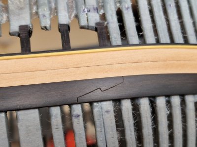

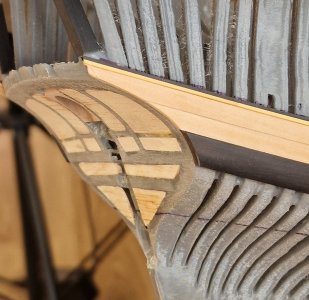

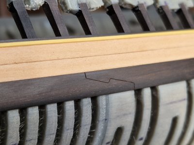

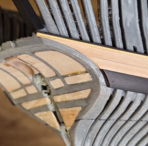

In the meantime, I finished the upper section under the stern, which I mentioned at the beginning.
The hardest part is to make those parts that do not have exact dimensions... And which need to be adjusted in place. I did these two arched details for several hours...

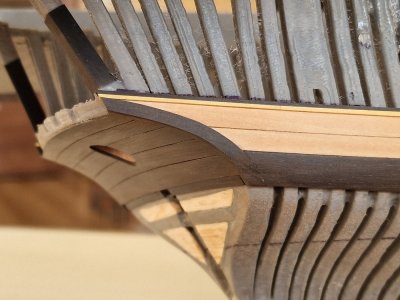

But I was delighted with the result... I was sure that it would not be possible to marry everything like that (sides and stern)... but I got it!

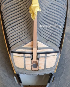

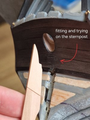

Under the impressions, I decided to fit and try on the sternpost to its place.
I decided not to cut the boards, but, on the contrary, to cut off the excess at the sternpost (by the way, I haven't finished it yet, I still need to form an angle).

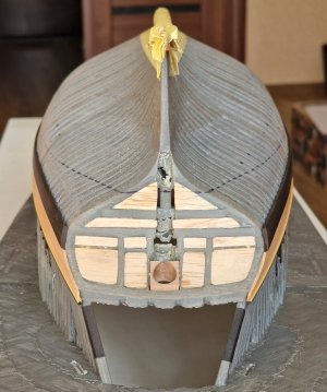

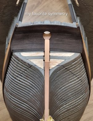

Well, of course, where without symmetry photos ;)
Next in line is the diagonal filling under the stern with a light pear, I can't wait...
