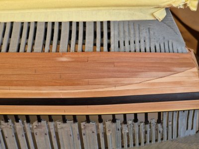

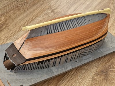

Due to time constraints, did not do much, but! I have completed exactly half of the body skin, that is, 8.5 belts out of 17... And you can exhale, because I completely finished the whole part over the waterline. And now it remains to make 8.5 belts of only one color from a dark pear, which will be more significant faster!
This is what my favorite symmetry looks like)))

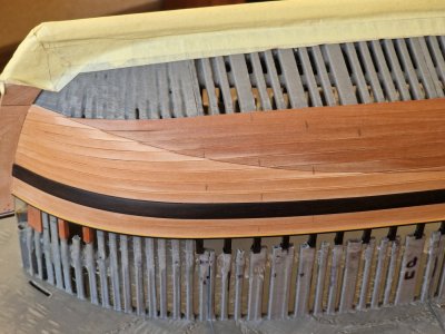

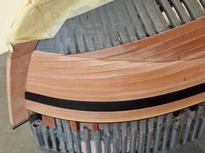

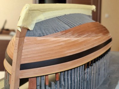

Due to the fact that the skin boards overlap, the waterline runs smoothly at one angle, and at a different angle...
.. due to the position of the boards, the waterline goes with displacements (like on a ladder), which is structurally logical.

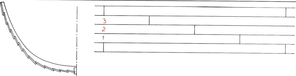

Another point that I wanted to describe was the connections of the boards.
Anatomy shows that the maximum length of the skin boards and deck boards does not exceed 18 cm, which is slightly more than usual, but within the permissible norms. I repelled from this indicator. And he made a layout of connections with an offset step of 2-3 belts (basically 3, which gives a more correct and rigid frame due to the maximally spaced connections from each other).
I will make a reservation: I connected the first and second belts under the wale in specific places due to the shortage of long boards, therefore these connections are adapted to the general scheme. The rest of the belts (in photo 6 from above) were already clearly connected according to the scheme with a shift from steps to 3 boards (that is, 3 boards without connection (solid) are placed above each connection in the zone of double frames) and only the 4th board again goes with the connection. The photo below is visible on the top 6 belts.

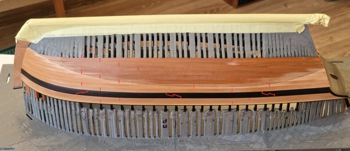

Here is a visual diagram.

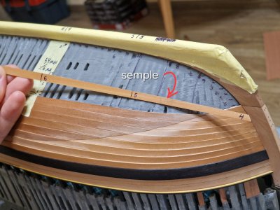

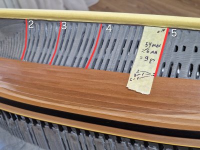

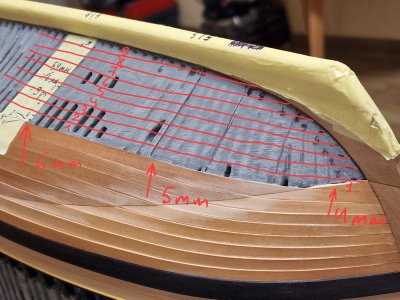

I decided to check and at the same time redo the template. The remaining space for boards is 54 mm. If you divide it by 6mm (the width of the board) it will be 9, and this is the number of belts left to set. From the middle to the stern, the values + are the same.
In the nasal section, the racks from 6 mm narrow to 4 mm.
According to the new template, I will manufacture the remaining 9 belts.
As you can see in the photo above, the belts will go + - according to this scheme, which corresponds to the real position of the boards with this method of fixing them.
Now, it remains to glue them in place... let's go!
I've never seen a waterline depicted in this way, but I have to say it is brilliant! What a truly clever idea alongside impeccable workmanship!
I'm not sure I've seen a better clinker hull... Bravo, my friend!

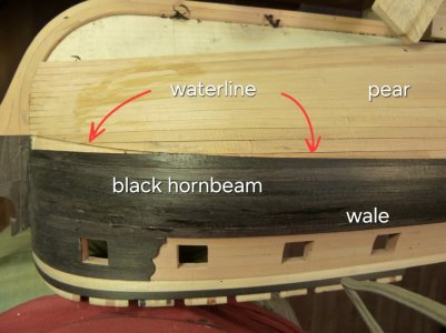

Thank you very much. In the manufacture of French ships, the lining of the hull to the waterline is often made of black hornbeam, and below from pear. But so that from different pears I myself have never seen someone do this. So I decided to try)))

Hello Serikoff, I would like to ask: from what source did you learn that French ships used black hornbeam wood for their planking? Thank you for your response. Frank
I probably wrote it incorrectly. I wrote that modelers who built French ships often used a technique in which black hornbeam was used above the waterline and pearwood below. This was done to convey the color scheme without painting, as French models were typically made in this color scheme: black above the waterline (including the power belt) and pearwood below. This applies strictly to the execution of ship models and does not apply to the materials used on real ships, which typically used oak.
Thank you for your reply. From my documents, it seemed strange to me that they would use that type of wood. Frank

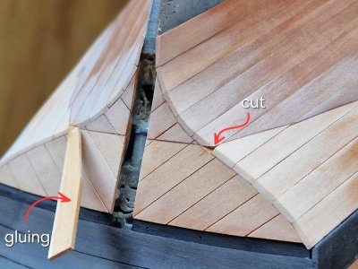

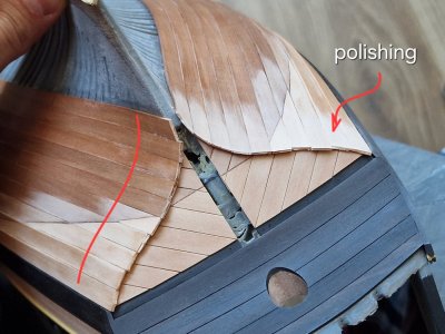

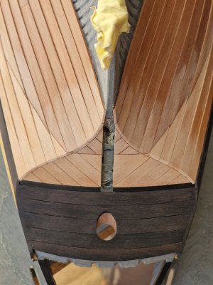

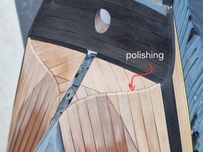

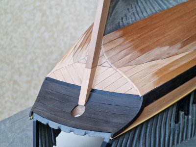

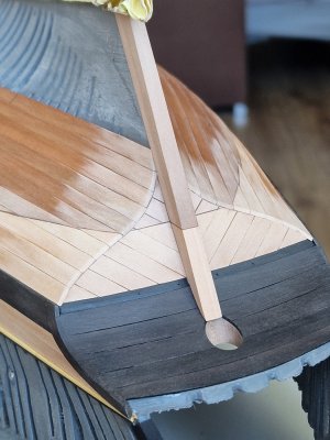

Well, let's continue... Having reached the sternpost, I decided to completely finish with the stern.
First I polished it on the plane...

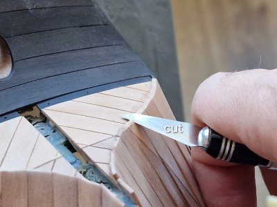

...and then cut off the protruding ends of the boards...
...and polished it along the edge.

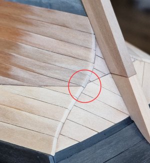

Tried the sternpost...
... and as you can see, there is a break in the waterline.
I used a blade to cut out a piece of dark pear and glued in a light pear.
The result was like this:

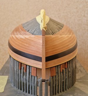

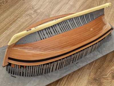

After that, I still managed to glue the 11th trim belt and...
...there are still 6 more strips to go. I think I'll work in pairs for 3 days, and the paneling will be finished. All that's left is a good polishing. I'm really looking forward to working on the top section; I'm a little tired of the monotonous work. Sleep

You made a very nice correction of the break in the waterline, Sergey. It’s all in the details!
Thank you very much. Yes, I'm finally done with the waterline and will soon be approaching the keel, where things are also not so simple.

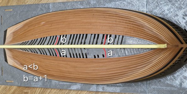

Unfortunately, there is a small problem.
Because the kit, or rather the geometry of the frame built from the kit, isn't perfectly symmetrical, there's a 1mm error in the middle section, requiring me to cut another slat that's 1mm wider than the others. This means I'll have to cut the blank at a different angle to make the board 7mm thick instead of 6mm, and then everything in the middle section will be covered. I don't know why this error occurred, but unfortunately, it now needs to be corrected. That's why I started from top to bottom, so that these inconsistencies would be at the bottom and practically unnoticeable.
I don't think this error will affect the appearance or symmetry front and back. From the side, the extra 1mm will be indistinguishable, and I wouldn't focus on it unless I needed to make the board wider (which isn't very convenient). Also, I was hoping for this error to be eliminated, but that's not always the case.
... these inconsistencies would be at the bottom and practically unnoticeable.
But we will know they are there. :cool:
If you had not pointing that ‘1mm issue’ and you had completed the planking by reducing that 1mm over the latest planks……. I think no one would have noticed it.;)
We will see how it looks ar the end now we know it. :)

I agree, friends, that the problem is only on paper, and in reality it's a trivial matter. But I was so eager to finish the sheathing, and now I'm cutting boards again. But it makes us stronger, even if it takes time. ROTF ROTF :cool:
It is still beautiful work. If you spread that 1mm over the remaining boards, no one will be able to see it. Likely even you, unless you look very close. :)
Your secret is safe with me. :)
Thank you. It won't work to distribute it like that because all the boards are 6mm thick, but it's not really necessary since the tapering is front and back, and everything is symmetrical. The extra millimeter is only in the middle section near the keel, and you're right, no one will notice it.
Smart move! Going back to your post #502 you made this possible. Next time I have a lapstrake hull, I will give your method a good try. Beautiful work all around.
Thank you. Yes, the method works, but you definitely need to check the hull geometry. I checked the horizontal heights and everything was perfect, but the sections along the hull contours weren't quite right. But that's experience, and sometimes it's bitter.
