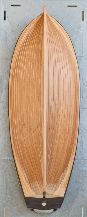

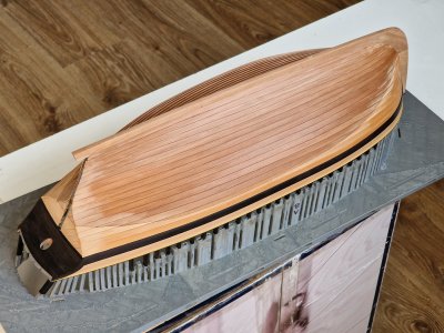

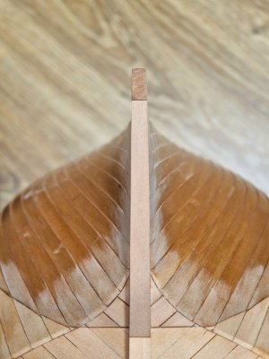

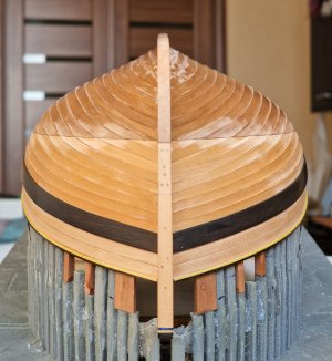

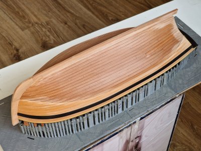

Well, as promised, here are the results... so far only preliminary, but already satisfactory.
And let's start with my favorite: symmetry.
The front part is almost finished, only polishing remains, but there are some issues with the rear...

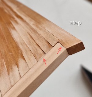

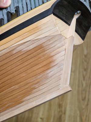

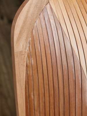

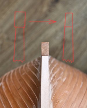

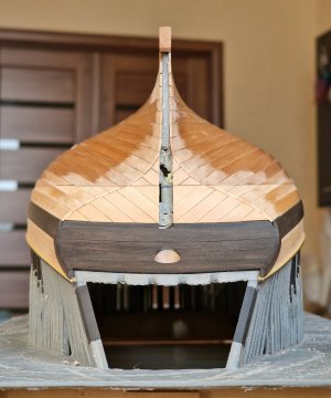

The sternpost tapers downwards, creating steps with the keel and planking.
And we need to create a profile like this:
... done!

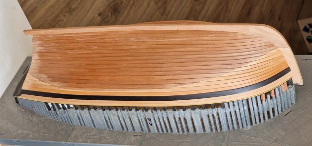

Well, finally, the rear part of the ship is more or less ready.
If you ignore the sanded areas (the light ones), you can already imagine the future appearance after oiling (since the paneling was previously polished and oiled to reveal the grain and color and to ensure uniformity). In the future, I'll polish it all again thoroughly and apply a final coat of tung oil, after nailing, of course.
