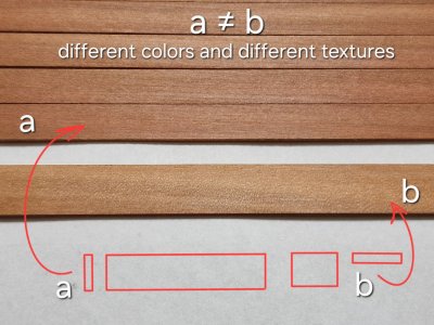

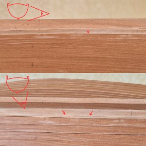

So! As I already mentioned, due to the asymmetry of the hull, an extra 1 mm appeared. And I thought about cutting the new strip from the plank not along the edge, but along the plane... and here's what happened:

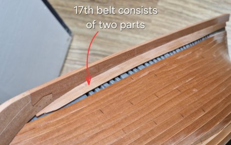

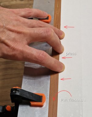

The photo above shows that different cutting angles produce different wood grain patterns and, most importantly, different colors! It might have seemed like the previously coated wood had changed color, but I deliberately cut and coated the new strip the same way, and the color was similar to the previously prepared ones. The cut at a different angle produced differences that I wasn't happy with. So, I decided to glue two strips together with PVA glue, using a minimal glue line, hoping it wouldn't be noticeable.

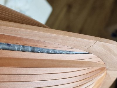

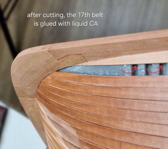

After sanding (it lightened the color a bit) and adjusting the width, I spot-glued it with liquid CA. This is the 17th and final belt, which contacts the keel.
At high magnification, the glue seam is visible, but later we'll see how much camouflage it will provide.

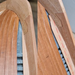

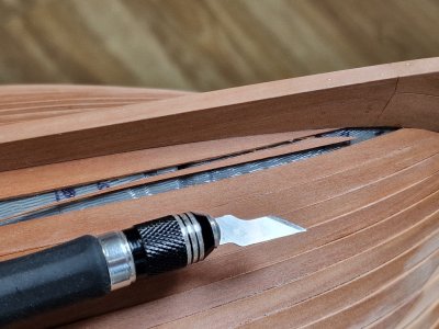

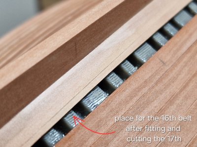

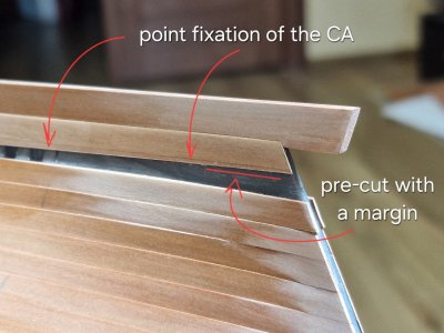

Then I cut and calibrated the 16th (second-to-last) belt and traced the cutting line on the 17th belt using its profile with a blade.
Here you can clearly see:
As a result, I got a clear groove, after which I glued the 17th belt with liquid CA (since before this I glued it spot-on so that the glue would not interfere with the cut.

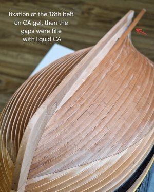

Then I glued the 16th belt into the groove with CA gel and poured liquid CA over the joints.

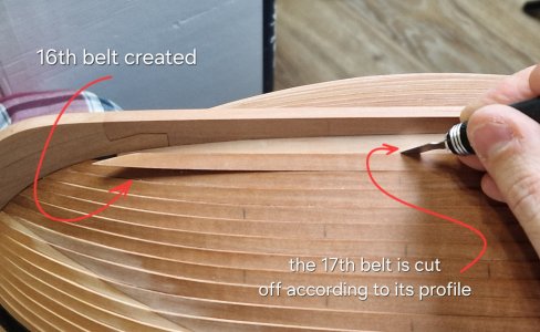

Using the profile of the finished 16th belt, I cut off the excess from the 17th belt with a scalpel...

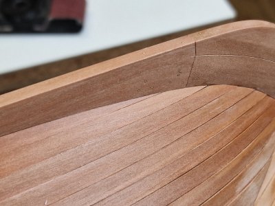

The front part is almost finished, only polishing remains, but there are some issues with the rear...
The sternpost tapers downwards, creating steps with the keel and planking.
And we need to create a profile like this:
... done!
Well, finally, the rear part of the ship is more or less ready.

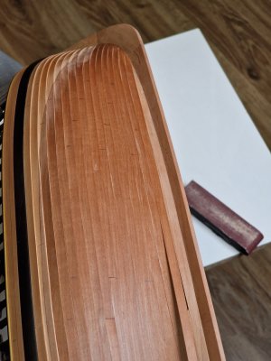

If you ignore the sanded areas (the light ones), you can already imagine the future appearance after oiling (since the paneling was previously polished and oiled to reveal the grain and color and to ensure uniformity). In the future, I'll polish it all again thoroughly and apply a final coat of tung oil, after nailing, of course.
