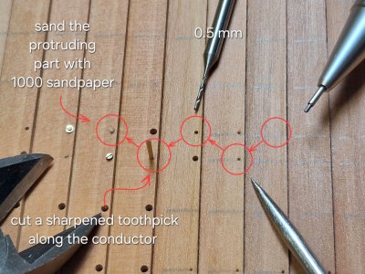

Nailing is easy here:
1 - Mark, 2 - Prick with a needle (along the distance guide from the edge of the board), 3 - Drill with a 5mm drill, 4 - Trim the inserted sharpened toothpick (naturally, along the length guide), 5 - Lightly round off the remaining protruding end with 1000-grit sandpaper so that the rounded edge protrudes from the surface.

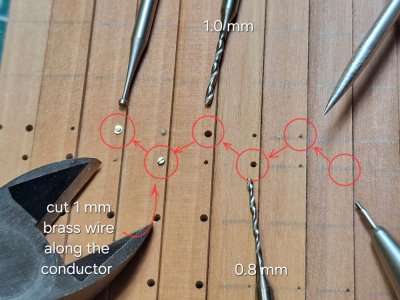

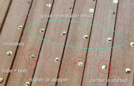

But the bolts will require some fiddling...
1 - same pencil markings, 2 - prick, 3 - then drill with a 0.8 mm drill to the desired depth, 4 - drill with a 1 mm drill to the thickness of the board (I'll explain why below), 5 - then trim the inserted millimeter wire (all according to the template, so that all protruding edges are the same length and needed for the next step), 6 - shape the wire into a bolt with a special cup drill (I also mentioned this earlier).
So, here's the result and the obvious mistakes:
You can achieve a consistent shape, but you should avoid the following mistakes:
The center may shift laterally if the tool is positioned incorrectly during operation. It's best to place the drill cup on the wire and run the micromotor at low speed. This way, you can monitor the shift and prevent the center from shifting.
Plunging too deep, or not deep enough, is also unsightly. Or the distance from the edge of the board is not the same.
But the worst thing is when the hole is larger than the wire, as this will leave a stain when bitumen gets into the hole. I initially drilled with a 1 mm drill bit, but even at low speeds, the slightest movement of the hand and the sharp drill bit widened the hole. To prevent this, I first drill with a 0.8 mm drill bit and then, using a quick, shallow drill bit, duplicate the hole with a 1 mm drill bit. This way, the hole is the right size and the wire doesn't wobble in it.
Yes, in theory, you could find a 0.9mm drill bit and then try inserting the wire, but I tested it—the only repeatable option is: 0.8mm, then 1mm to a shallow depth with a quick motion.
Although I'll tell you a secret, from a distance, nothing is noticeable, and any defects are simply invisible... My wife teases me, "Who's going to see anything there except you?"... but in a macro photo, it's visible... so I'll do it beautifully. ROTF ROTF

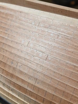

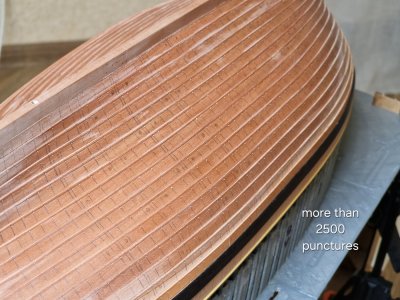

Today I gave the ship physiotherapy treatments... or more accurately, acupuncture... 2,500 times. Redface

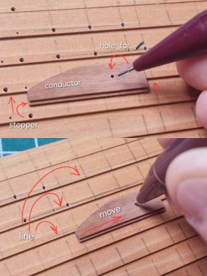

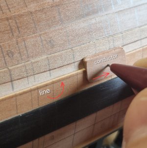

But first, I did at least a quarter of it on a test piece. I made a template for it to create an intersection line for positioning the holes. The principle is simple: a pencil hole and a stop at the desired distance.
All holes were made according to the option described in the previous post.

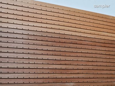

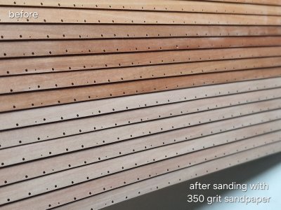

After that, I sanded the surface with 350-grit sandpaper. As a reminder, before securing the boards, I coated them with tung oil to bring out the grain and ensure the correct color match. Now, all of this needs to be removed and, after securing the bolts, re-oiled.

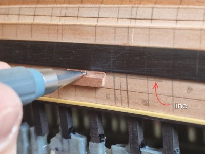

After checking everything, I got to work on the ship. I made a jig for it and drew lines.
A similar jig was made for the top boards above the wave.

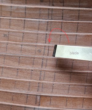

But so far I've only made punctures on the clinker cladding. As I already mentioned, I've made over 2,500 punctures.
And with a straight blade I made the joints of the boards (or rather their imitation).
Since the boards were not butted but overlapped, we can only see the outer transition from board to board.
Next I have to drill 100,500 holes. :eek: Save me ROTF

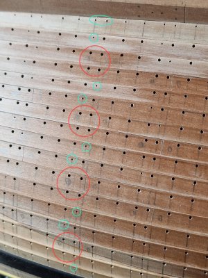

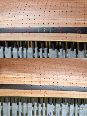

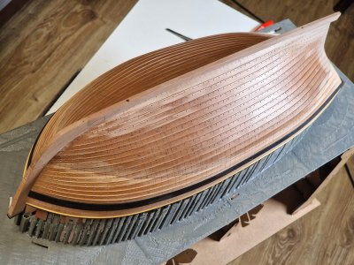

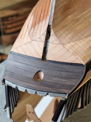

In two days I completely finished one side:
Now I'll tell you step by step where the bolts will be and where the nails will be.
The top is Carvel planking with 0.5mm holes for nails. The holes where the boards meet are slightly closer together (not centered on the frame, as usual).
The wave planks have 0.6mm holes (I drilled them twice to slightly widen the holes from the 0.5mm drill bit). The bolt holes are 1mm, but I first drilled 0.8mm ones.

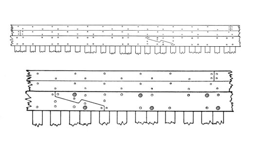

Clinker planking according to the scheme that I have shown many times.
All bolt holes are 1 mm (but I initially drilled 0.8 mm holes).
The lower chord near the keel is secured with nails (0.5 mm holes). The next chord covers it, and they are both connected and bolted to the frames.
The planks are secured to the paired frames in a staggered pattern, alternating nails and bolts (turquoise circle).
But where the planks join, all four are bolts (1 mm) (red circle).

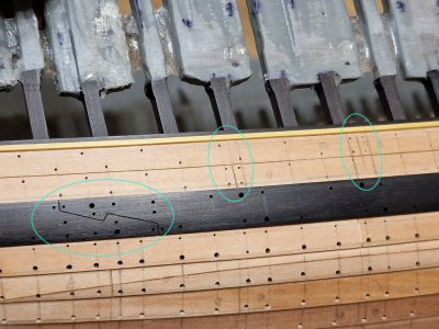

At the stern, everything is simple - 0.5 mm nails are used everywhere.

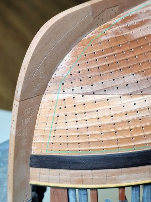

At the bow, the edges of the boards are secured with 0.5 mm nails, but another row of 0.5 mm holes is also drilled for nails, as this is where the sheathing overlaps and butts.
The top chord under the wave is also secured with nails.
The same is true for the upper and lower chords at the rear.
All intermediate boards, reaching the sternpost, are also transitioned from overlapping to butt-jointed and also secured with nails.

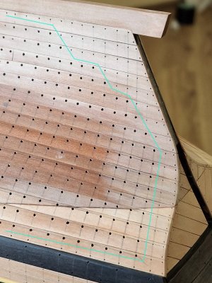

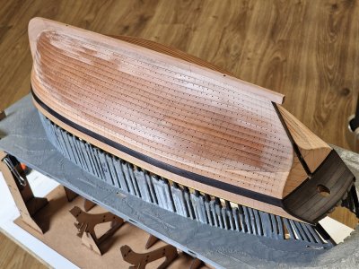

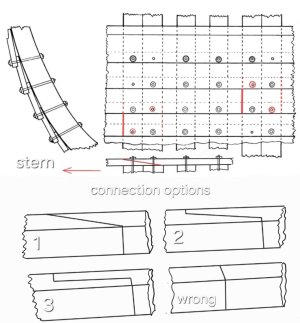

The wave section is a bit more interesting. The anatomy diagram shows the bolts running along paired webs, but it doesn't indicate the areas where there aren't paired frames.
Let's just say (even though the anatomy is full of errors and omissions), even without this, there should be logic everywhere. And it's physically impossible for there to be no bolts in the fore and aft sections. Practically speaking, two of the four wave sections were held together solely by nails, which is highly unlikely!
Therefore, I added bolts at similar intervals both fore and aft, and in the middle frame, where the span is greater than anywhere else (not two, but five separate frames).
This is not only logical, but will definitely look better, as the brass will shine slightly and it will seem as if something is missing.

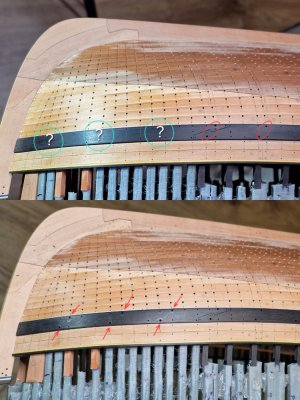

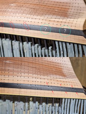

Naturally, unfortunately, there were some defects ((( Several extra holes, also several holes of a larger diameter than necessary and several damages near the hole... And it's hard to avoid when you drill more than 2000 holes (many had to be done in 2 approaches from a smaller to a larger diameter). I'll tell you the most interesting ones in words, and then I'll show the result after bitumen... So, to mask an extra hole or remove damage, I covered the holes with putty in the same color. While I had brown, I still need to buy a light one. And after sanding and coating with oil, of course, it is unrealistic to completely mask it, but the bitumen will not get there and will not paint the defect, which is much more noticeable than a small difference in color. But it's good that such defects are few and far between. But there are about a dozen more holes than necessary, and after covering with putty and after sanding, I made holes of a smaller diameter in the putty (I even installed nails on the test, and oiled (I covered it), then in this case it's practically impossible to see that anything is wrong... and that's good. Although it's still a shame that everything can't be done perfectly... eh.

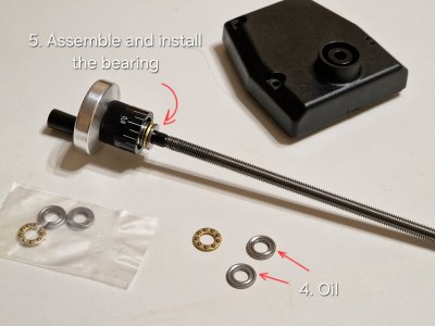

To do this, I needed to upgrade the Proxxon MF 70, which I did today (waiting for a shipment of bearings).
I also created a new thread where I'll explain everything I'll be doing with the milling machine. In the second post, I've posted step-by-step instructions on how to install the bearings; maybe someone will find it useful.
