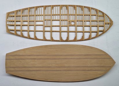

Everything is ready for gluing. I glued it with TiteBond II...
Then I glued on the temporary waterway, or rather, the second part of it. I applied it to the CA gel in dots so that I could remove it later.
After that, I sanded the surface first with 120-grit sandpaper, then with 150-grit. The mark was the absence of areas that had been coated with oil.
Then I widened the seams with a blade and after that I sanded with 240 and 320 grit sandpaper.
Recommendation! Do not use a needle to widen (calibrate) joints! Due to the varying density of wood, the needle may deform it differently, and the gap may be uneven (of varying thickness) and not perfectly straight. I also do not recommend using the sharp edge of a blade! If the sharp edge hits the glue or tightly fitted slats, the blade may slip from the gap and scratch the board. I recommend using the thinnest blade (as in the photo) but with the back of the blade. The principle is to use light, gradual movements along the joint, so that the blade follows the seam. As you go deeper, the sharp edges of the back of the blade will scrape out a smooth gap instead of squeezing the wood. The key is to do this carefully and very gradually, trying to scratch everything in one or two passes. The first passes should be made at a 45-degree angle, and the last ones at almost 90 degrees. This will ensure uniform blade penetration and calibrate the gaps to the desired thickness.
This is still an intermediate result. The long gaps between the boards are almost 100% ready, but I will still calibrate the gap along the waterway border in a slightly different way, I will tell you about this a little later.
A few words about why I do it this way:
1 - Seam calibration is a much simpler and faster method than precisely matching all the boards without gaps.
2 - When humidity changes, the wood has room to expand and the deck will not bulge. (This is precisely why this procedure was performed – sealing the seams with resin and horsehair.)
3 - There are no unnecessary steps when using various spacers to simulate caulking (resin seams), which complicates and slows down the process.
4 - Using bitumen in this method best simulates resin seams.
But again, this is just my opinion.

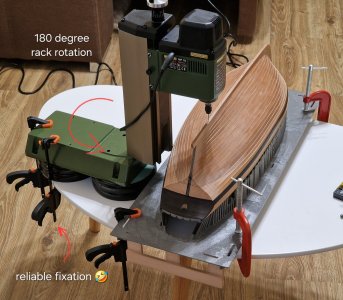

In addition to the ship case, I also designed and ordered a workbench and protective box for the Proxxon MF70.
This is essentially a table with a pull-out drawer for various consumables: milling cutters, burrs, vises, etc.
There will be a reinforcing plate above the drawer. The machine will be secured to it, and a protective box will be held around it.

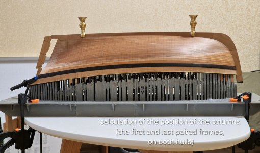

First, I calculated the position of the columns (the first and last paired frames).

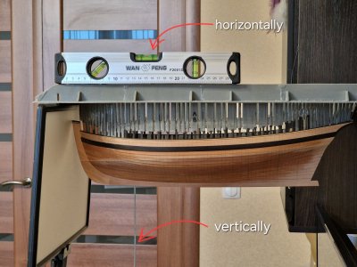

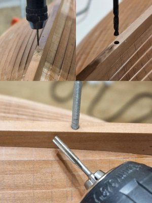

Then I turned the base under the router stand 180 degrees and screwed it in with 2 screws (the mounting surface allows everything to hold in place anyway).
I had to place dumbbell weights under the machine and clamp everything down as tightly as possible.

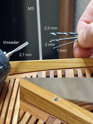

We drilled gradually to prevent the wood shavings from clogging the drill bits. First, 1 mm, then 2 mm, and finally 2.5 mm. Then, I used a screwdriver to cut the threads with a thread cutter. After that, an M3 stud (like a meter-long headless bolt) screwed neatly into the hole.

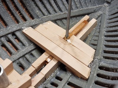

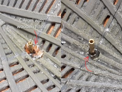

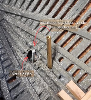

I drilled the hole as described earlier, tapped the threads, and then screwed the stud in.
Then I installed the case horizontally so that the stud could hang completely free from the bottom.
And inside the hull, I screwed a brass cylinder with a thread (like a long nut) onto a stud.
This way, I was sure everything was perfectly vertical. Then I filled the pre-drilled hole in the plastic with SA gel. This firmly secured the bottom of the insert.

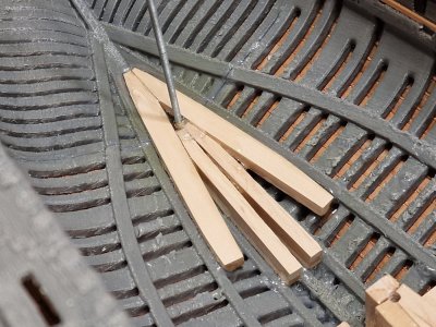

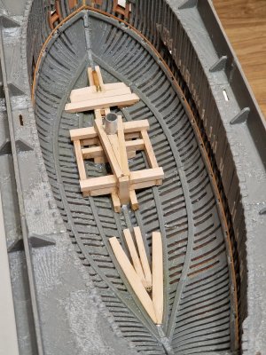

I reinforced the upper part of the mortgage with wooden structures, which were fixed to the hull with СА gel.
The safety margin is more than sufficient. All these reinforcing structures will be covered with small boxes painted matte black. This way, nothing will be visible through the gratings and hatches.

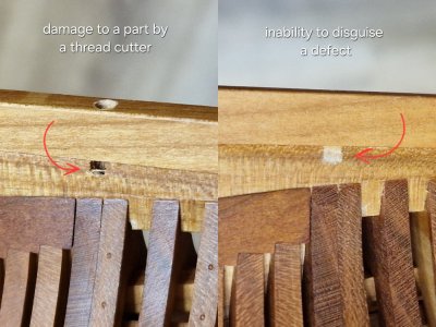

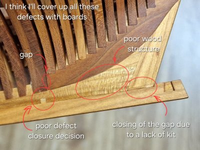

But with the first hull, what I feared happened. The carver made a defect in the keelson. There was plenty of room for the wood, but cherry is fragile (unlike pear), and it didn't hold up. :eek:
My attempts to disguise this area were predictably unsuccessful. The oil coating naturally revealed the joints even more...
... I was a bit disappointed, of course, but I came to a completely logical conclusion... there were so many things about this area that I wasn't happy with from the start.

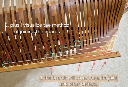

Firstly, there was a gap, unnecessary joints, and I had to cover up the area the manufacturer had done incorrectly... and secondly, I absolutely didn't like the entire keelson detail, or rather the grain of the wood.
So that's what I decided to do. I thought I wouldn't show the planking on this hull, but! Circumstances forced me to, and I realized it wasn't a bad idea.

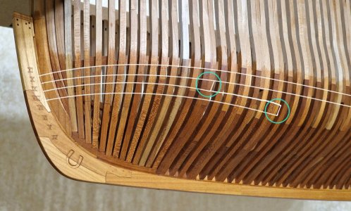

I'll partially finish the lower four planking chords (it's good that the joints are close together near the stern). I'll also demonstrate the principle of joining the clinker planking. This will be interesting, since it's hard to see on the second model due to the full planking. Plus, this will not only conceal all the imperfections and the grain of the keelson wood, but also almost completely hide another detail (under the aft frames, in the shape of a crescent), which was implemented differently in the original drawings. In fact, it wasn't there at all. So I think this solution has only advantages.
And in the front, instead of one top chord, I'll make two more. And I'll show you where the boards connect, but from the other side of the connection.

...two decks are almost finished (everything inside the hulls is also ready), and next I plan to make the grilles... but the bearings for the Z-axis need to finally arrive.
I'm currently selecting materials and thinking about the color scheme... it's difficult, especially when you have more than eight shades of pear.
I think your idea for the limited planking is a wonderful idea !
I'm amazed you are able to get such clean holes from a regular twist drill !
Brad Point drill bits will give you a much cleaner hole. :) You might look into some.
