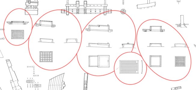

This post is for those who are interested and interested in learning...
Today I worked mostly in Blender. For those unfamiliar, it's a 3D modeling program.
I'd like to share a little advice.
Before marking out the deck, let alone nailing and cutting holes, be sure to calculate everything! This will avoid problems later when something doesn't line up or overlaps.
How I do it:
1. First, you need to build the deck and sand it.
2. Then you need to calculate the positions and sizes of the deck elements, nail lines, board joints (I try not to make these, but rather glue solid boards along the entire length of the deck), and especially the hatches.
3. Most importantly, you need to calculate the number of longitudinal and transverse lattice pieces and avoid making mistakes. This is because the outer dimensions of the lattice frame depend on this. It's very important to take this into account.
4. First, make the lattice and then build the frame around it. Don't just build the frame and then try to fit the lattice into it. A ±1 mm deviation in size won't be noticeable if you see the frame is slightly larger after gluing the lattice, but reducing the lattice to fit the frame will definitely be noticeable due to asymmetry or thin edges.
5. Then, using the completed frame (with lattice), mark the deck. Even if you notice you've gone slightly beyond the desired boundary (say, a beam), it's not a problem; you can shift the nailing line so the nails are at the correct distance from the frame. It's worse when the nails are already in place and the frame is either far away from them, close to them, or even overlapping the nails. The same applies to other elements on the deck, especially the joints between the boards. If you need to shift the nail line, you can also shift the board joints. However, if they already exist (joints), shifting the nail line will result in artifacts and overlapping or misalignments. Again, shifting the entire nail line and joints won't be noticed unless you visualize the beams underneath the board, but nailing that doesn't follow a single, straight line or joints that don't hit the nails will be noticeable.
6. Then, using this marking, nail and sand everything evenly, and only then cut the holes for the gratings.
7. After that, I'll install the deck and glue the waterwall. Even after that, I won't glue the deck pieces (grilles, pins, winch, anchor mechanism) in place, as I'll be working on the ship and, to avoid damaging anything, I'll do the fixing last. It's better to make everything disassemblable and always be able to try on any given part, but still be able to remove it.
I'll be showing my lattice calculations soon; there's a lot to show! It'll be interesting!
