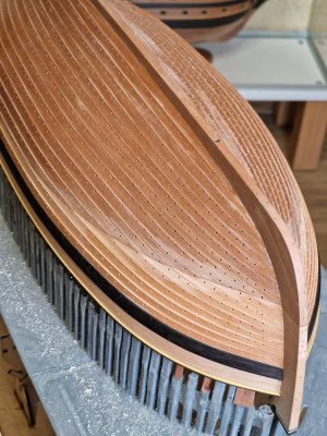

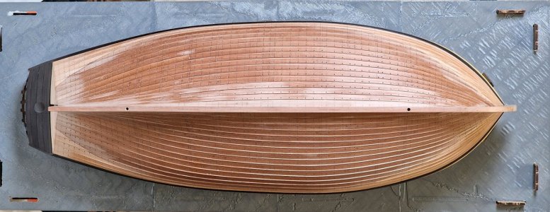

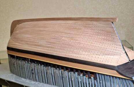

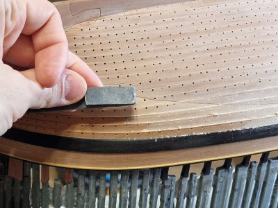

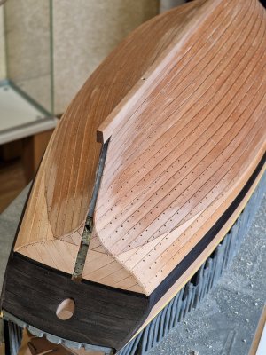

Hooray! I'm done drilling, and by my count, there are 3,222 holes in total. Considering that 3/4 of the holes were drilled in two passes, that means there were at least 5,500 such drillings.
No pencil lines.
The meditation is complete ROTF , and now it's time to polish everything and get back to work.

Right now I'm sanding the hull individually with a fine-grained sandpaper... a never-ending task, but very calming.

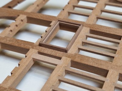

I'm waiting for a vise for the milling machine, so I can't start working on it. I've already installed the bearings, but it's difficult without a good vise. I think I'll have to make jigs; I can't wait that long...
In the meantime, I've decided to make a rear grating, or rather its frame, for the first hull, which won't have the grating itself.

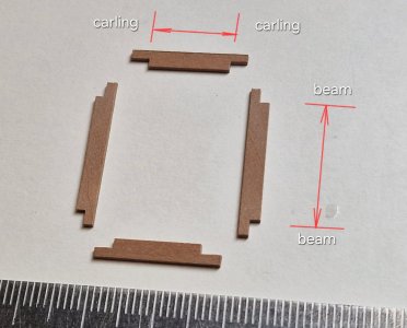

Having calculated the distance between the beams and the carlings, I cut out a groove for the connection.
I assembled and glued it with liquid CA. I cleaned the inside corners of the board with a scalpel to remove any glue. This is important!

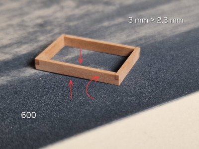

Then I sanded the surfaces to a thickness of 3 mm on both sides so that the joint remained in the center.
Afterwards, I sanded down the protruding edges with a machine.
Then I reduced the thickness to 2.3 mm, and with this the joint still remains in the center.

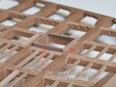

I didn't profile the deck because it's completely invisible at this size. And since this grating was walked on while steering, I doubt it was curved (it would be practically straight or have a very slight curve, and this particular one).

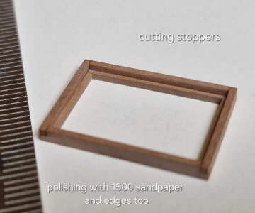

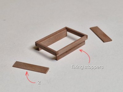

Then I glued the stoppers for the grating, first the side ones and after cutting them off, the front and back ones.

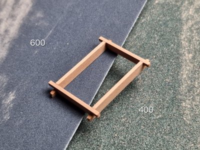

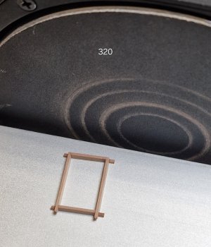

After cutting off the excess stoppers and sanding the bottom surface, I sanded the entire frame with 1500 grit sandpaper, lightly smoothing the corners and edges.

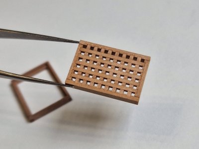

Although this is the simplest of all the gratings and frames, it is also the smallest, so it is not so simple.
I haven't drilled the holes to simulate the mounting bolts yet; I need to figure out how and what works best, but overall, the first part is ready. As a reminder, the hull "skeleton" will only contain the frames for the gratings, but there will be no gratings. This was done to avoid blocking the lower deck and to clearly show the structure of the frames beneath the gratings.

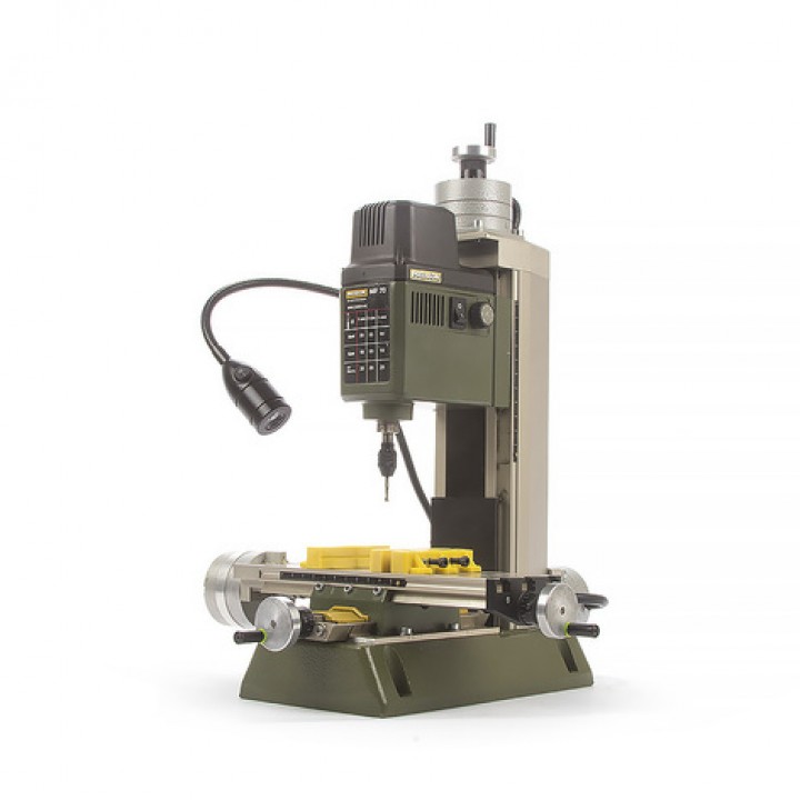

So far, I've been making most of elements using Kudin method, on reinforced double-sided tape. It's quality, but you also lose a lot, a lot of good finish material when peeling it off.

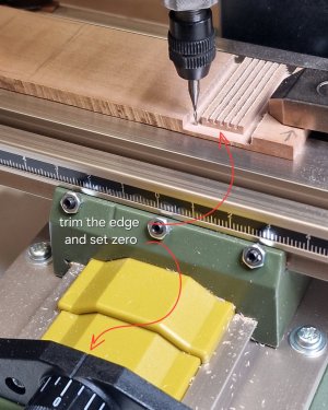

The frame for the first hull is ready; now it's time to make the grating and frame for the second hull.
All work was done on a Proxxon MF 70 milling machine.
I filmed a short tutorial; I hope someone finds it useful.

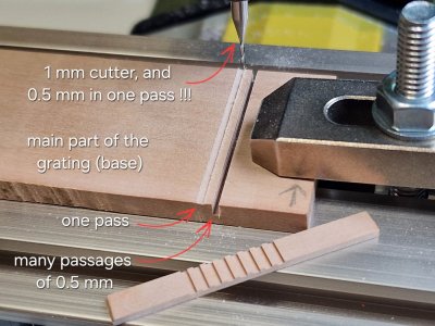

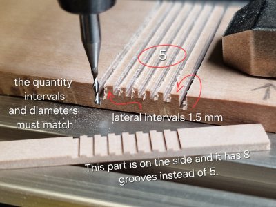

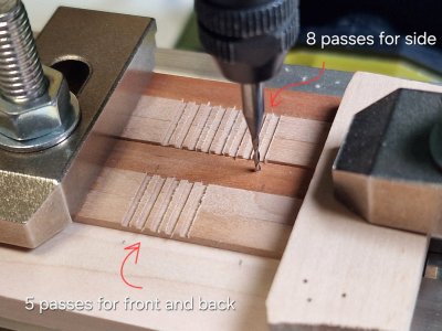

Since the grating is not simple and has complex side sections, we need to start with those.

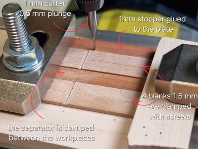

I secured both pairs of these pieces against the glued-on strip, and placed another strip between the pairs to separate one pair from the other.
A 1 mm router bit is the width of the strip and the width of the gap between them.

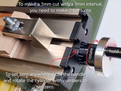

For beginners, it's important to set the zero. This will allow you to make two full turns to move the dial by 1 mm. Without setting the zero, it will be difficult to maintain consistent movement. To set the zero anywhere, hold the handle and rotate the black cylinder with the numbers to zero.

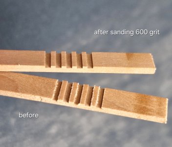

For my grating, I needed to make 5 and 8 passes.
Then sand the lint off with 600-grit sandpaper.
Passes in the main part (base) must be made gradually (preferably 0.5 mm per pass to avoid breaking the cutter).

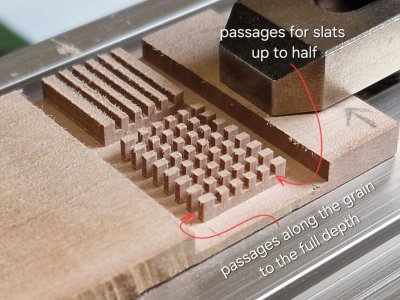

To create a complex grating, you need to understand the principle of the sequence of work.

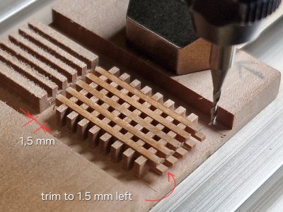

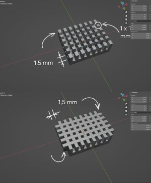

The idea is to leave 1.5 mm strips along the edges so that 0.5 mm of them fit into the side pieces. This needs to be taken into account when milling the grooves.
This is one of the most important points. I recommend studying all the material before your first attempts.

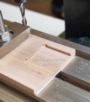

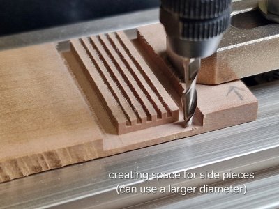

For future fixing of the side parts, I made free space around the perimeter.

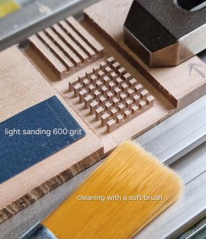

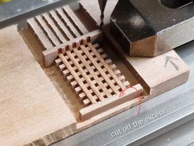

Before milling perpendicularly, you need to fix the zero again by running the milling cutter along the edge.

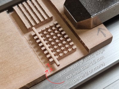

I first go across the grain halfway for the longitudinal slats, and then along the grain the entire depth. And again, at 0.5 mm per pass, so that not a single tooth breaks off.
At the end, you can carefully remove lint and dust.

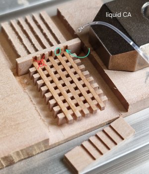

After this, you can glue the slats, leaving more than 2 mm at the edges.

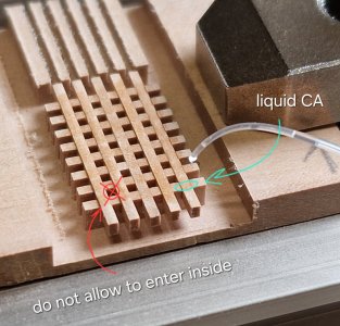

I use very thin CA, not PVA. I like that it penetrates by capillary action and bonds parts that are already firmly in place. It also creates a thin, fine line of glue to visualize the joint.
But be sure to apply the glue only to joints and areas that will be sanded, and avoid surfaces that can't be cleaned.

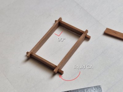

Then I cut the ends of the glued slats so that 1.5 mm remained.

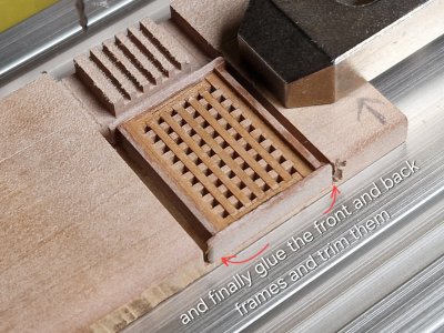

And I glued the front and back parts to these edges with liquid CA at the joints.

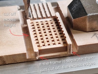

I cut off the excess height.

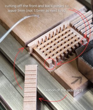

Before fixing the side pieces, you need to pre-cut the edges of the front and back so that 1 mm remains (but later I noticed that you need to leave 1.1 mm).

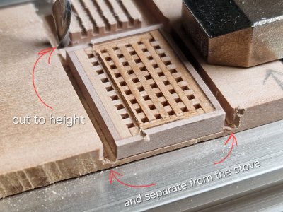

Afterwards, you need to trim off the excess material from the top and sides to level it.
This completes the grille (I'll show the result in Part 3).
But this particular grille has a thin frame and can be installed right away.

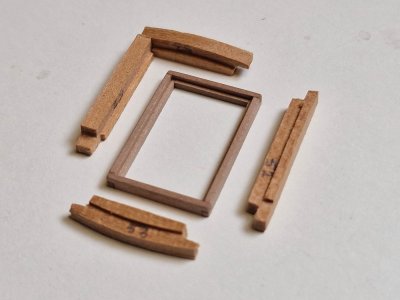

First, I glued the side frame pieces...
cut to length...
and glued the front and back parts of the frame and cut them to length.

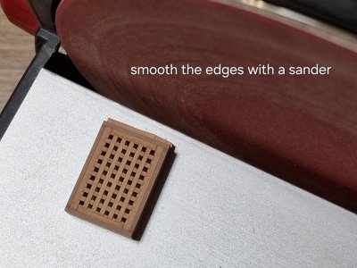

Finally, I smoothed the top surface with a face mill and separated it from the base...
... sanded the edges with a sander.

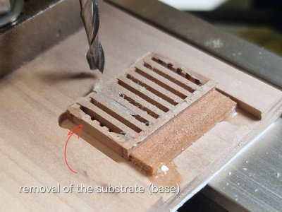

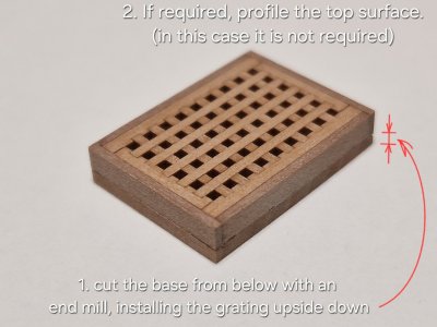

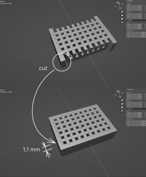

Finally, you need to cut off the base (the lower surface) and profile the upper surface if necessary. In this particular case, the grating is almost flat.
Continued in the next post.

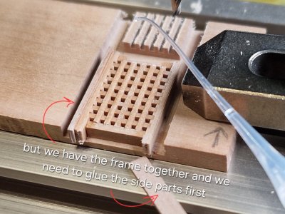

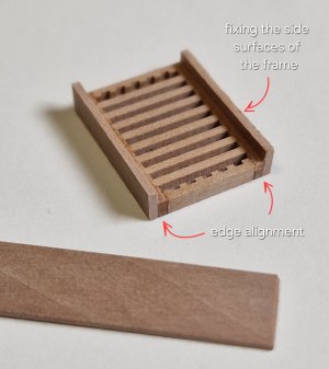

Rear Grating.
3/3

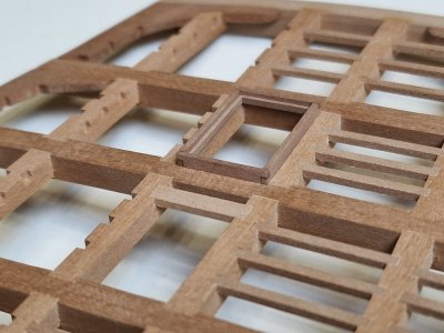

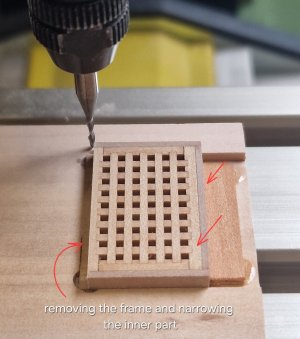

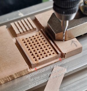

But during the manufacturing process, I realized the grating was a bit wide, so I decided to cut the frame and trim some of the side pieces. I'll show you a few more things while I'm at it.
I initially cut a groove to fit the grating into.
I installed a grating there, glued the side stopper with CA gel and cut off the side part of the frame and part of the side piece.
After that, the grating fit the frame perfectly (for the first case).

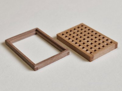

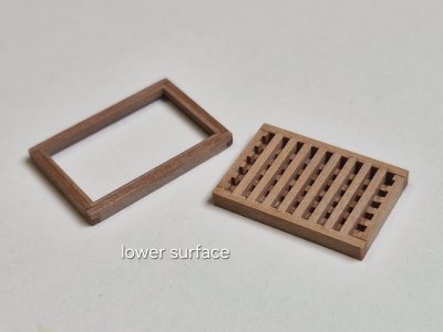

Then I turned the grating over, secured it and cut off the bottom plane (base) so that the grating became see-through.
After sanding with a flat surface and 600-grit sandpaper, here's the final result.
From the bottom:
... and from above, together with the frame (it’s from the first hull):

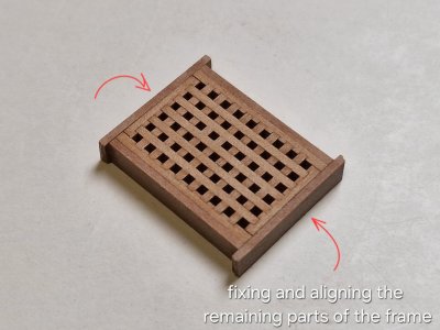

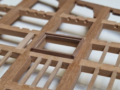

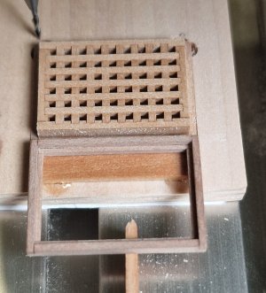

As you know, I am building two hull s in parallel, and in the photo above, the frame is for the first hull, and the lattice is for the second, and now I need to make a frame for this grating.

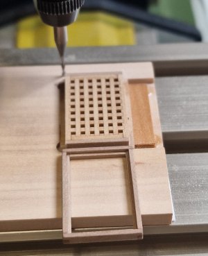

Since the grating and frame on the second hull will be one piece, you need to glue the side parts of the frame first, cut them flush, and then glue the other two and also cut them flush.
Finally, lightly round off the edges and corners with 1500-grit sandpaper (very lightly).

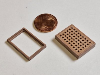

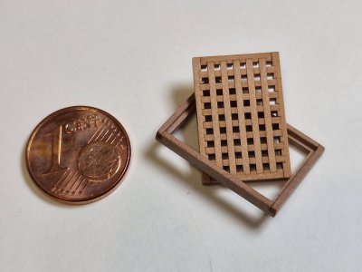

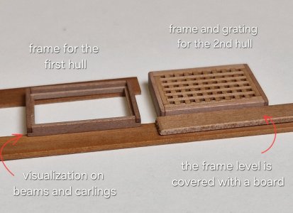

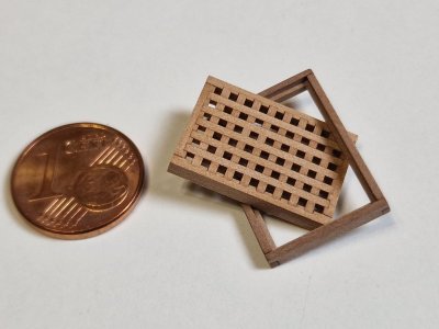

This resulted in two sets:
On the left is the frame for the first skeleton hull and on the right is the frame with a lattice for the second hull.
The photo above visually shows which part of the grating will be visible and on which hull. The idea is to show two options...
...and these two options are completely finished, hooray.
